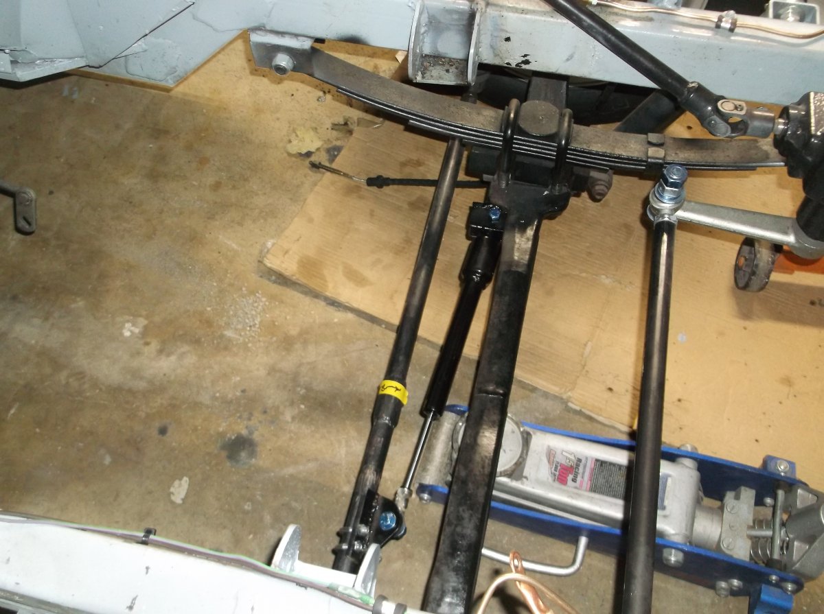

  9. southcross2631
    Joined: Jan 20, 2013
    Posts: 4,412
    southcross2631
    I run trailer springs on the front of my Morris Minor straight axle setup. I bought them and the mounting hardware from my local DSCF3575.JPG DSCF3572.JPG NAPA down in Florida . They had everything in stock. Different spring rates.

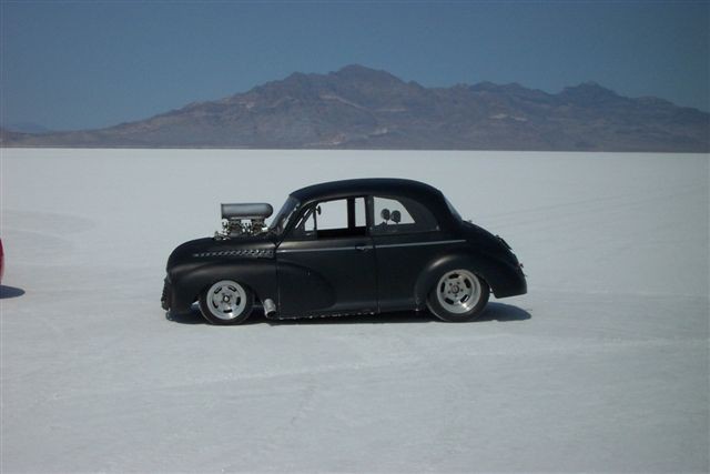

  15. Rocky
    Posts: 17,647
    Rocky
    Classified Editor
    My brother used trailer leaf springs on the back of his Morris Minor hot rod. I think they were 27" long. Rode hard as hell but controlled the torque of a 406 SBC running 10.30s at the track. Scotty's morris on 6th street..JPG
    AHotRod, catdad49 and mcsfabrication like this.
