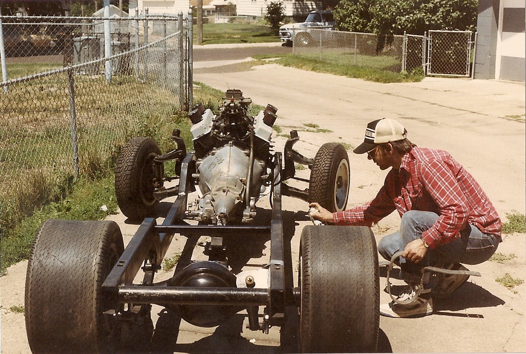

    Mike:
    I use trailer springs under the rear of my Model A Coupe now for 30 years. Mine are the 1-3/4" wide, lightest 2 spring unit you can find on the net for like $18.00 each. I only use the main leaf on my car.
    Here is where I bought mine: https://www.easternmarine.com/double-eye-trailer-leaf-spring-una-144
    I built custom ladder bars so I mount the spring with shackles on both ends of the spring which makes it a floater so you have no binding at all. I have made 4 sets of different length eye-to-eye shackles to adjust ride height.
    Works like a charm for me, my Coupe weighs in at 2010#, and I have never wore out the nylon bushings and I have put a total of 70,000 miles on this design over 30 years.

  16. AHotRod
    Joined: Jul 27, 2001
    Posts: 12,487
    AHotRod
    Rocky ole-pal .... a ladder bar car must have the axle 'float' and this is a poor-mans floater. The shackles keep the rear end side-to-side movement from happening as does a watts link does. The shackles on both ends allow the suspension to articulate with no bind, as the ladder bars are anchored to the ch***is and housing.
    I named it my: "semi-elliptical floating 2-link" ... rear suspension.
    These are the things that one can do when not building a car out of a magazine or parts catalog. I dreamed this up over 40 years ago and built several on them.
    Remember, your brother Scotty saw my Coupe with this suspension at the Good guys in Des Moines Iowa in 1993 and flipped out on how simple it was, as then went home and built his Morris Minor with it.

    A key component to this rear suspension is 'shock location' WITH adjustability .
    When fabricating, I set it up with my different ride-height set-ups, and fabricate upper shock mounts that allow the shock to sit from straight-up 90-degrees (vertical ) to 80- degress to 70 - degrees, and also make them at 2 different height-holes so when you raise or lower the suspension, I can keep the shock travel where it should be.
    One thing I want to point out regarding shocks: On my latest version of my Coupe (in avatar) I used Monroe Corvette Gas Charged Shocks for the first time, and as of right now, I'm on the fence on going back to the Monroe old-style oil filled style. In my opinion, the gas charged style is to "harsh" for this light-weight of a car. The oil filled units rode much better.
    You can see the upper shock mounts in this picture.

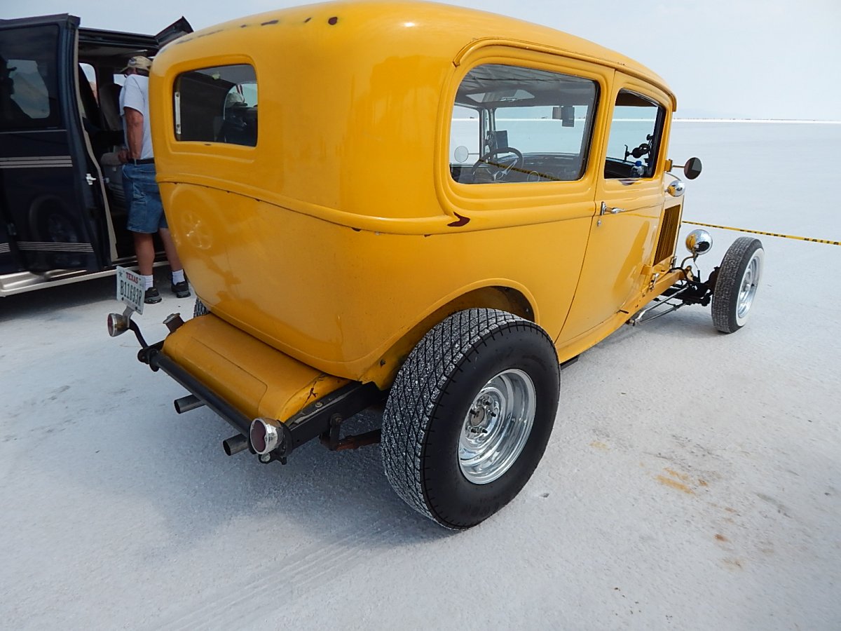

    I saw this really cool '32 sedan at B-ville that convinced me to use short parallel leaf springs on the rear of my sedan. I will also run a torque arm to control axle twist.
    <<<My coupe also has parallel leafs...
