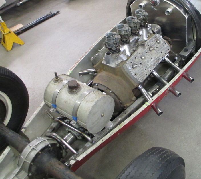

    If you are using a side shift trans, buckled directly to the rearend, it will get very tight. Don Waite didn't use a trans, and look where he sits in the car. I did this belly tank 3 years ago, you run out of room in a hurry. Good luck with your project

  10. Marty Strode
    Joined: Apr 28, 2011
    Posts: 9,707
    Marty Strode

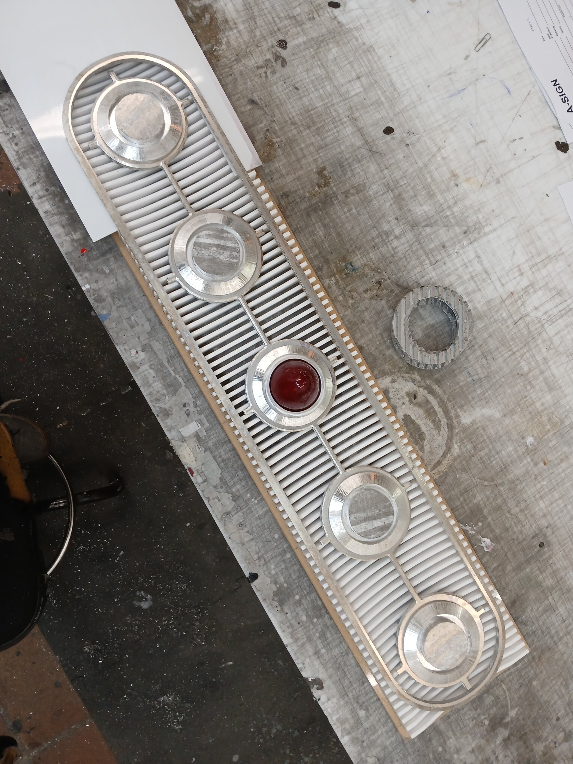

    I've been gathering parts for the past couple months. I did manage to make the parts for the tail panel. The center will be a tail light, the exhaust will p*** through the other 4 openings
