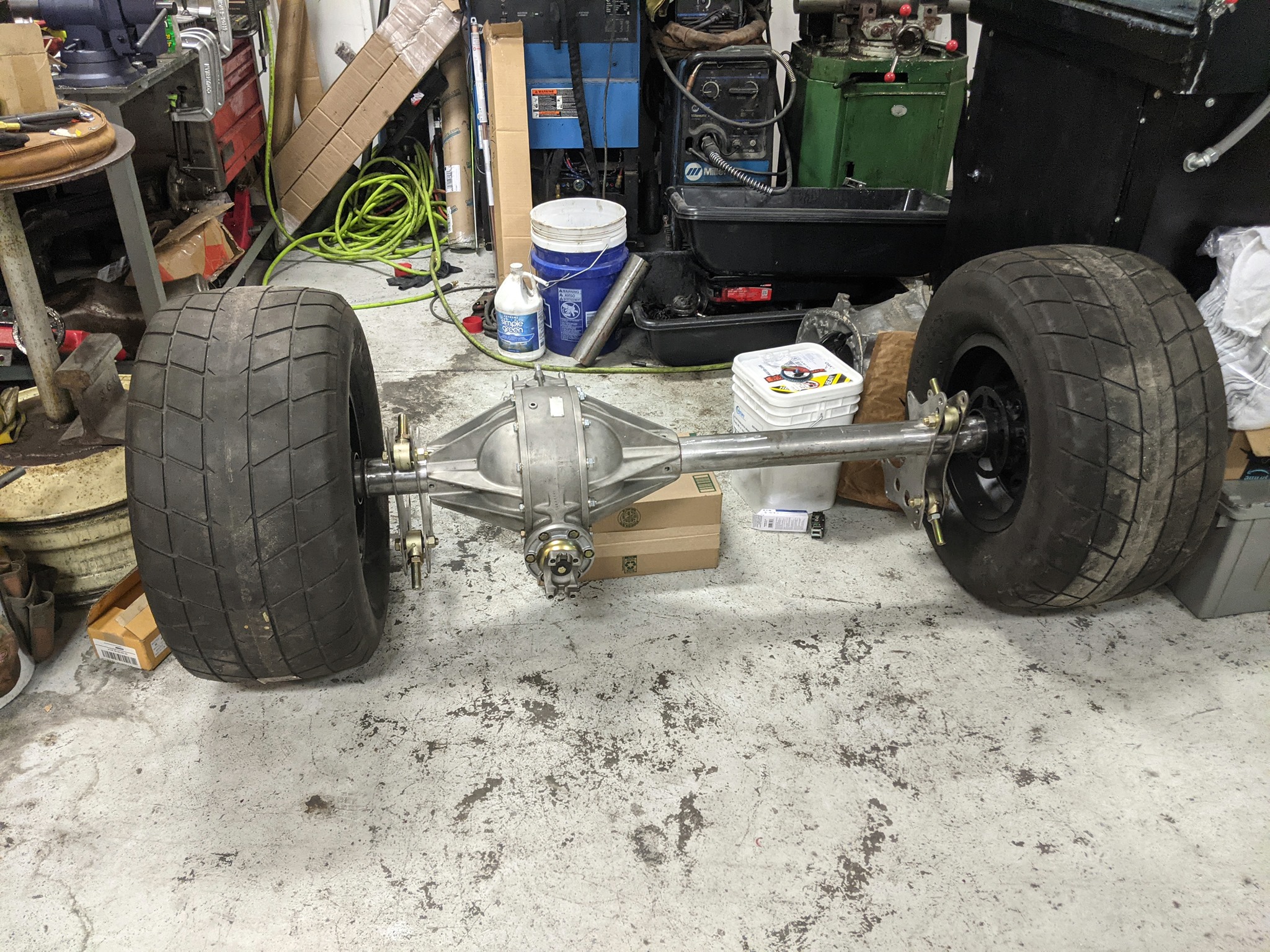

    No need for reverse rotation powertrain, save for the novelty.
    Winters makes a quick change with the ring gear on the other side, and gears cut the other way. It's intended to be in the front of an AWD car.
    I have on in the rear of my mid-engine A, with the engine in backwards.
    GN axle tubes can be had at up to 48" in uncut length, and axle shafts can be had off-t******lf to go farther than this if you want.

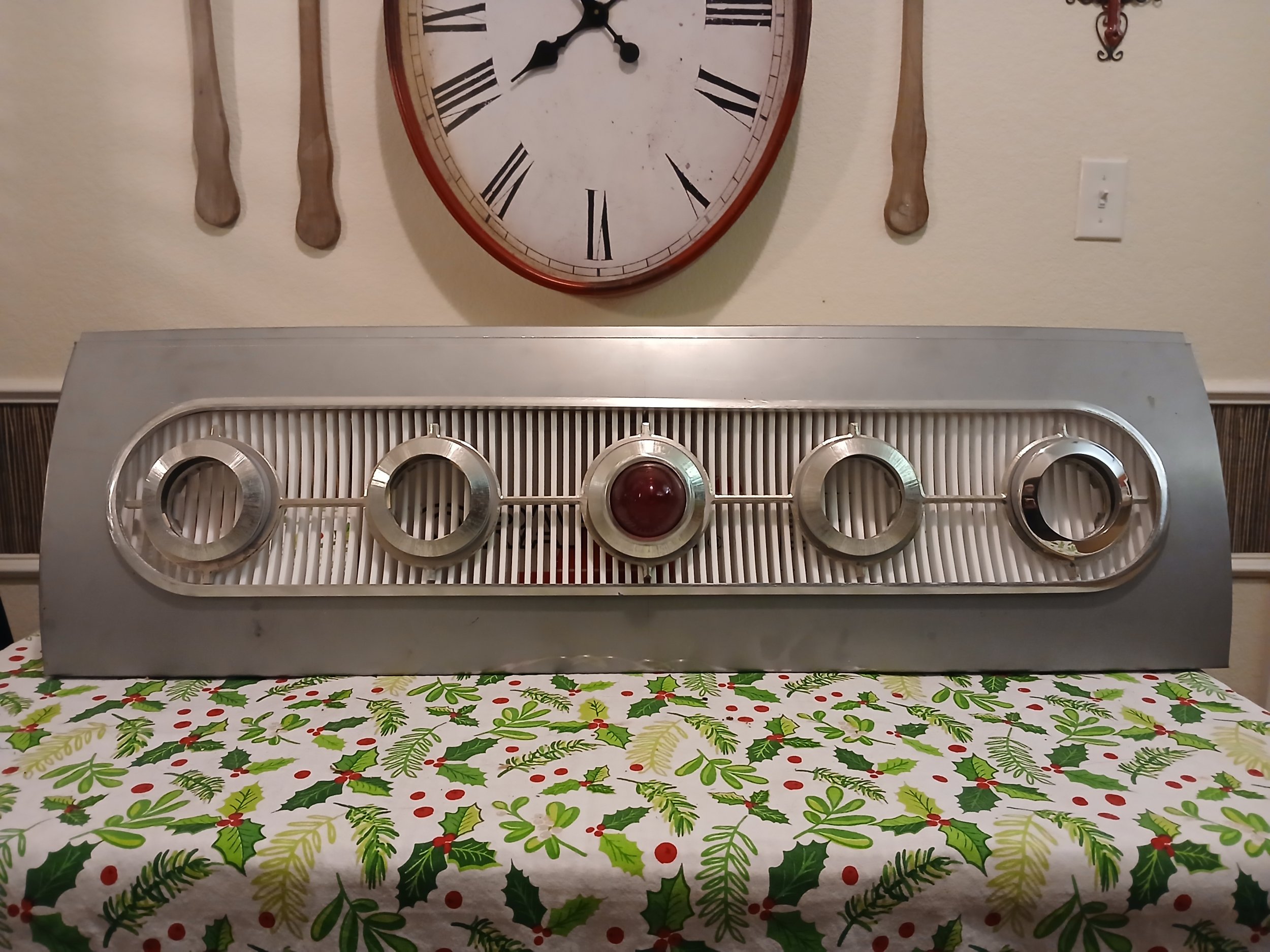

    Made all the parts for my tail panel, here it is mocked up. 20241219_195234.jpg 20241219_195253.jpg
