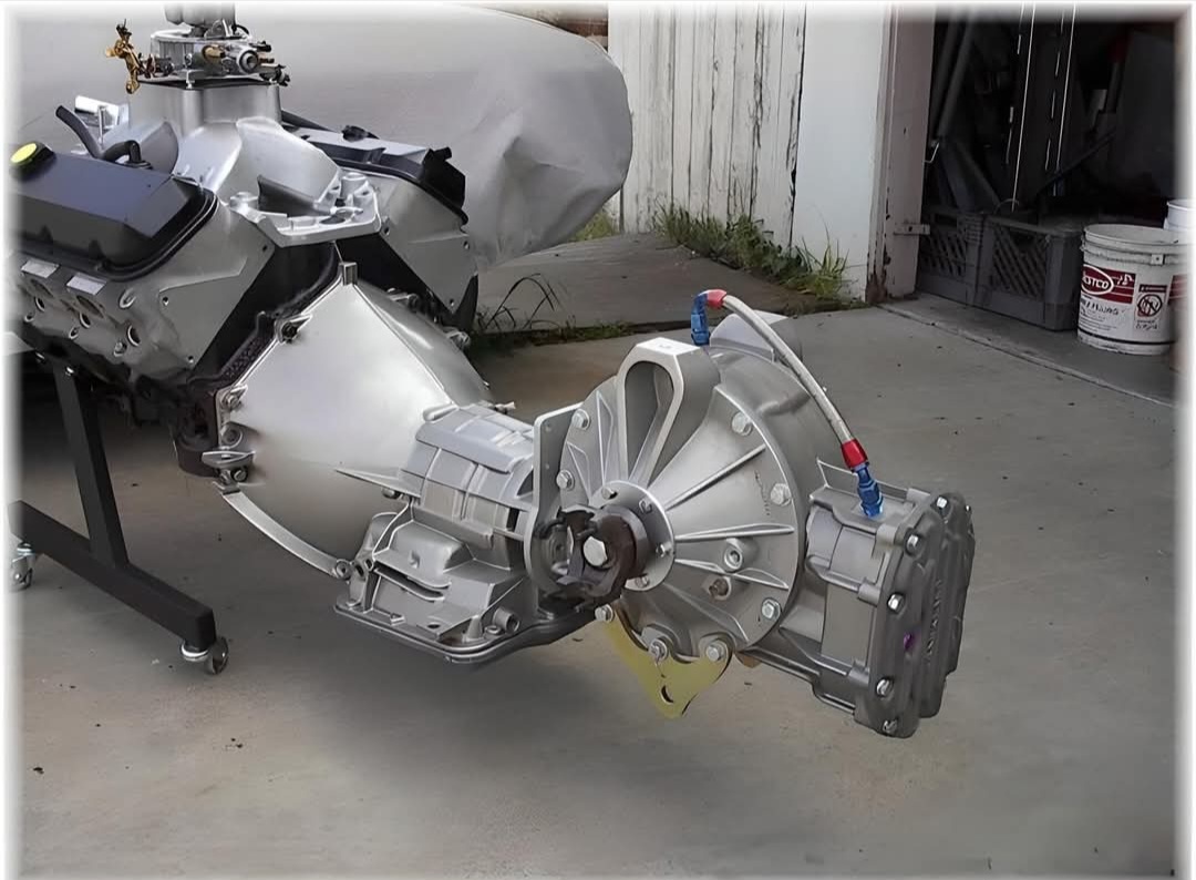

    I’ve seen this picture before on a V8 Corvair site. Big block, short case power glide, Quick change chunk

  12. 1biggun
    Joined: Nov 13, 2019
    Posts: 960
    1biggun
    I want it for the local 300" no prep street drags . ;)

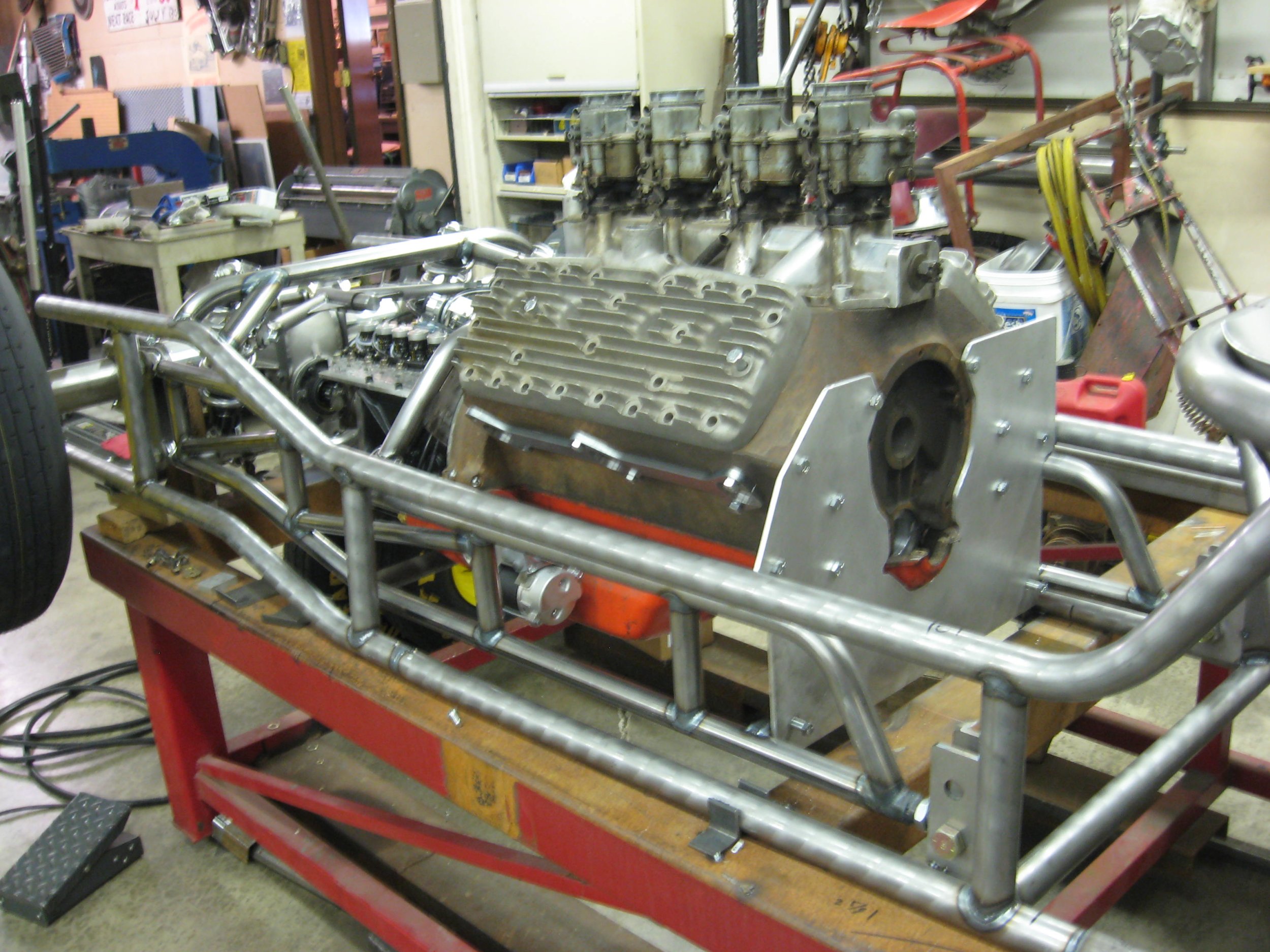

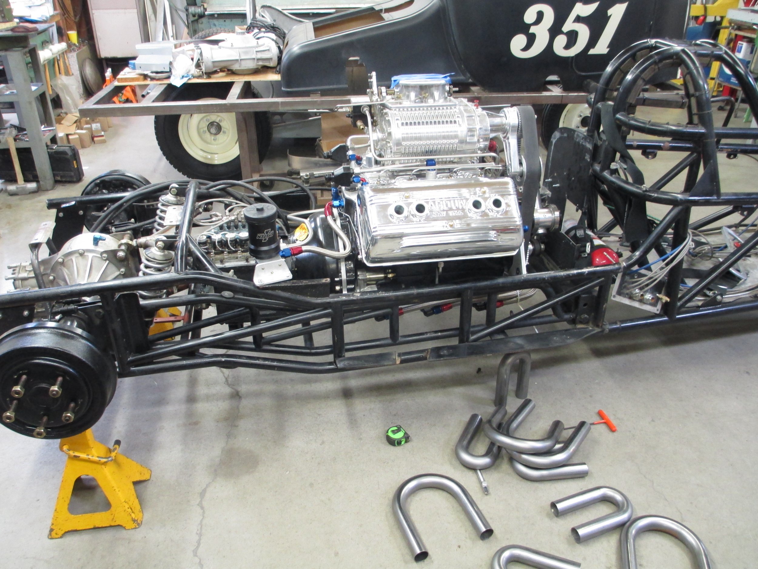

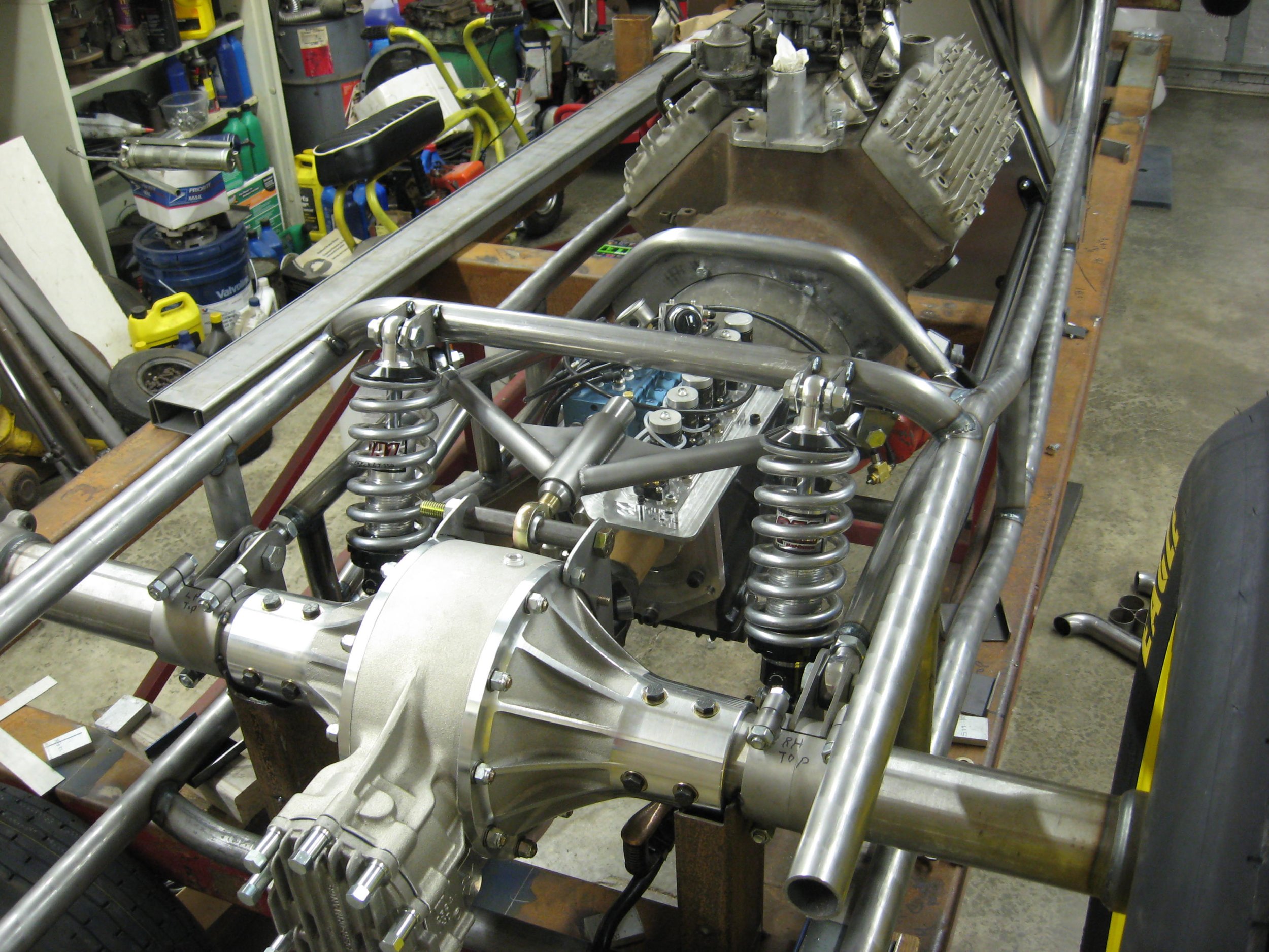

    Not sure if Dave Lohr (Littleman) had a build thread on here or not on his
    Screenshot_20241221_193603_Facebook.jpg Screenshot_20241221_193516_Facebook.jpg Screenshot_20241221_193653_Facebook.jpg Screenshot_20241221_193554_Facebook.jpg
    Just Gary, hrm2k, bchctybob and 8 others like this.

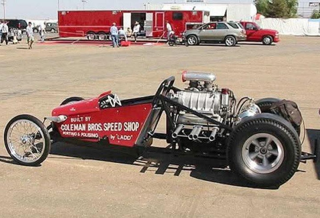

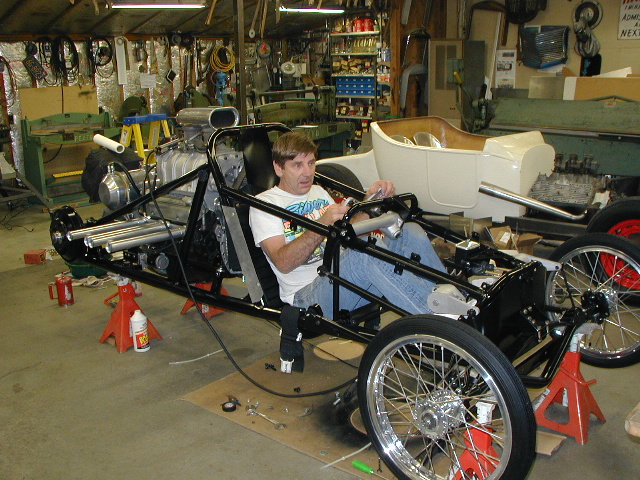

    I built this "Engine Behind The Driver" Modified Roadster with a swing arm. It is now a Lakester. IMG_0420.JPG IMG_3882.JPG IMG_3885.JPG
    bchctybob, Blues4U, alanp561 and 17 others like this.
