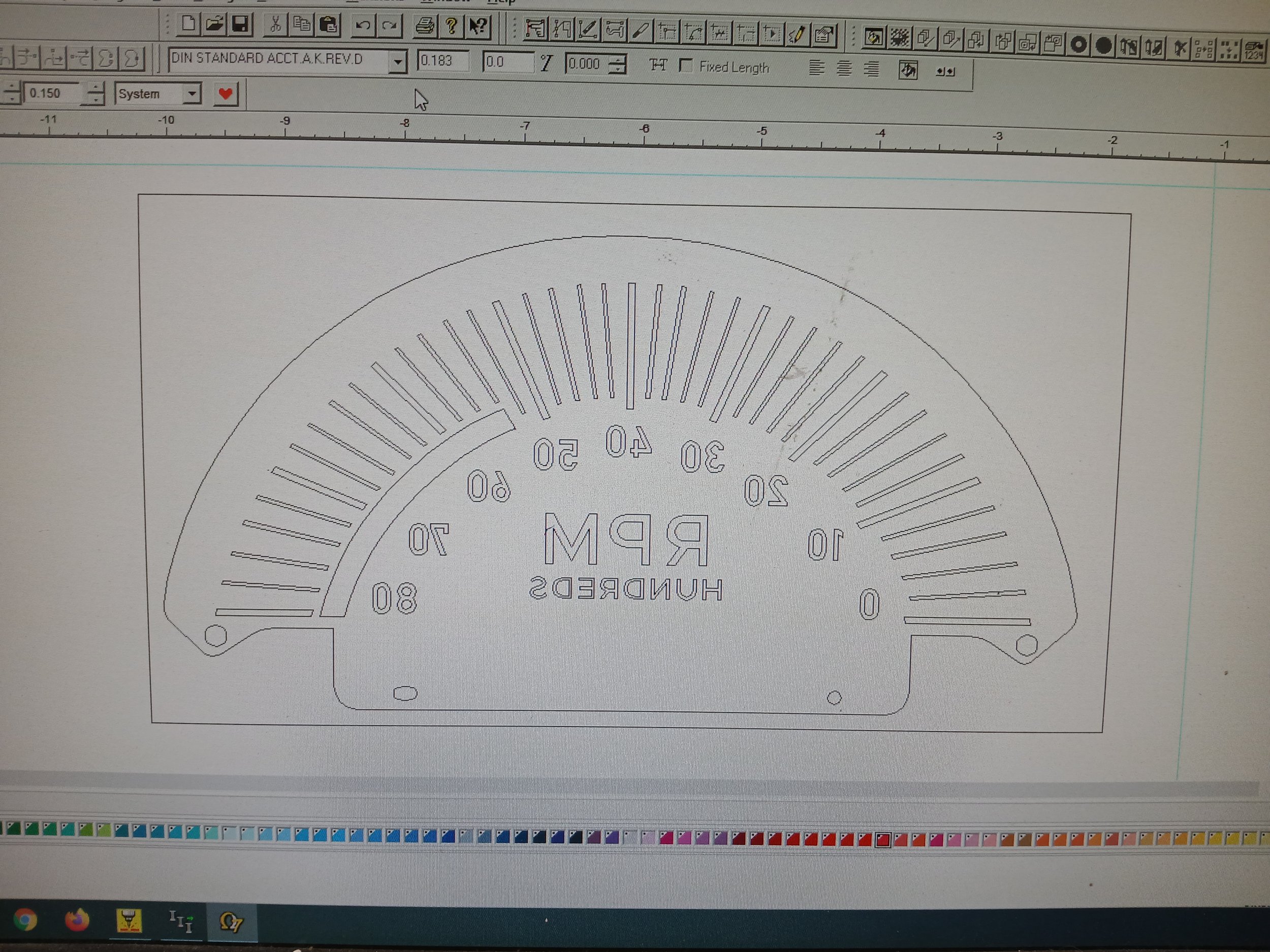

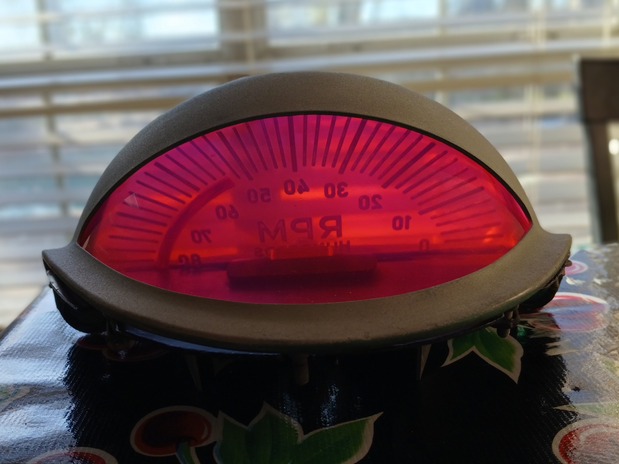

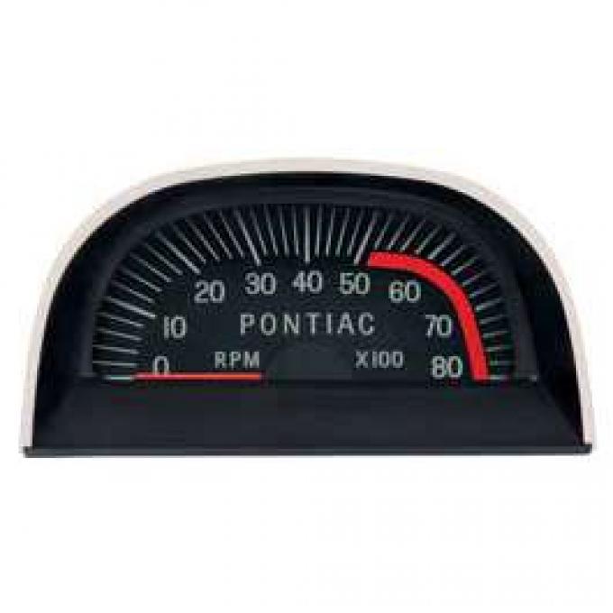

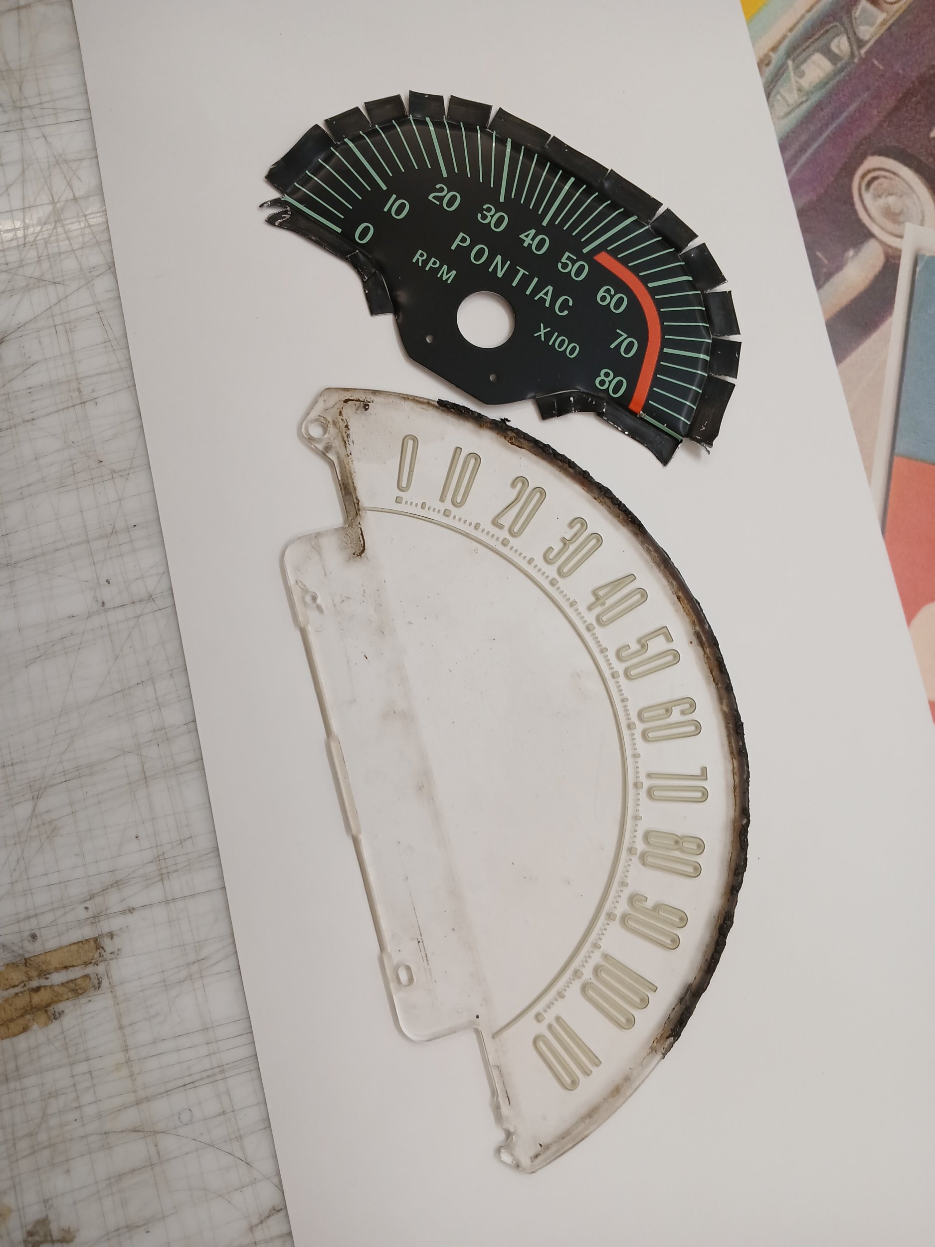

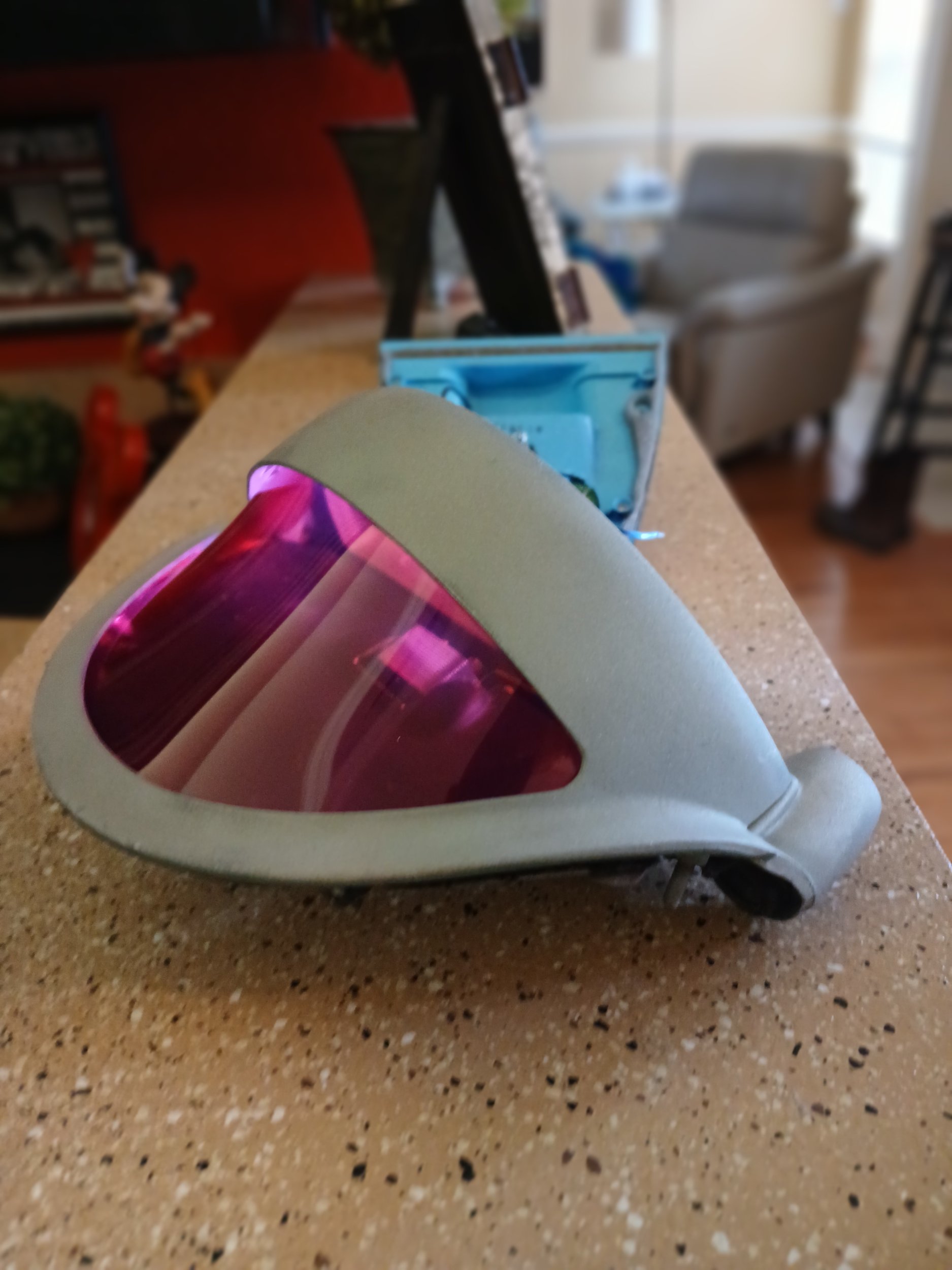

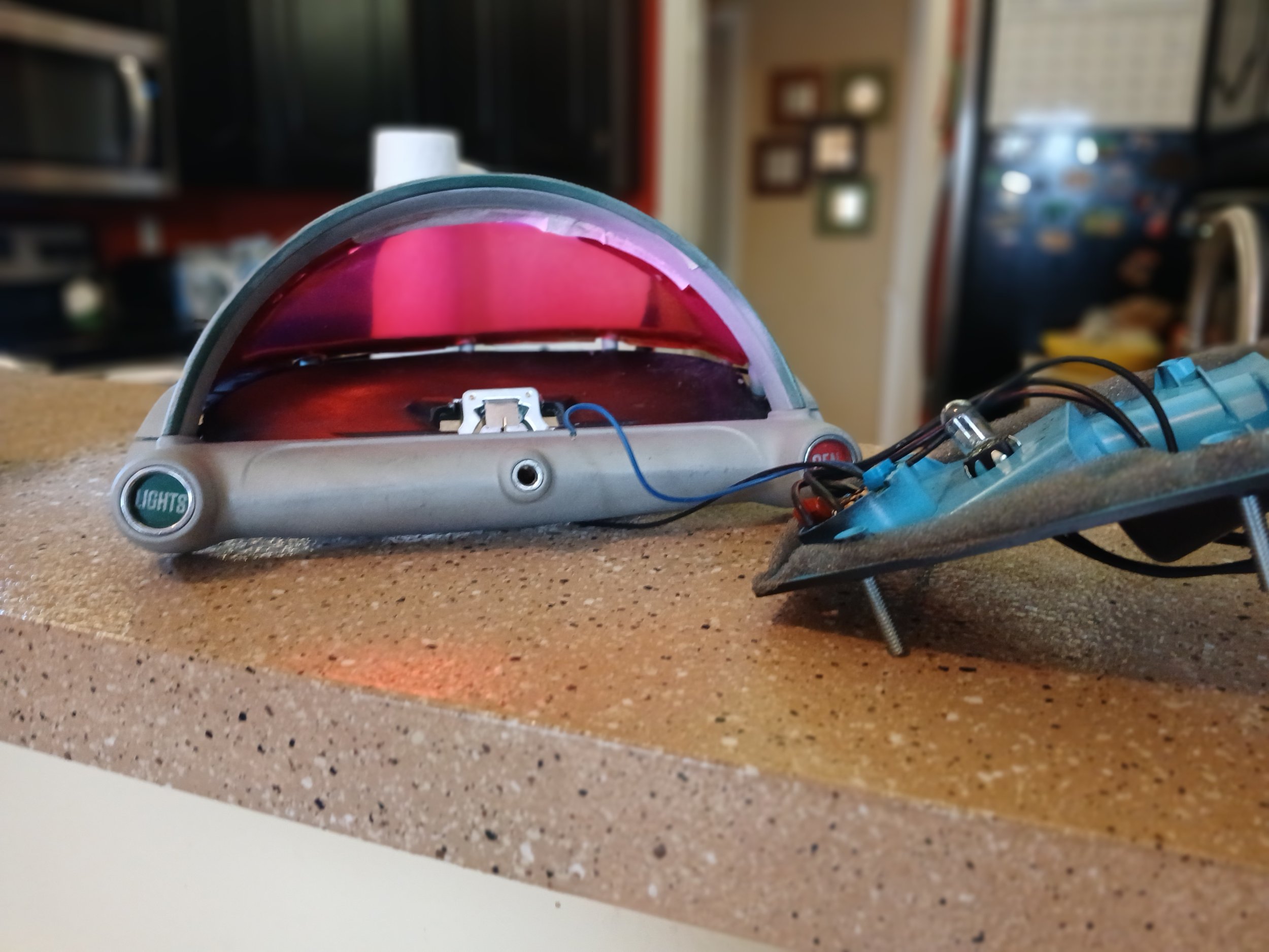

    I'm using a 1954 Ford Speedometer in this car, thought it would look cool being that it's center steer. Since I'm using the short torque tube, I converted the speedometer to a tachometer. I bought a OER Pontiac hood tach, took it apart and installed it in the speedometer housing. The bubble was in poor shape so I made a new one in my oven. I painted it with so candy to tint the bubble. Finally, I made a new lens for it that is correct for the tach.

    **** that’s cool!
    Stogy and Noah* like this.
  4. loudbang
    Posts: 40,347
    Brilliant :)
    Stogy likes this.

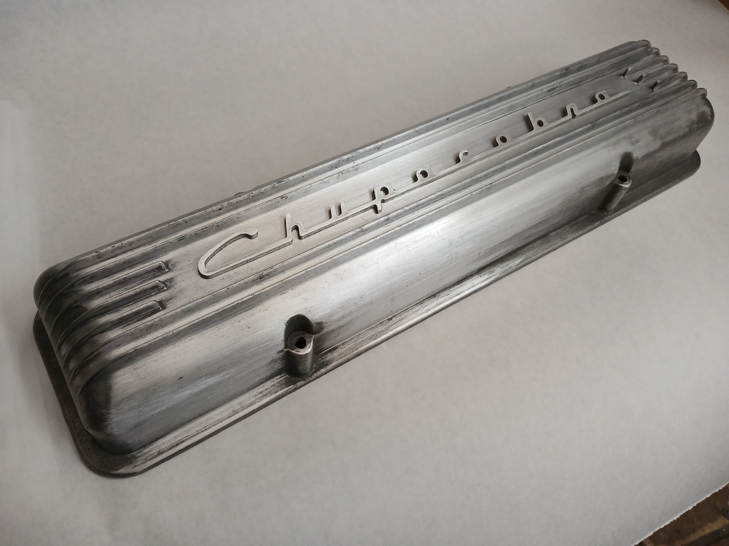

    I haven't done much on this car lately, but I did manage to make some custom valve covers for it today 20250218_141355.jpg 20250218_141337.jpg

  11. Tim
    Joined: Mar 2, 2001
    Posts: 20,429
    Tim
    from KCMO
    Lmao that’s fantastic. How’d you go about doing that??

  12. Stogy
    Joined: Feb 10, 2007
    Posts: 27,213
    Stogy
    I'm gonna guess machine some Vette covers flat and separately machine the text in the correct font and fix to covers...art really...Noah is quite the thinker and do...errrr.

  13. Noah*
    Joined: Nov 11, 2006
    Posts: 450
    Noah*
    I milled the Corvette off and cut the Chupacabra out on my router from 1/8" aluminum.
