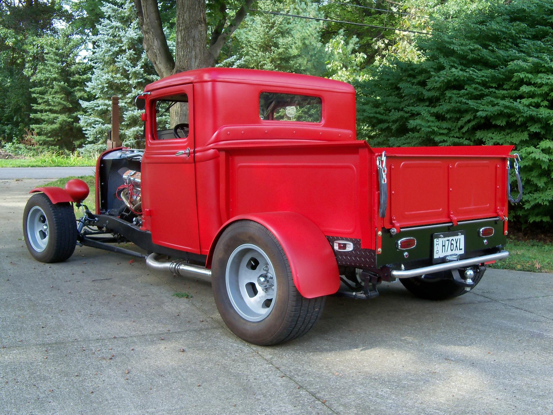

    This is a photo of my old 33 with a 42-48 F-1 rear axle and a 26-27 pickup box. A 32 box will be wider. Uses stock 35 ford wheels and 7.00X16 tires.

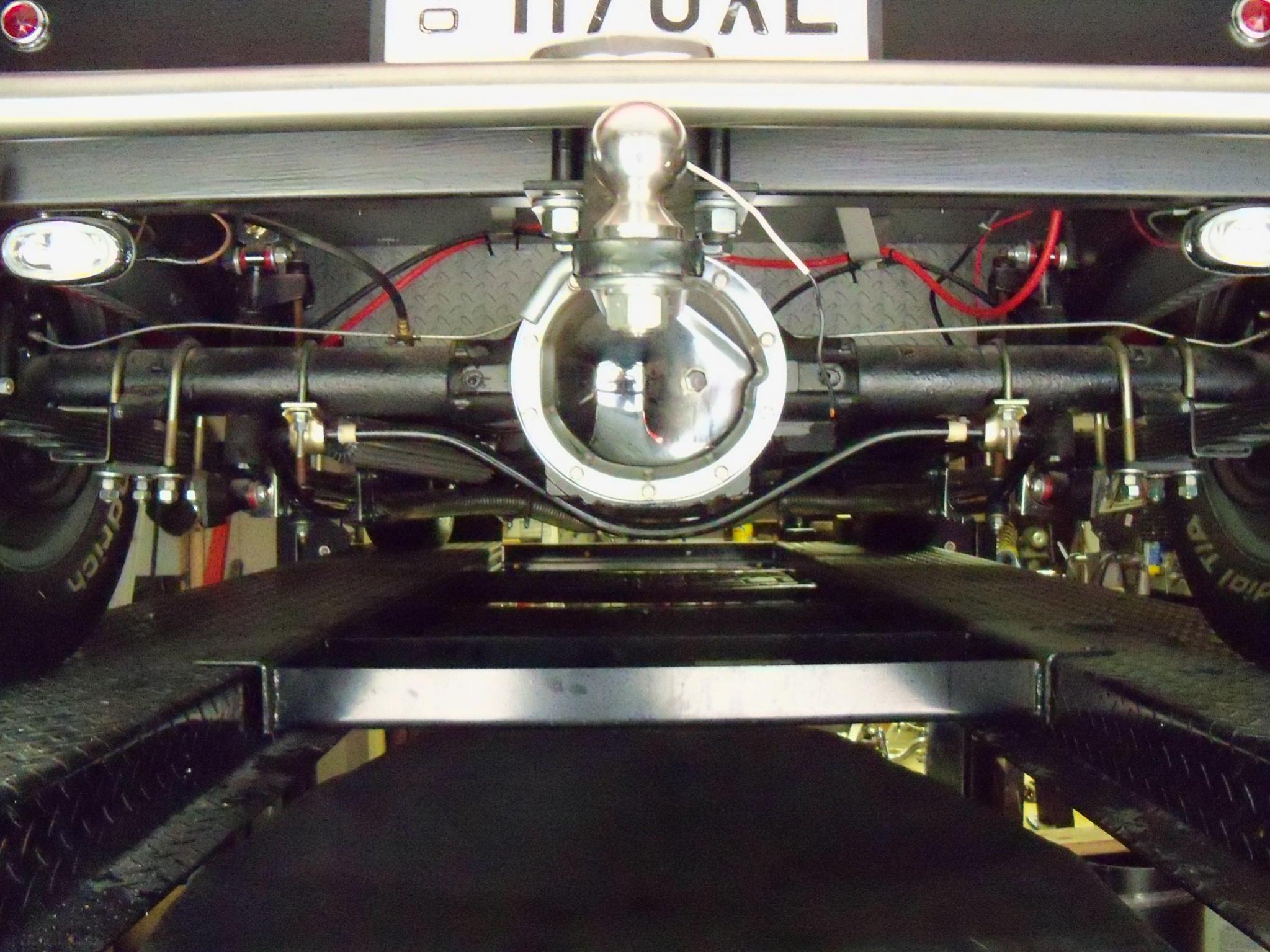

    Hey coming in a little late on this but I'm using a Ford 8" out of a Maverick. It fit perfectly with fenders on my '34.
      322.8 KB
      141
