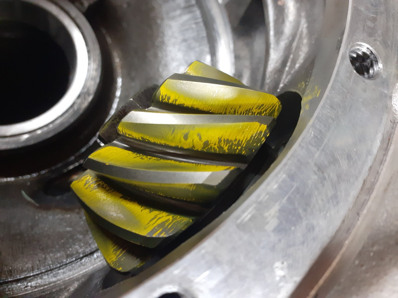

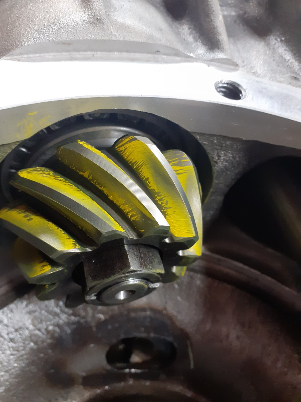

    Hi - I am trying to get my new gears set up in the quick change with the original A bells and have arrived at this pattern (after quite a few tries !) My backlash is around 0.008" and both carrier preload and pinion preload is 20 in lbs .I know there are folk on here that have done it before and will be more knowledgeable than me ,could anyone give me some direction on which way to go now? pinion out?,less backlash? 20230215_110753.jpg 20230215_110801.jpg

  6. gimpyshotrods
    Joined: May 20, 2009
    Posts: 24,582
    gimpyshotrods
    Where your arrow is pointing that says "shim goes here", I would remove a shim there and see what it does to the pattern.
    It appears that the pinion is too deep (too close to the carrier), but not by a whole lot.
    If you have more than one shim, take one out. If you have just one shim, you may need a thinner shim, but try taking it out first.
    For all we know, gear marking compound may be oil paint. Now that you have mentioned it, it does seem like that's what it is.

  7. Mike VV
    Joined: Sep 28, 2010
    Posts: 3,324
    Mike VV
    from SoCal
    trike -
    One problem, you have WAY too much paste on the gear teeth. Should be a thin coat, no 1/8" thick glob, areas at all.
    Should be just a thin, just...fully coated, thin coat.
    Then try the rotation with the pinion again.
    Mike
    winduptoy, footbrake and tractorguy like this.
  8. Dan from Oakland
    Joined: Jan 16, 2009
    Posts: 257
    Dan from Oakland
    Mike VW beat me to it- way too much marking paste- wipe it all off. Put a tiny amount in a spray can cap, and use a small acid brush stir it around, then apply to the gear teeth. The brush bristles only need a light coating on them before you apply it to the gear teeth. Apply to the ring gear teeth and let the pinion mark the contact pattern in the paste. The paste only needs to be a slight haze prior to checking contact. I find it easier to rotate the ring gear while putting drag on the pinion to get a pattern.

    20230216_094301.jpg Hi all .thank you for the words of help -I only put on the same amount of paint as every youtube video I watched but appreciate that it could be thinner. I did think that the pinion is too far in as I started with it too far out and worked from there. This morning I have been out and (with much thinner paint) machined 0.010" from my shim( I only use 1 solid shim and machine it to size) I appreciate that my backlash will now be more so will have to move a gasket from one side to the other to get it back to where it should be but are these more acceptable witness marks? 20230216_094244.jpg 20230216_094244.jpg

  14. gimpyshotrods
    Posts: 24,582
    gimpyshotrods
    Looks better to me, but now you might have too little marking compound on it.
    Reset the backlash, and check again.
    You're close.

    Hi ,I think I am close -those were the ghost marks on the non painted gears (although I did cut right back on the amount I brushed on) I have closed up the backlash now to 0.006 (ish)-it is difficult to measure 100% successfully on these axles as the only place to check is on the back quick change gear shaft that has the pinion on it ,anywhere else you are also involving the quick change gears backlash too. It turns smoothly by hand when all ***embled without any unusual noises or grinding so I am gonna call it done. When you do this to an A axle you have to put a vent in so I welded in a 3/4" bung that I can get a small camera down ( and **** old oil out of) .I can do a couple of miles and check whats happening inside that way.
