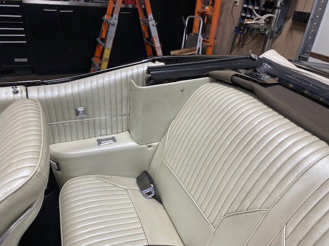

    When you own convertibles, you learn to hide things like speakers. 25 years ago I installed two 6" mids and a pair of 2" tweeters in my interior quarter panels. I cut away the foam backing from the vinyl in that area, and simply allowed the speakers to play through the upholstery. It works great! Decades later, with cleaning, sun and wear you can just make out the bigger speaker on that side is in the picture below. If I didn't tell you they were there, you wouldn't notice. I installed a fader under the ash tray door in the dash to balance the sound from my factory 8 track deck.
    I don't know what your door panels are made out of (carpet, vinyl, fabric) but you can hide your speakers under it. It may not be concert hall, Bose sound reproduction but I can hear it even with the top down and I'm half deaf.
    Funny memory, I didn't want the hardware to show under the vinyl so I spot welded the speakers to the metal piston covers (quarter panels). I didn't even take the upholstery loose, just wetted a towel, laid the panel on it and hit it quick with the MIG. The crossovers are welded in there as well.
    What a goofball I was, glad I grew out of it. :cool:

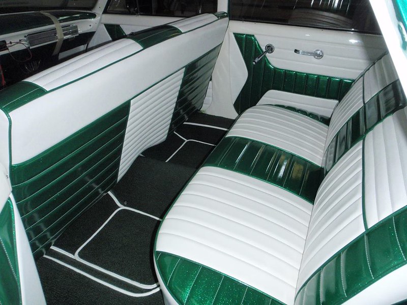

    I did the same thing. Hid them behind the vinyl. 8 speakers throughout the wagon, none are visible.

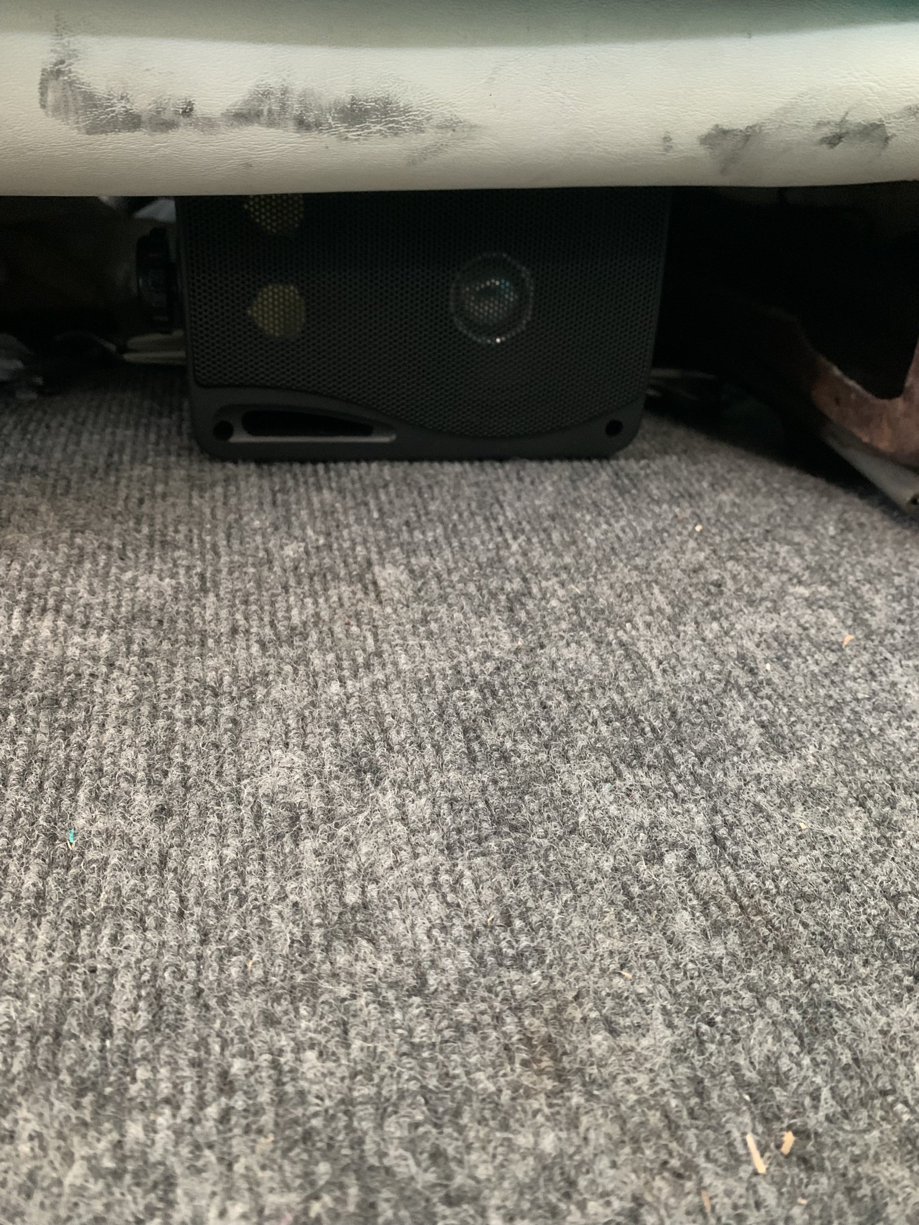

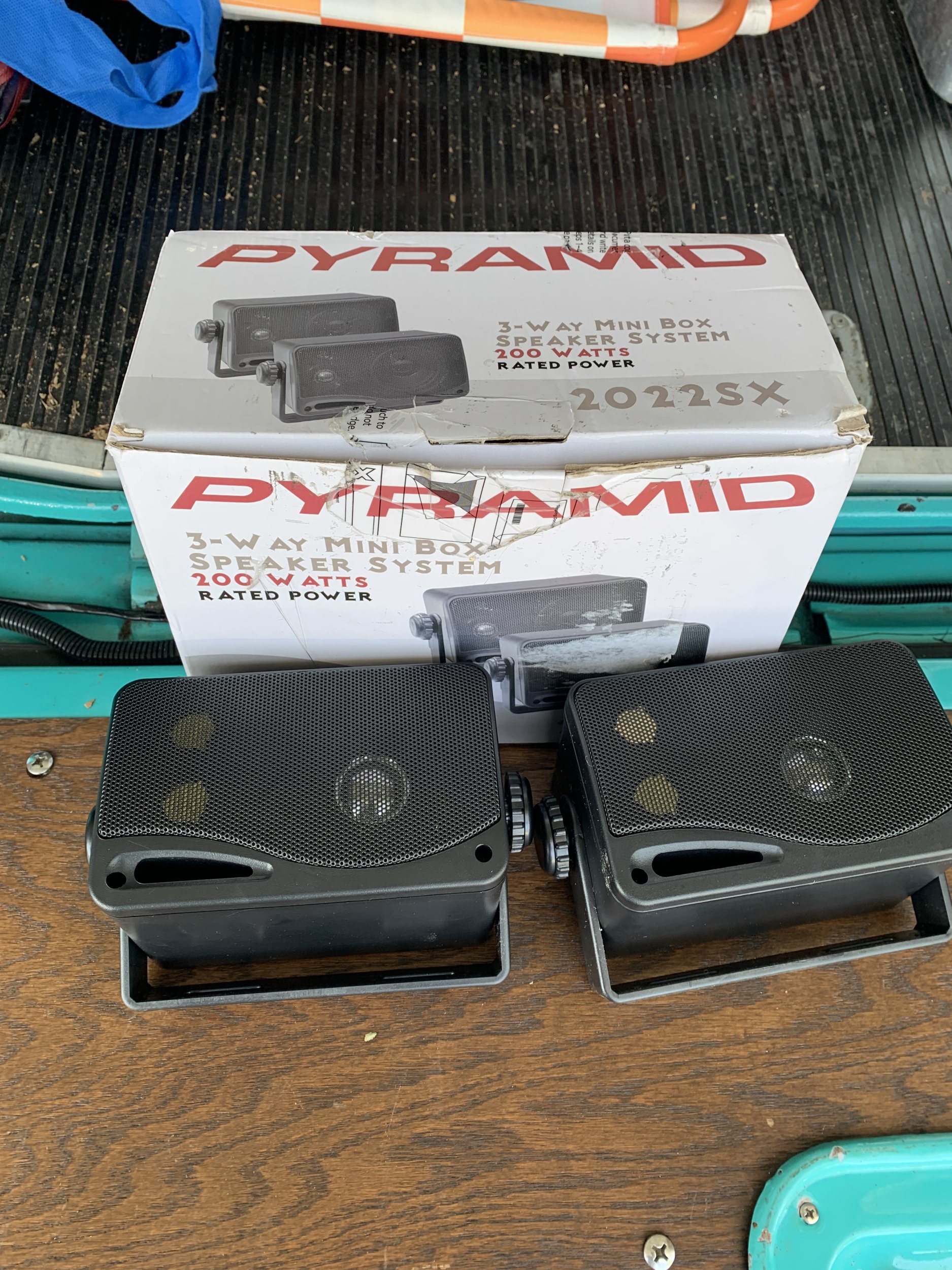

    Here’s the solution,
    $13 on Amazon Warehouse
    they fit perfectly under the front seat facing rearward
