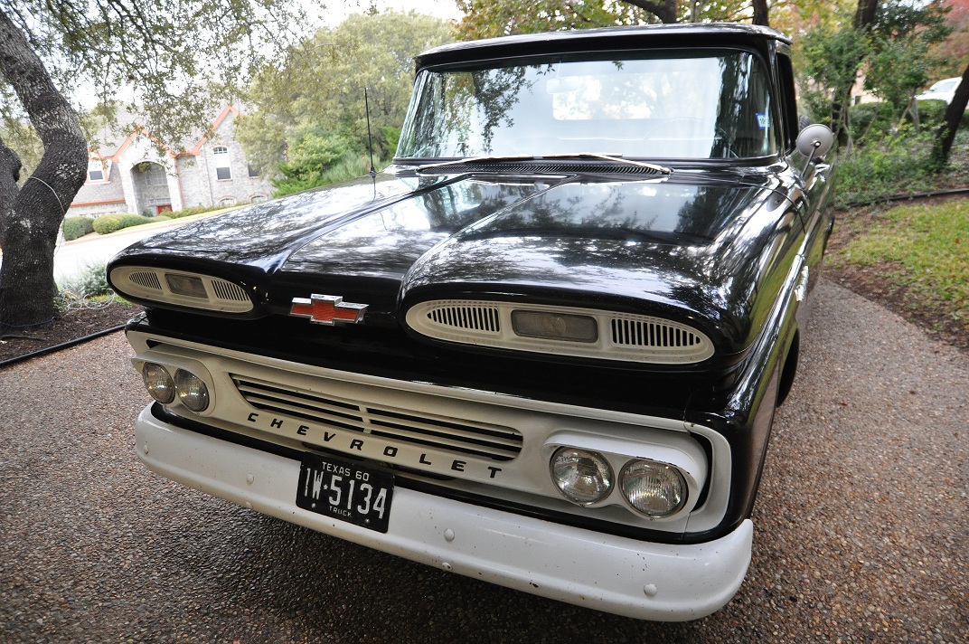

  2. Heckler
    Joined: Mar 20, 2005
    Posts: 200
    Heckler
    from Austin, TX
    Pic
