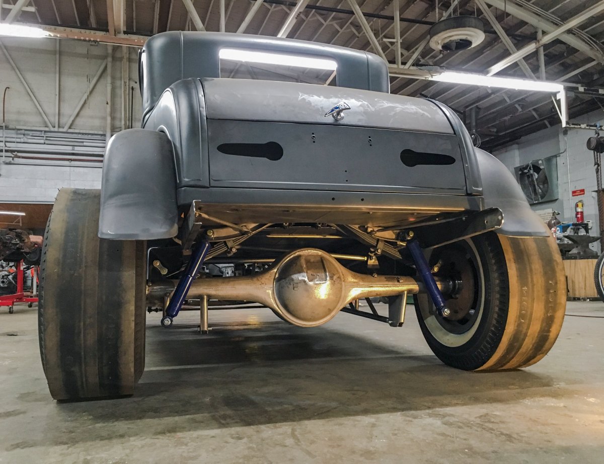

    I'm in the planning stages for rear shock placement on my 29 full fendered high-boy project. Please share photos of what you've done.

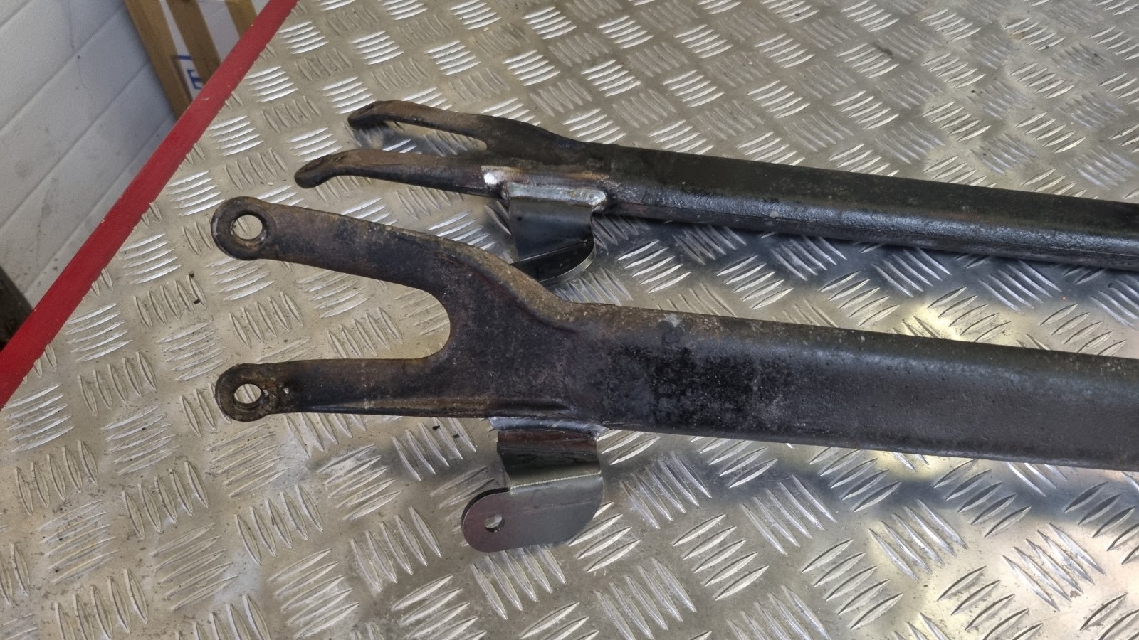

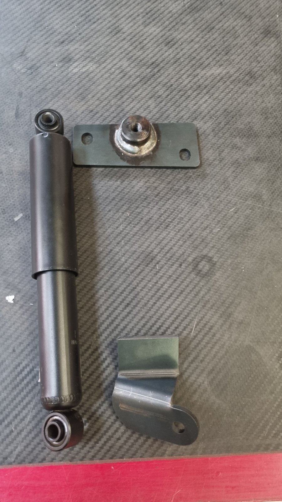

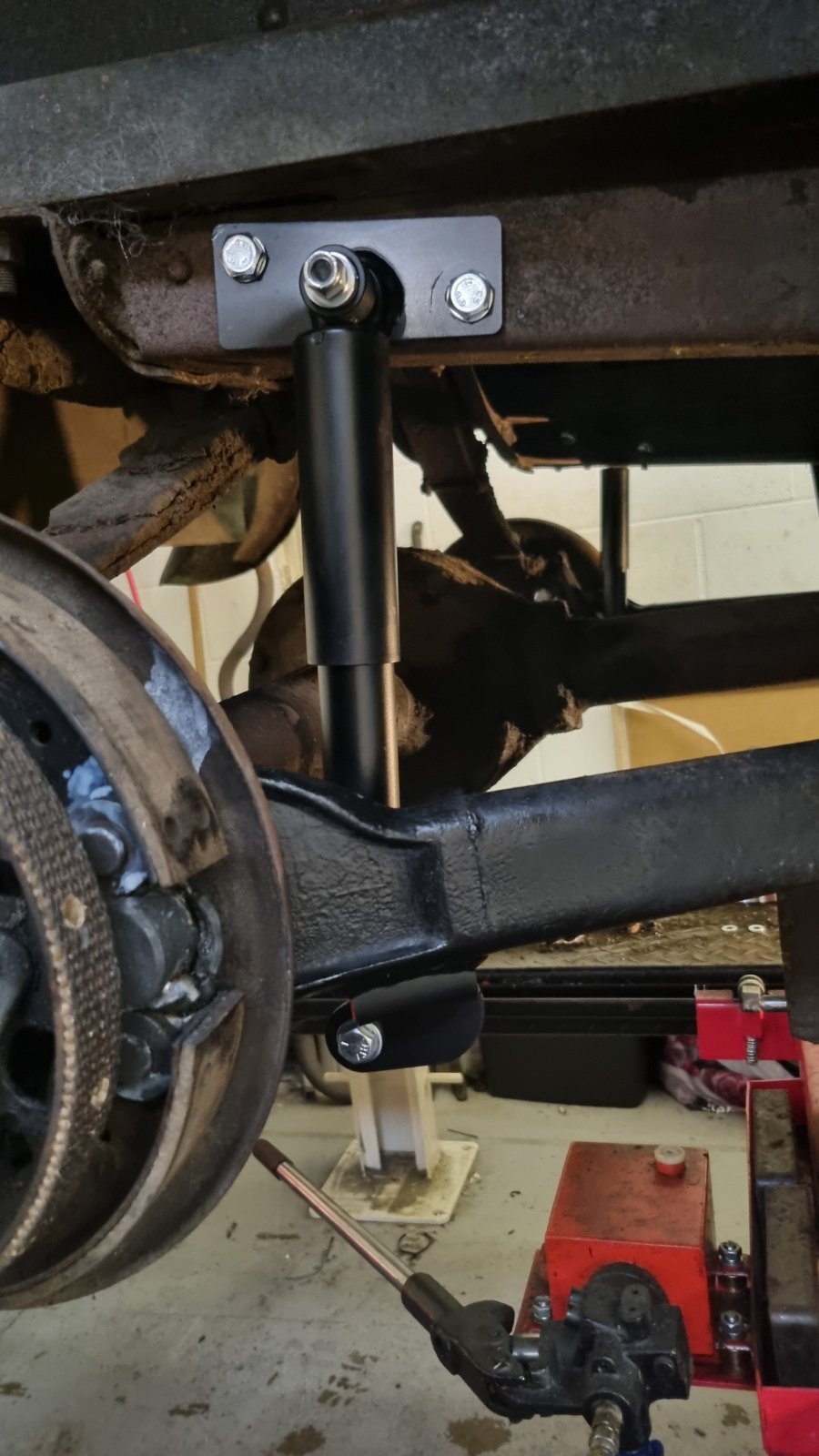

    On a stock model a axle and original top mount points on the frame...... 20221125_134935.jpg 20221213_092143.jpg 20221222_113628.jpg

  10. X38
    Joined: Feb 27, 2005
    Posts: 17,498
    X38
    Good question. I would be concerned about flex in the lower bracket over time. A gusset wouldn't go astray. Clean design though.

  11. '29 Gizmo
    Joined: Nov 6, 2022
    Posts: 1,219
    '29 Gizmo
    from UK
    You can do your own design but its 5mm plate and is perfectly adequate for the application.

  12. winduptoy
    Joined: Feb 19, 2013
    Posts: 4,550
    winduptoy
    Yes, but it is what you are attaching it to....and not all Model A radius rods are created equal however it looks like you have the more robust casting/forging to attach to.

  13. '29 Gizmo
    Joined: Nov 6, 2022
    Posts: 1,219
    '29 Gizmo
    from UK
    Thanks... Early A's had a pressed steel end which is extreemly flimsy. I upgraded to the later version which is forged. A worthwhile upgrade for any A.

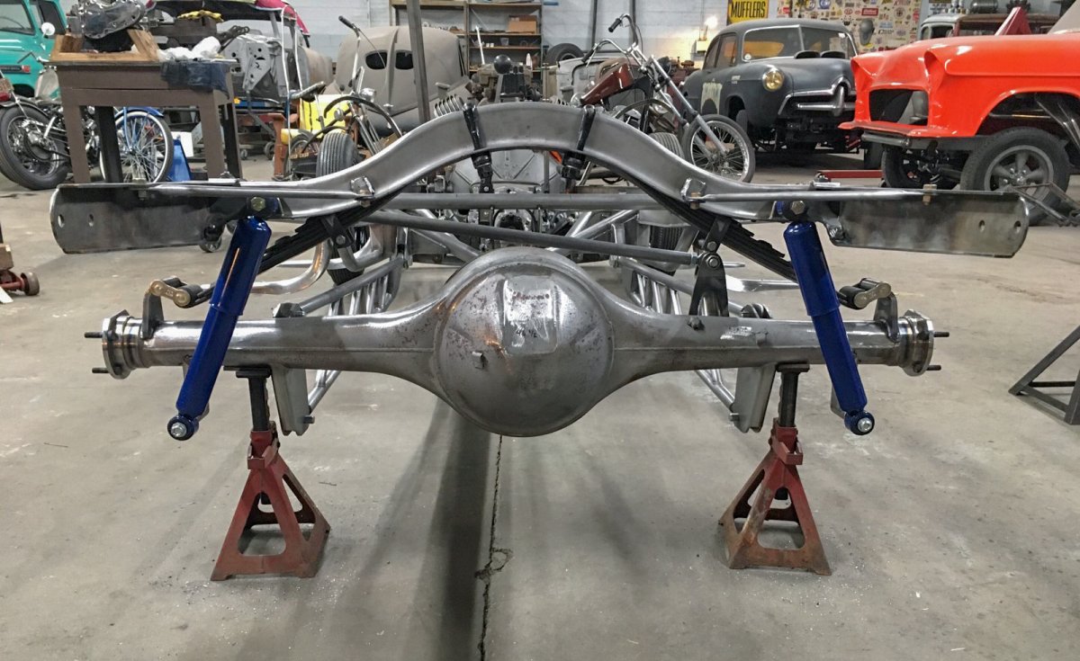

  14. PotvinV8

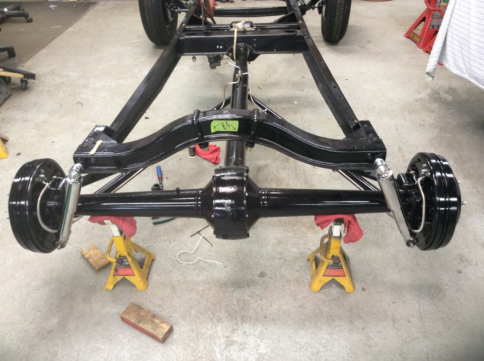

  15. Hitchhiker
    Joined: May 1, 2008
    Posts: 8,594
    Hitchhiker
    I do like the design. But also have some concerns like yours, though I'm not necessarily alarmed. I think he'd have seen problems by now, after 1100 miles. If he'd said 50 miles, I'd have a lot more reservations. Lol
    The weld is the weak link in my opinion. Not the plate. Though it all looks plenty good to me in the pictures. I'm not necessarily concerned either is an issue or will be. I'd have more reservations if you'd said 50 miles on it and I feel like you'd see issues already at 1100 miles if you were gonna have them.
    Just my thoughts. Neat design. Thanks for sharing
    Outback and '29 Gizmo like this.

    PotvinV8(above) has his shocks in the corners and I've seen an IronTrap video where his are mounted closer to the banjo. Is there any advantage one vs. the other?

  20. PotvinV8
    Joined: Mar 30, 2009
    Posts: 555
    PotvinV8
    Typically speaking, the closer they are to the end of the axle, the more effective, as it's the shocks job to try to dampen the movement of all that unsprung weight (wheel, tire, brake, etc.). A slight inward angle also helps as each side of the axle travels in an arc.

  22. X38
    Posts: 17,498
    X38
    From a best practice perspective, PotvinV8 has his in an ideal location. It may not always be possible, but this is what you should aim for, for reasons he has given.

  25. GuyW
    Joined: Feb 23, 2007
    Posts: 998
    GuyW
    Yes - with the closer-to-the-banjo shock location, the tire/wheel/brake has greater lever arm on the shock, so that theoretically, one would need a stiffer shock there, than if the shock is located further outboard.

  26. PotvinV8
    Posts: 555
    PotvinV8
    I like the brackets on the crossmember, very clean!

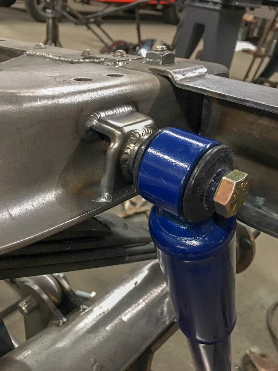

  27. ydopen
    Joined: Mar 14, 2010
    Posts: 275
    ydopen
    I used bolt on shock studs. Lower ones on 48 Ford style brackets mounted to axle ends.

  29. cederholm
    Joined: May 6, 2006
    Posts: 1,761
    cederholm
    Cool! Would love to see the lower shock mount better.
