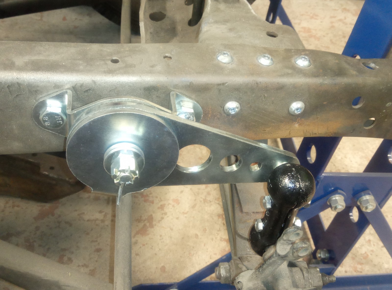

    If you are running original model A rear end, you might think about these friction shocks. https://www.mikes-afordable.com/product/A18015F.html Those are made by me and sold in US by Mikes Afordable. They are straight bolt on to model A frame, but they are designed for speedsters. On your high boy you need to shim the rear shocks little outwards to prevent hitting to inner fenders, like a guy did to his roadster here in Finland.

    I did consider friction, and those are nice!

    The good thing about friction shocks is that if you're going to rely on two pieces of leather to dampen the suspension, location doesn't really matter.

    That is why i use friction disc made some kind of fabric (by Offenhauser). And remember those are adjustable, something you can't get with cheap tube shocks! ;)
    Seriously, those are more for looks than performance: But by feedback from guys who had run them, they really works too.

    Lots of vintage motorcycles used friction shocks, with special friction discs. I imagine it won't be hard to source those. But, lever-action hydraulic shocks work better...

    Cheap tube shocks, no. But there are adjustable tube shocks on the market and adjusting them "tighter" doesn't put them in a bind like a friction shock. :)
