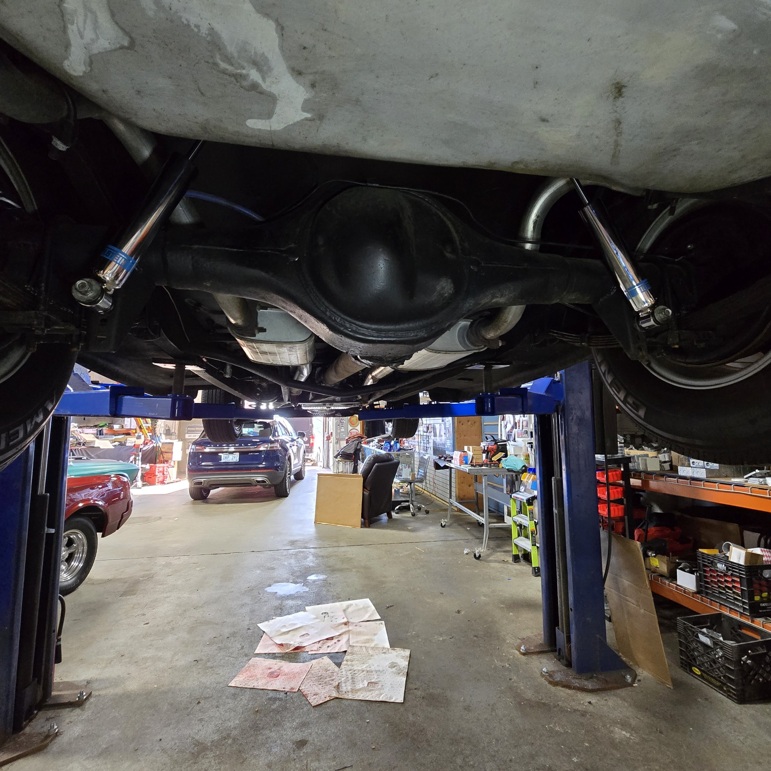

    Sorry for the delay on this had some other things to take of before I could take her for a ride. Bilstein shocks were definitely the way to go.

    Bilstein F4-BOA-0000788 rear and BSN-24-185035 front
