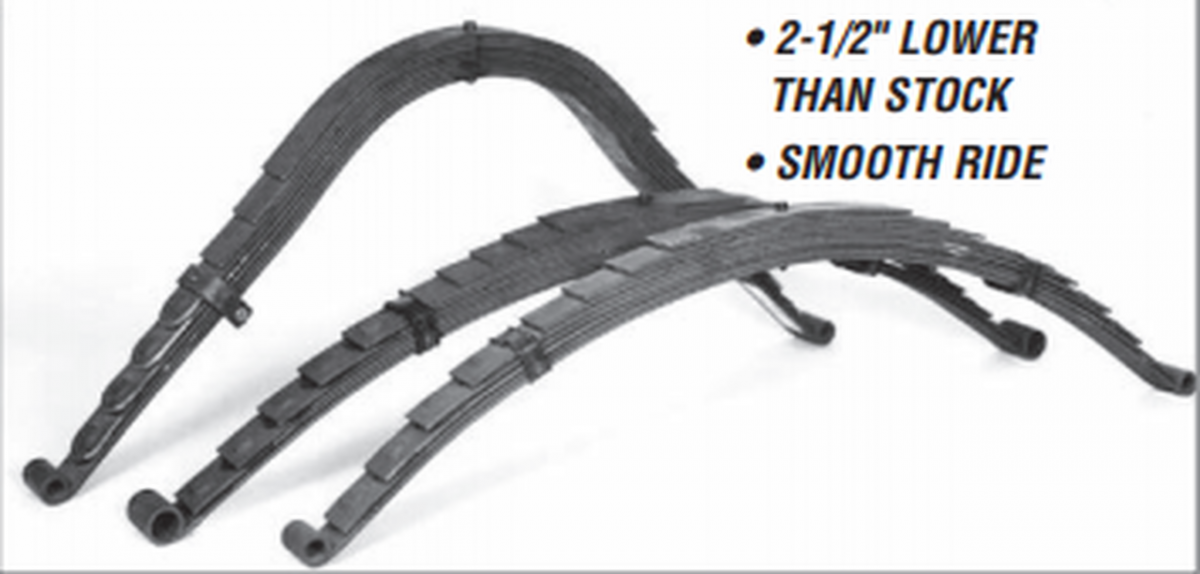

  8. So you’re talking about the rear spring right?
    When it’s on top of the rear axle it’s a God awful rollercoaster Shaped spring with a very high and very stiff arch. T or A . There a bunch of spring material there that’s doing nothing and a small amount doing the work. The parts that are more towards vertical are not working, the parts that are more towards horizontal are.
    Then the ride height is up there,,, higher than giraffe *****.
    Spring Behind out back utilizes the whole spring pack for ride control. It’s so much better in many aspects
