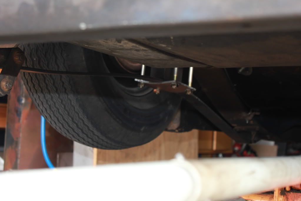

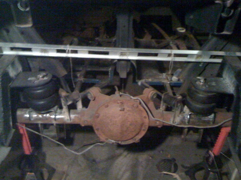

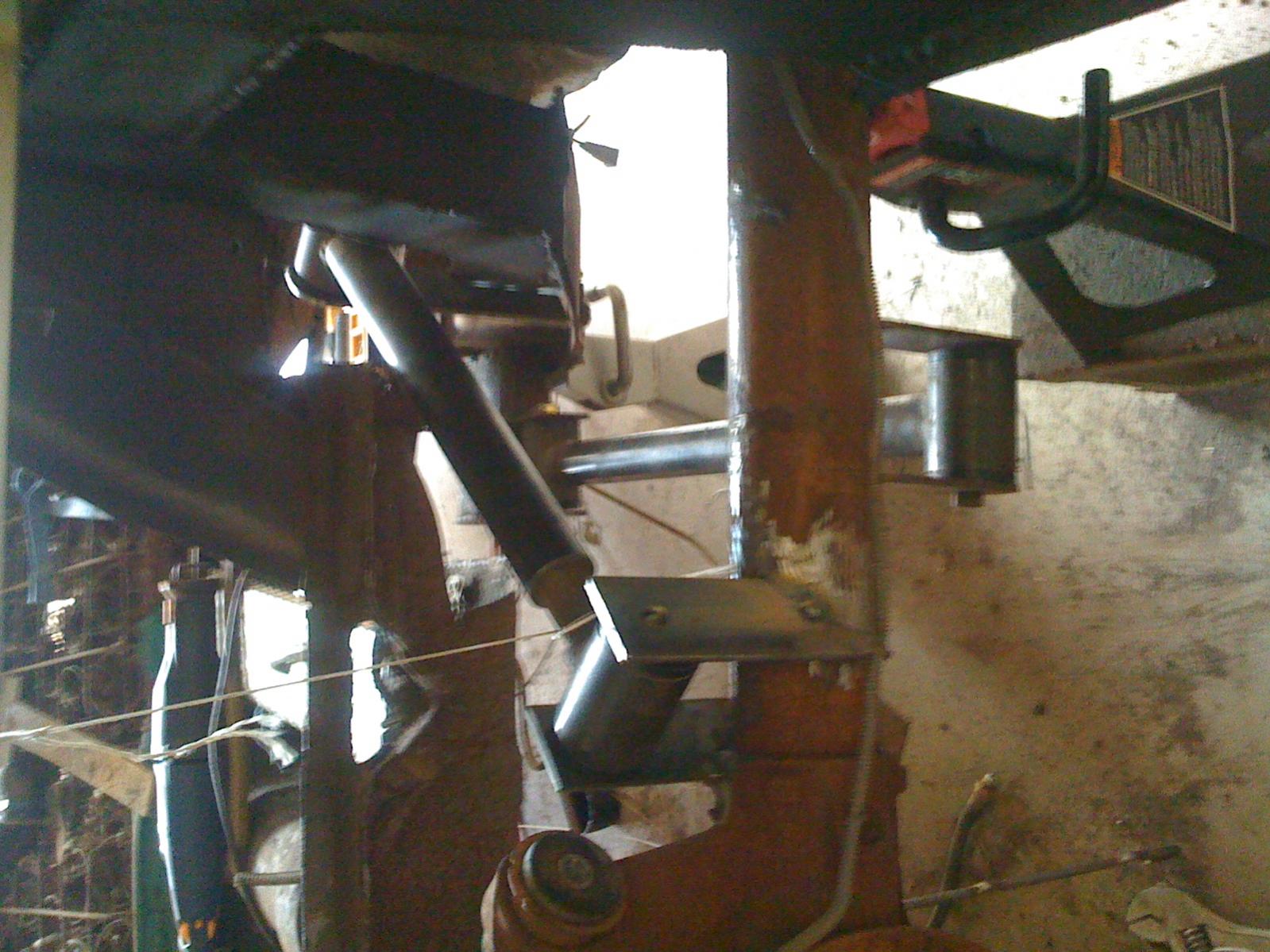

    Here are some pics of my current setup. It definitely needs to be changed.

    Man that's some scary looking ****. I sure hope you aren't actually out driving it like that!

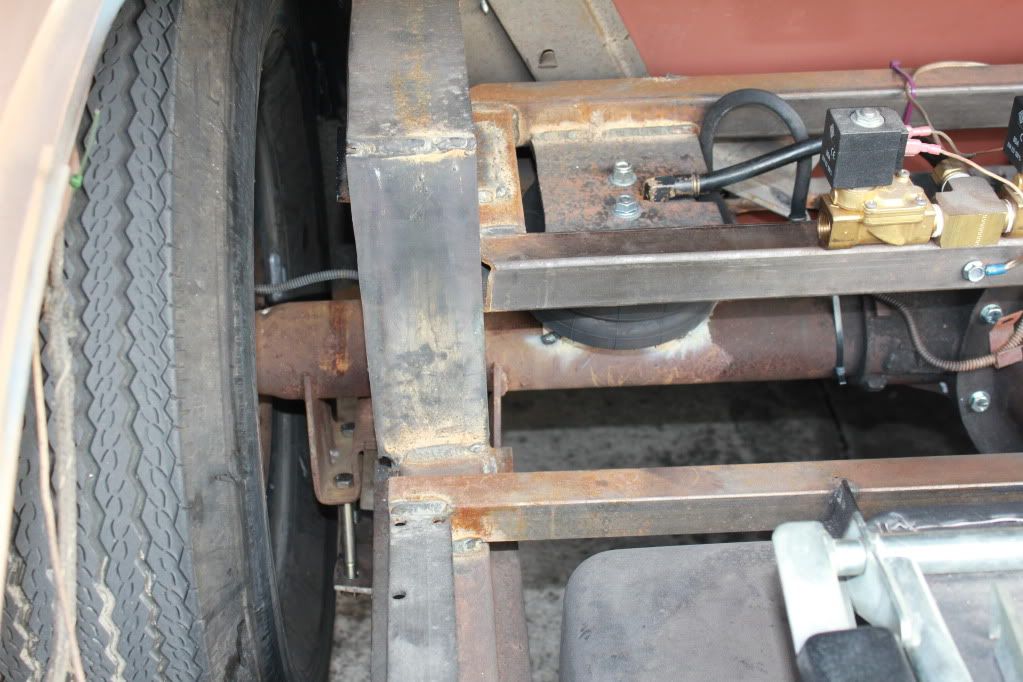

    went throught the same thing you are. (trying to decide) at the end of the day this is what was done, and how low it sits with 27" tall tires It is. braced and welded as well just dont have pictures finished. you get the idea

    That's what I was thinking!! Holy ****!!! :eek:

  14. poofus1929
    Joined: Jan 29, 2008
    Posts: 897
    poofus1929
    from So Cal
    No sh*t!! That set up is scary looking!! The leaf springs for one thing and some of the welds look questionable too.

    Did you heat those springs to get that funky rounded "W" shape in them? I won't comment on the engineering, but I'd probably not drive that car very briskly.........

    Trust me, I am NOT driving it like this. I set it up like this just to figure out where the rear end will end up, so I could order a driveshaft.

    Springs havent been heated at all. Thats what they look like when bent WAAAAY too far. HAHA, I wont drive it at all, thats why I started this thread.

    Not helping here but that is some scary ****.

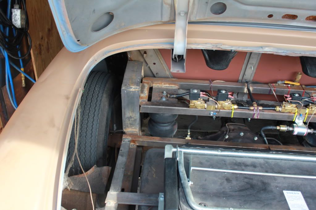

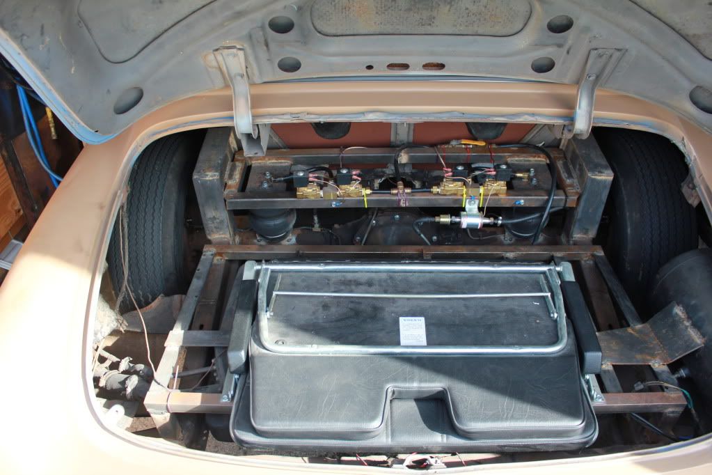

    is that some kind of seat in your trunk?
