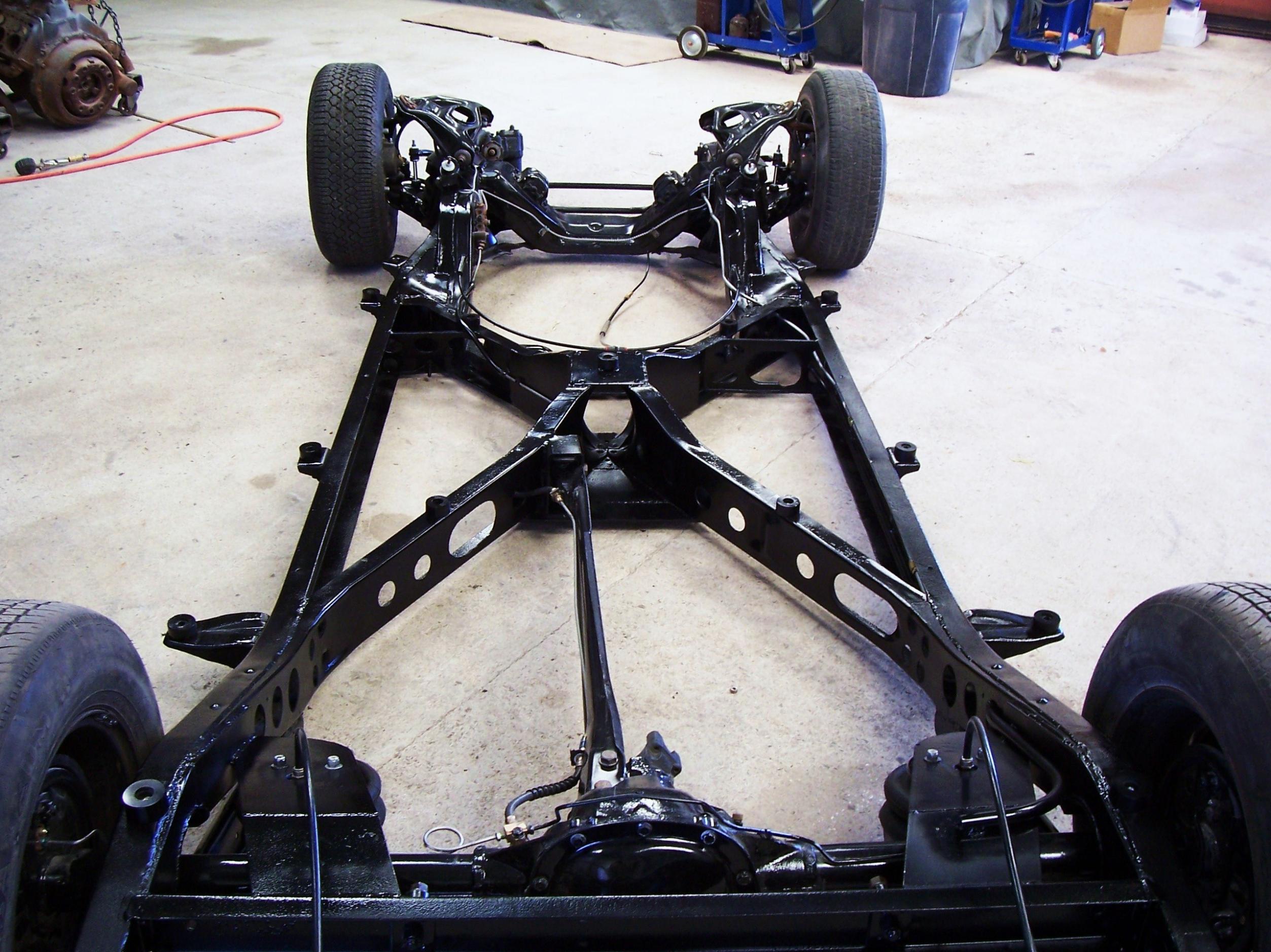

    The short lower arms in a modified torque arm set up like his picture do nothing to control pinion angle, that is done completely by the torque arm, and due to its length, there is very little pinion angle change, about the same as a truck arm set up. The lower arms pivot at the rear axle, as well as the forward mount. I think this could work fine in an air bag set up.
  16. NWRacing
    Joined: Aug 29, 2010
    Posts: 124
    NWRacing
    Hotroddin is correct the short links set your wheel base and keep the axle square to the center line the torque arm sets the pinion angle and the ppanhard or watts link centers it side to side.
    The only difficulty I see with the short arms would be lengthening the wheel base when the car is slamed or binding the drrive shaft whe all the way up

    This is a great example of how you should due your Chevy. It's clean, simple, strong and it works well. The only thing I would change is to move the bags from on top of the axle to just in front and down onto the arms to get more travel. If you due that 10 inches of travel would be real easy. The arms on the gray frame are 30" long and are on the short side but due work without any u-joint issues but you need to make sure you have enought drive shaft yoke movement
    A 3 link tork arm setup is the best of all but is also the hardest to do but can be done
