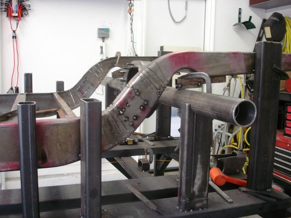

    Hey everyone. I've been lurking for a long time, but now i'm knuckle-deep in my first project car...and I need some experienced help in choosing a rear suspension setup.
    I'm building a '32 Tudor Sedan and I'm building it to be relatively low. The frame under the doors is set at about 5 1/2" and it is at 6 1/2 inches before the frame kicks up. I'm going to run 30" tires in the rear so i've kicked the frame way up over the 9".
    Sorry for the huge photos...
    I originally wanted to channel the car about 5" and chop it 4 1/2" but, alas, I'm 6'3" 265 and would never fit comfortably. So, i'm opting for only the chop.
    The plan is for a blown BigBlock or a blown Hemi...600-700 horses.
    Now, given my height, i'm trying to retain as much of the floor in the car as possible before kicking it up in the rear. I was going to use a Triangulated 4-bar, but it will royally ruin the floor to make clearance for the top bars.
    Then i thought about a standard 4-Link with a watts but I've heard that they ride nasty on the streets. TRUE??? I need input here please. How do they ride? where can i make improvements?
    Next I thought about a 3-link with a watts; i'm gonna have a tunnel in the car anyway, so big deal if it's a bit taller in the back to clear the third bar. But can they take the horsepower??? Again, I need input here if anyone has used one.
    I'm not building this as a show rod, nor will it be a strip car...I want to drive it all the time and so i need it to work and be as comfortable as possible...and hook that power to the ground.
    Any help and insight would be great.
    Thanks All!!!
    Don
    Oh yeah, I'll be selling the jig when i'm done with it if anyone will be interested. It's in Socal, i'll post more details if anyone is interested.
