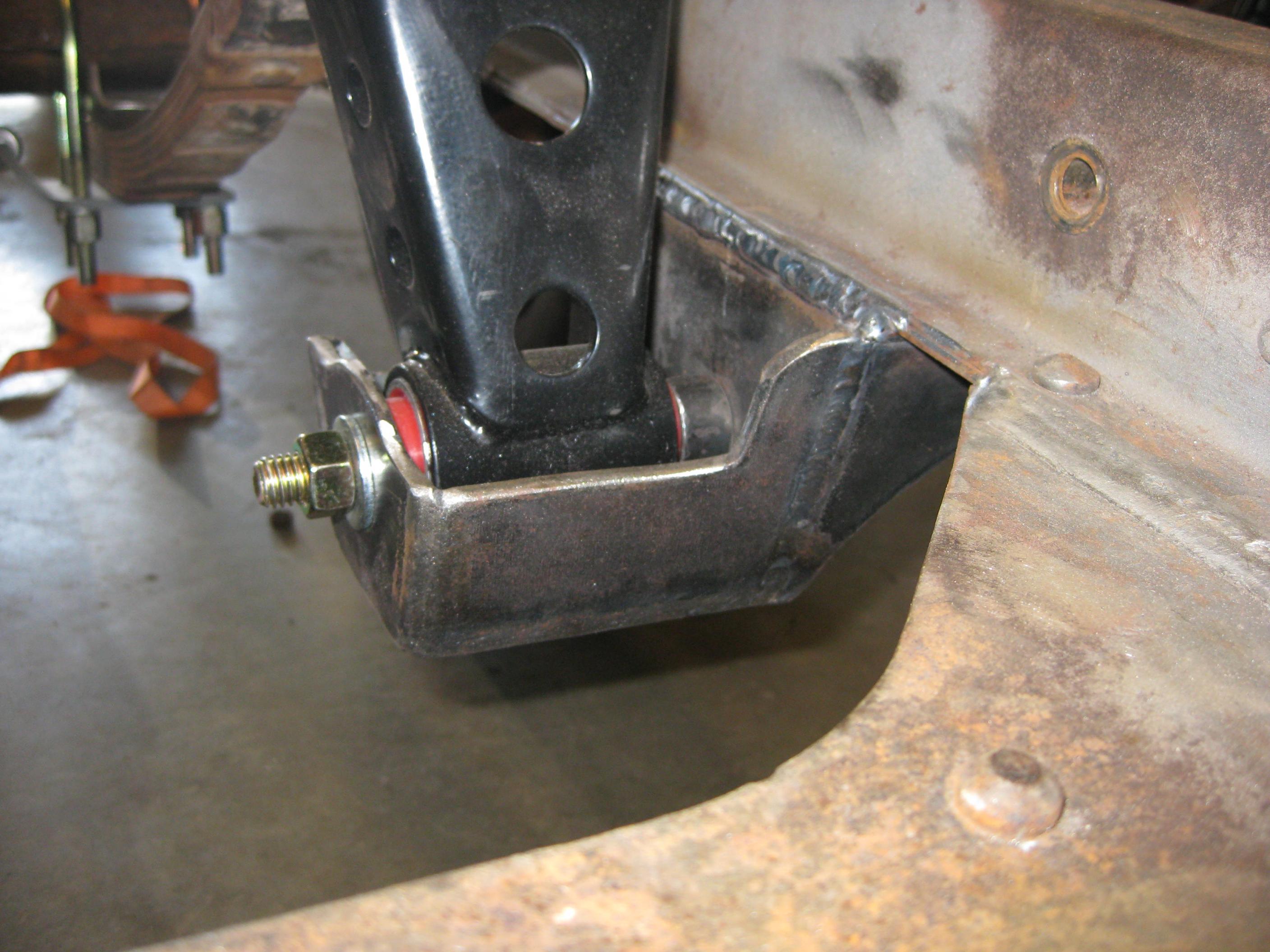

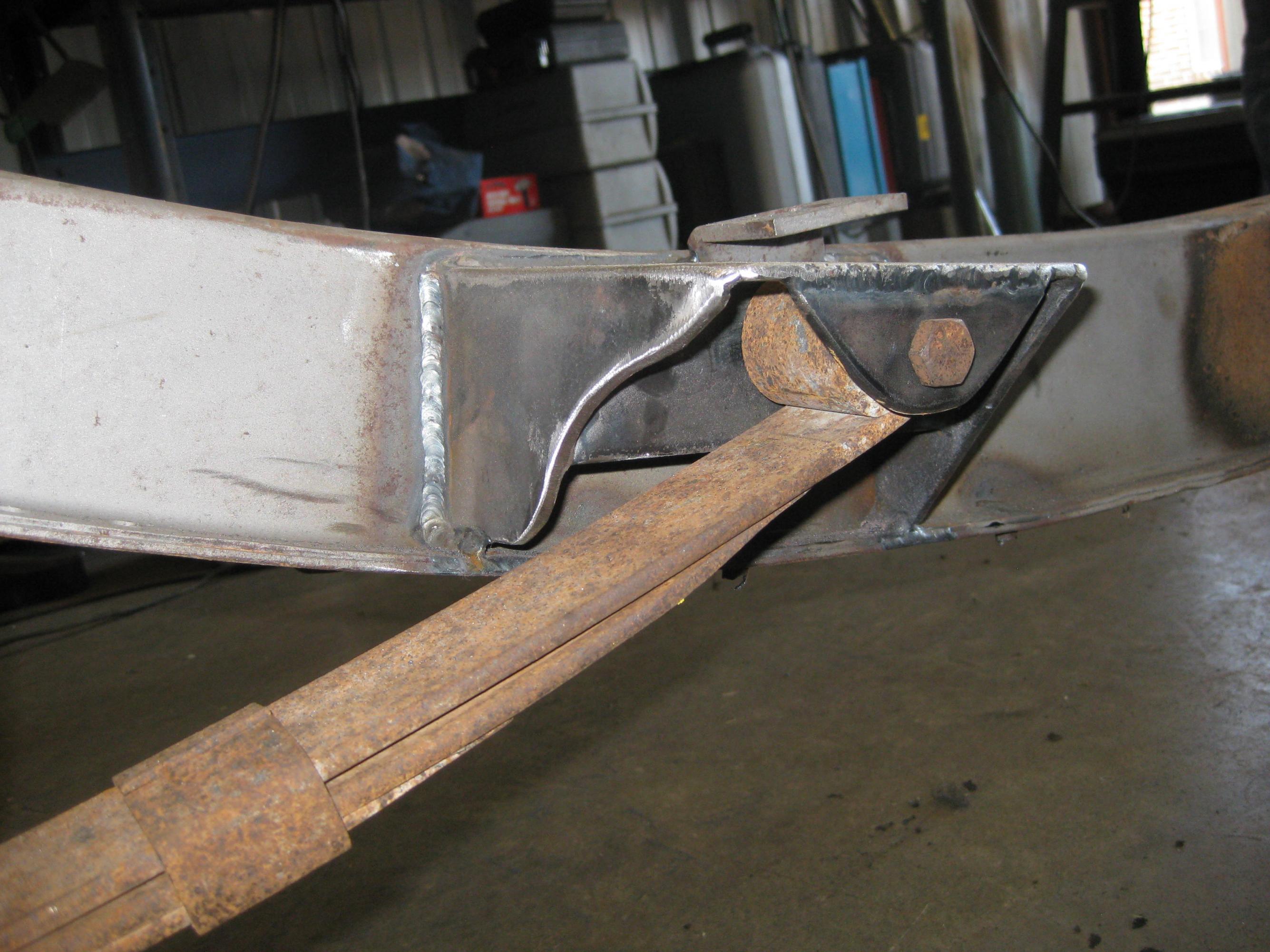

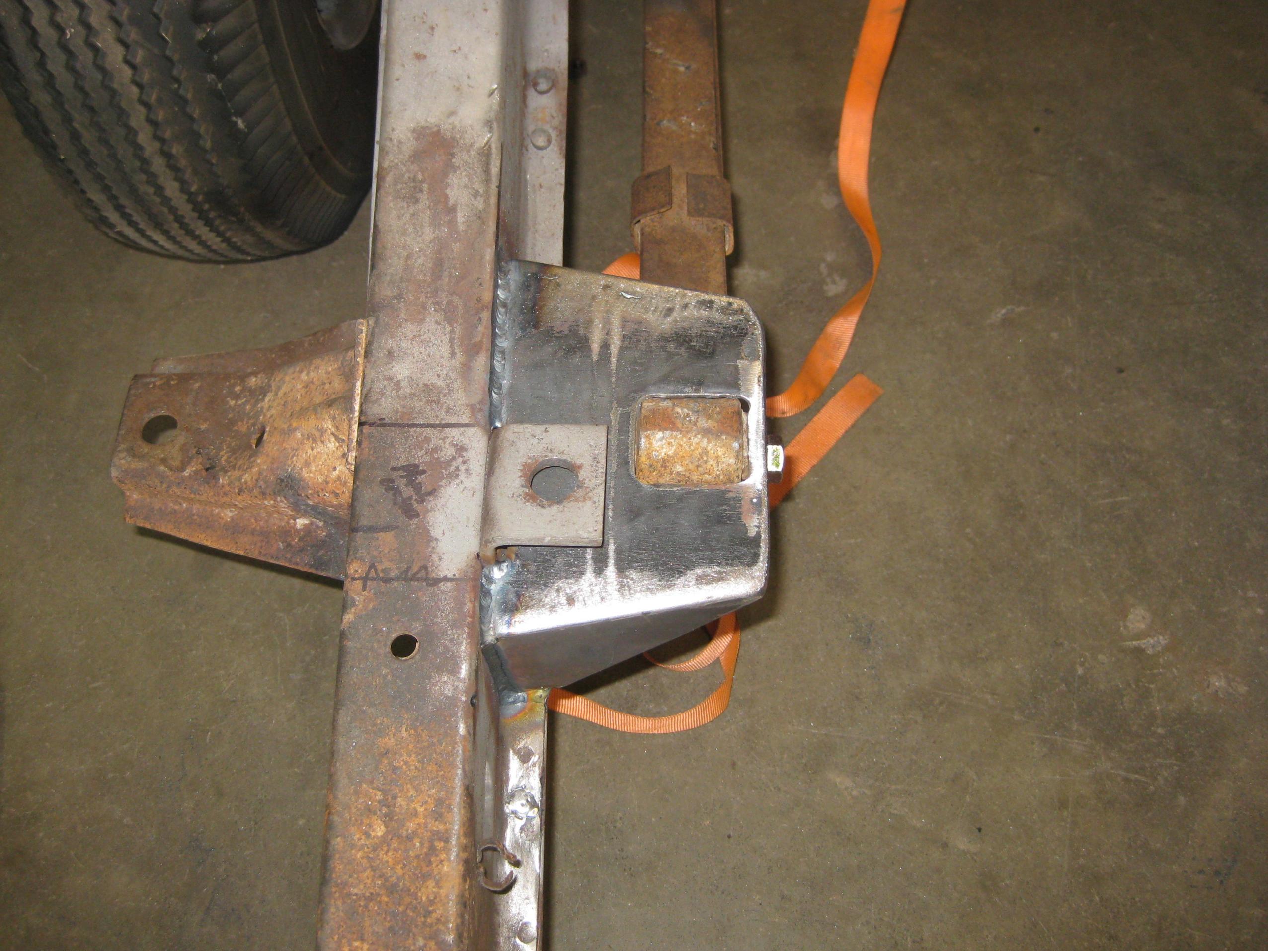

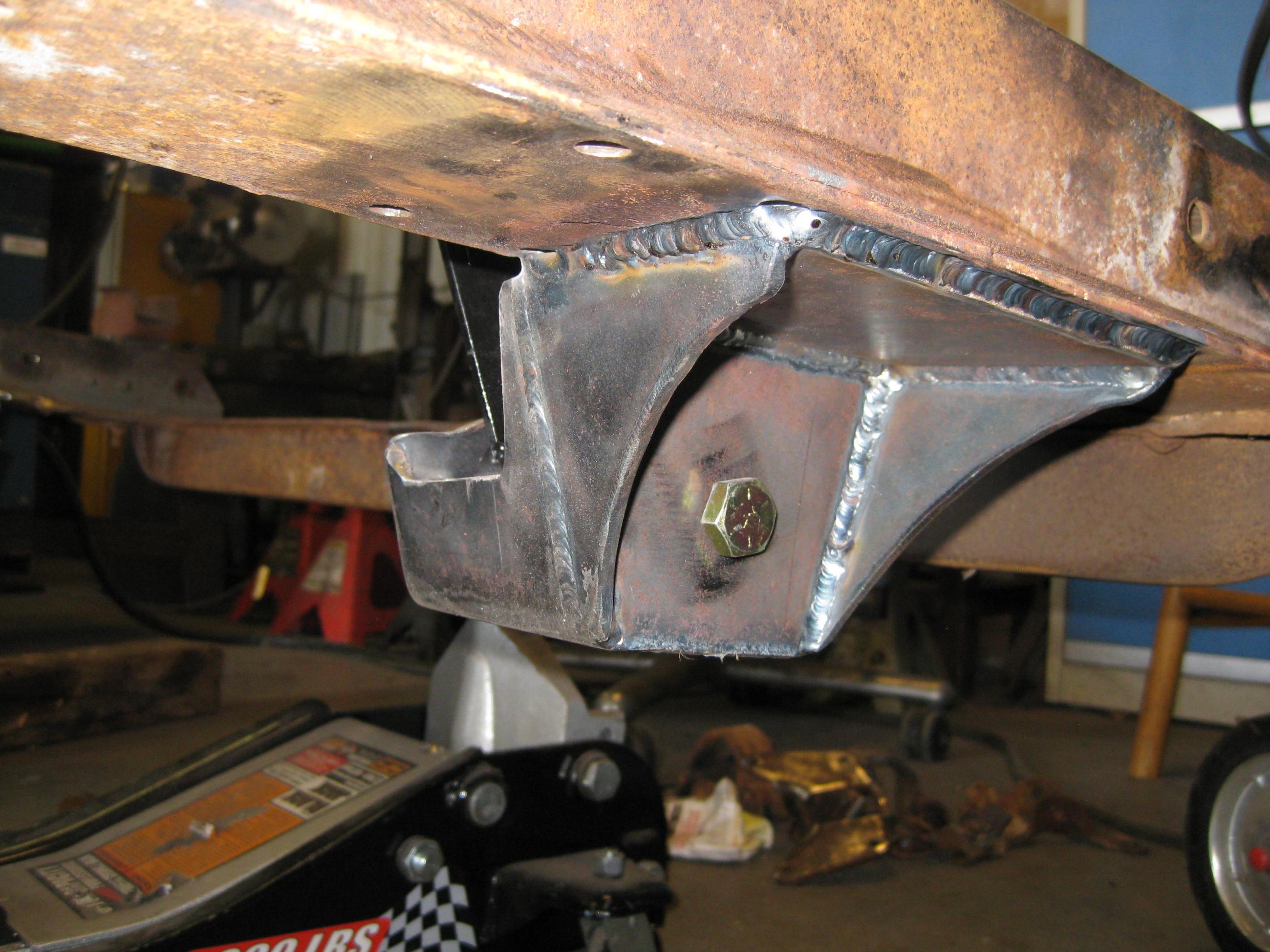

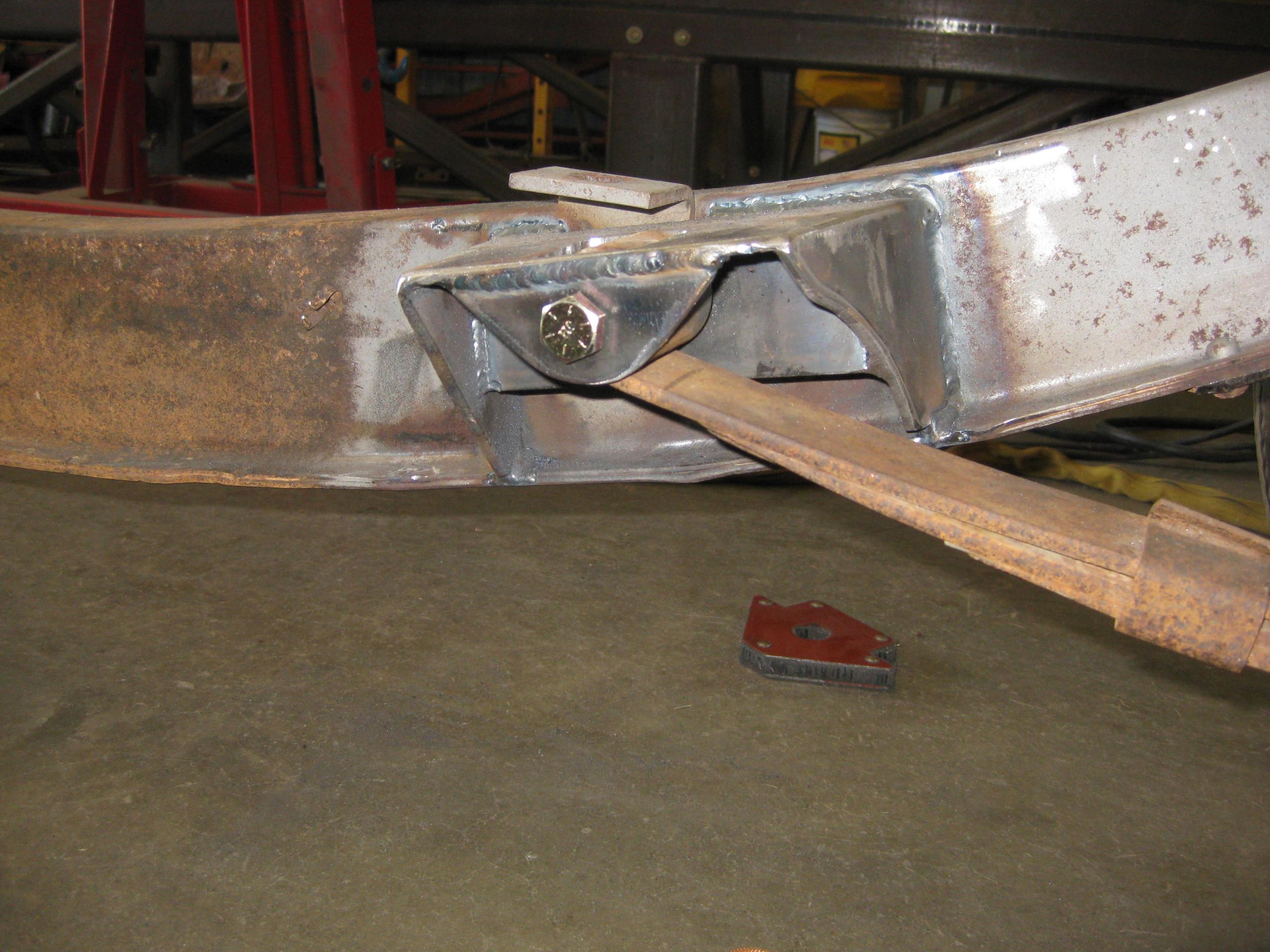

    Here is mine on my 53 Chevy Full Custom.
    On the stock 53 frame the rear spring hangers are on the bottom of the frame. We moved them in and up. This plus a Gambino notch kit and a set of Posies Super Slide 3 Inch drop leaf springs brought the rear down a total of over 8 inches, possibly a bit more. It also maintained full suspension travel. Plus with the the rear shackle choice I can adjust it up or down as need be.
    Here are the pics.

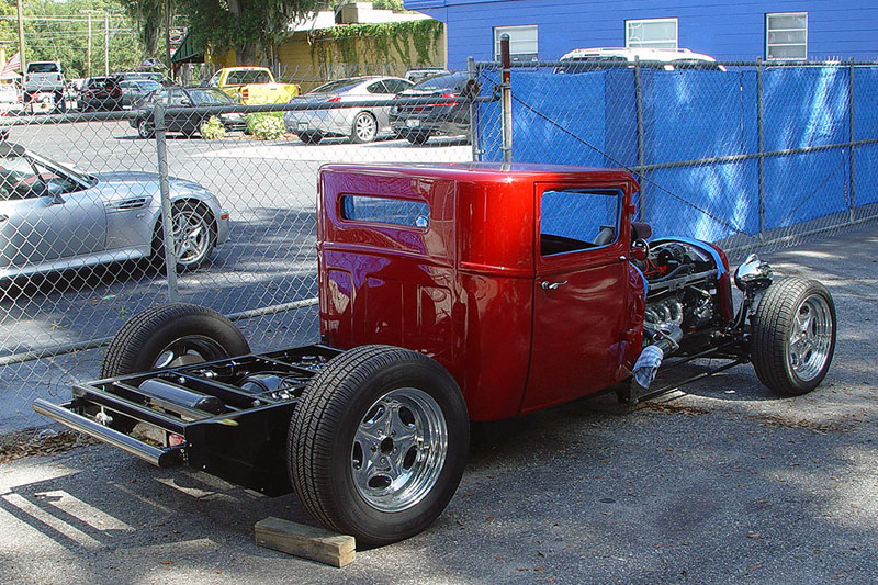

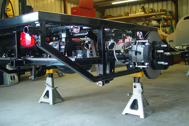

    From the proverbial trying to pack 10 lbs into a 5 lb package school of chassis building. But it did fit. Gary
  21. Damn gnichols thats very impressive. Shame you gotta cover it with a bed
