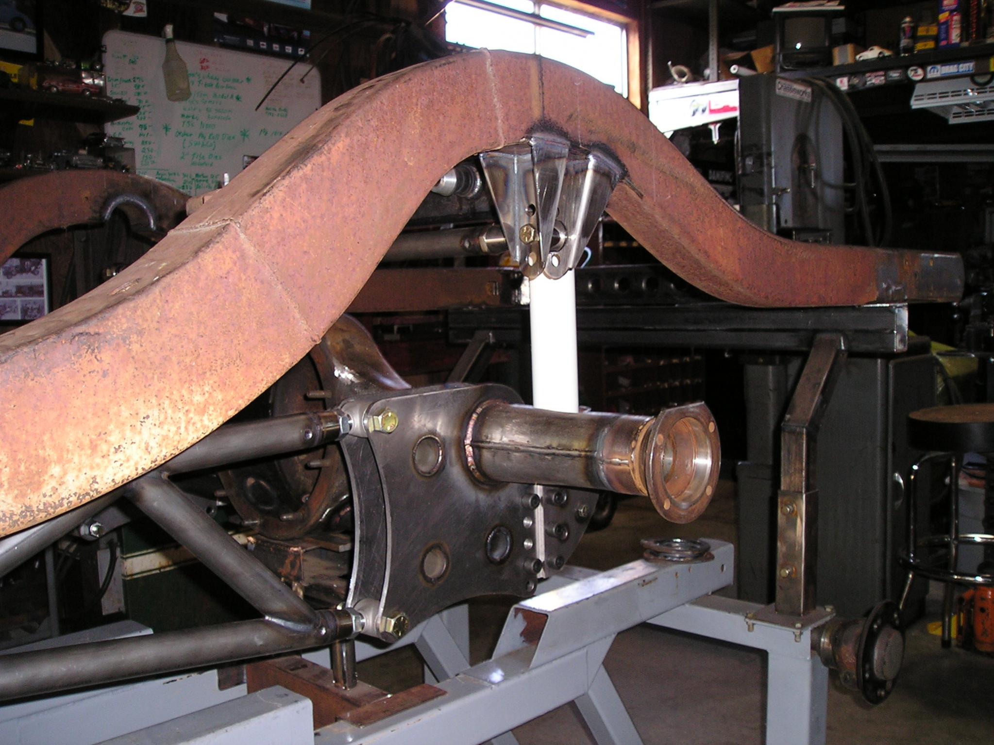

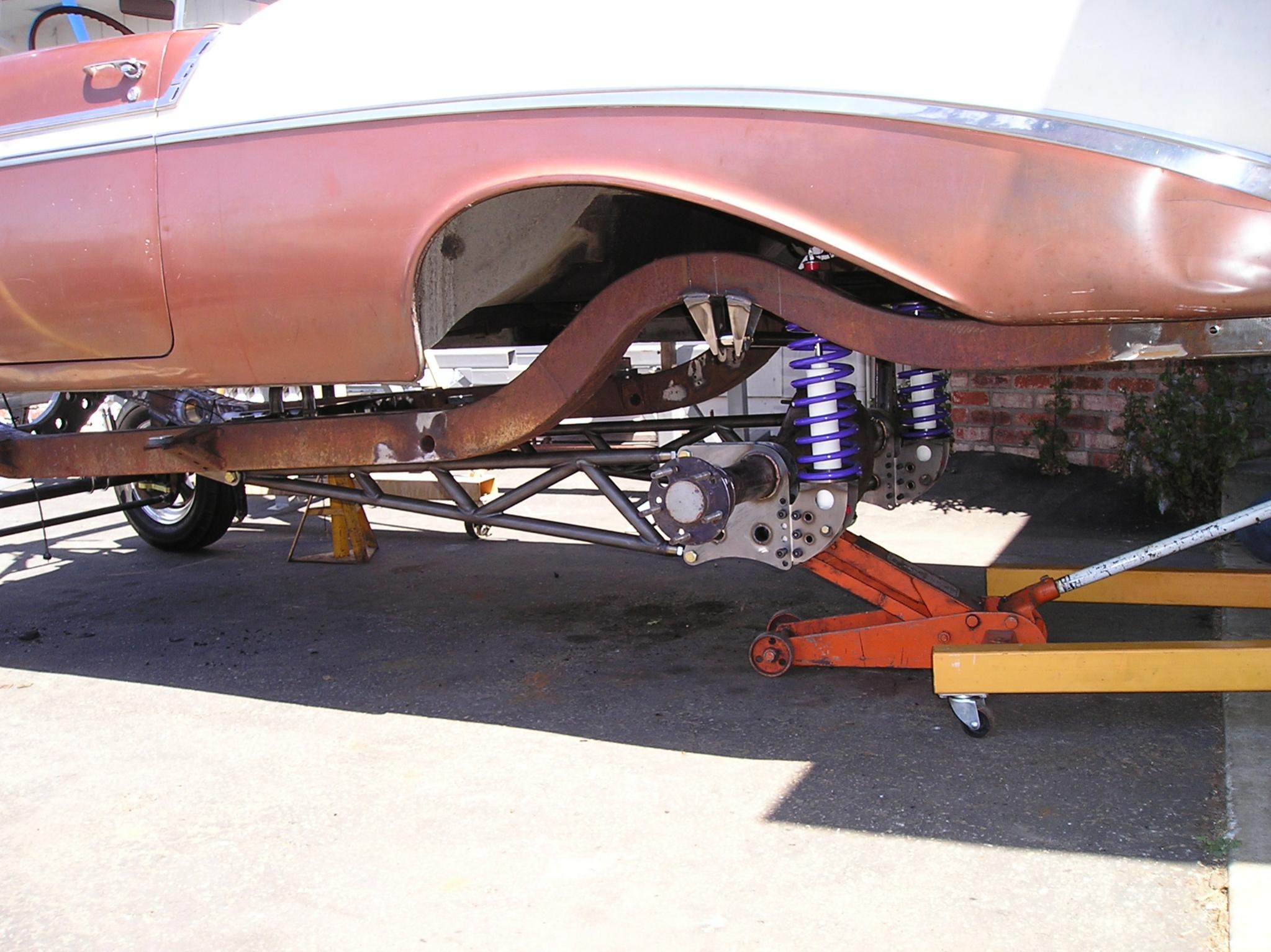

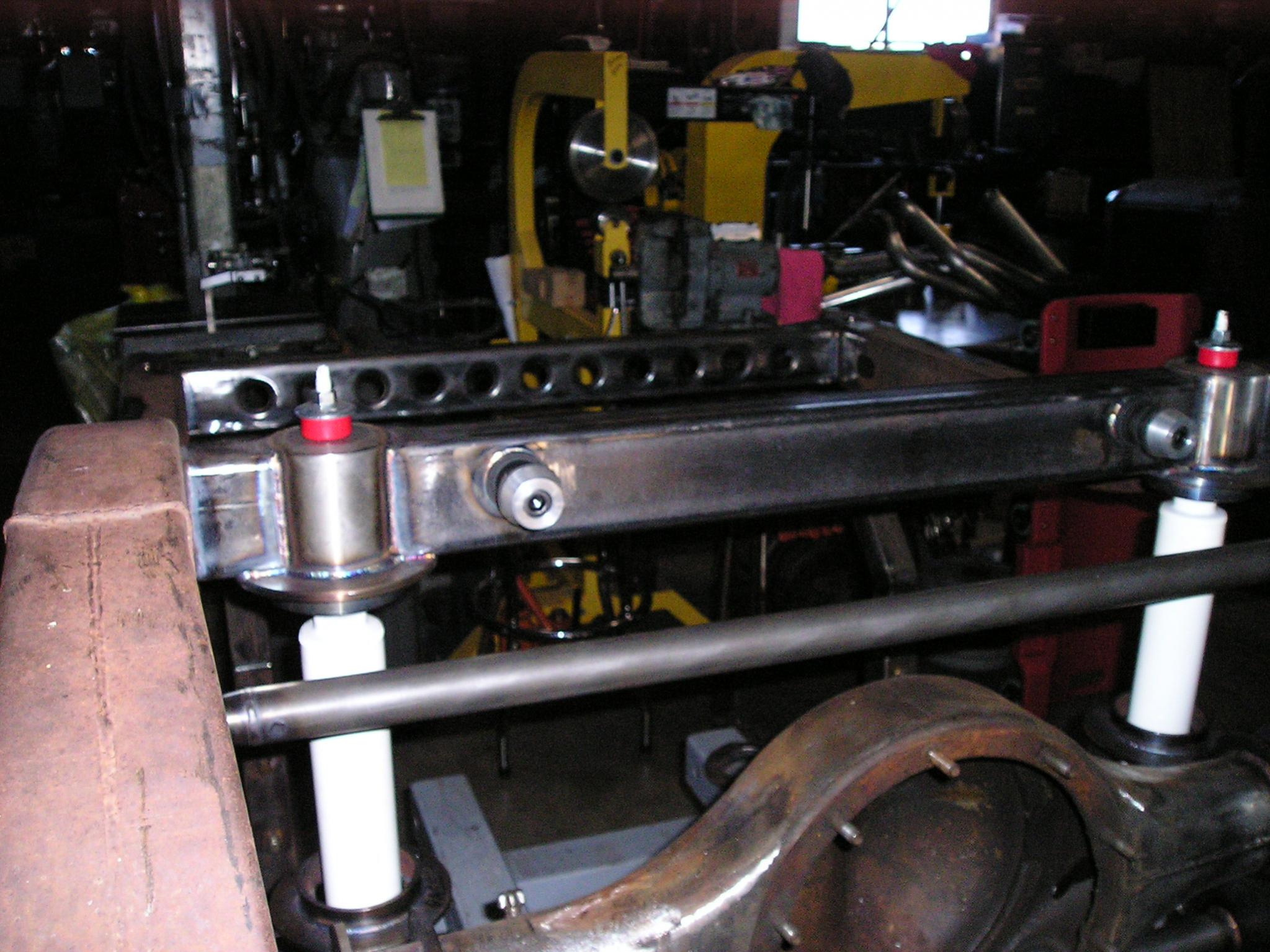

    modified satchell link in a 60 wagon I'm building.

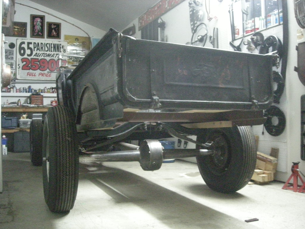

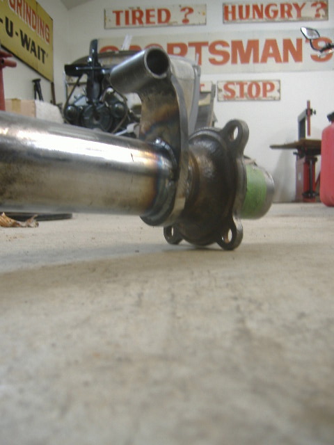

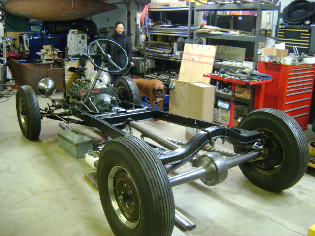

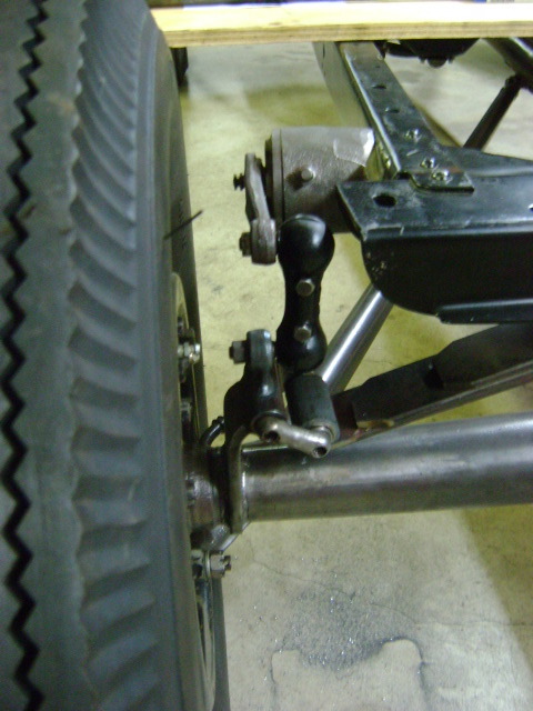

  10. Nothing fancy here just a bunch of miscellaneous Old Ford parts gathered up from friends, swap meets and backyards with set of modified "over the counter" spring perches added. EVERY external piece has been cut, welded, machined, heated, bent or otherwise modified.
    35/36 Banjo housing, new bearings, new 3:54 gears, new outer wheel bearing races, weld on P&J spring perches that have been pie cut and the inner radius tightened up to fit the banjo housing.
    33/34 Torque tube and drive-shaft shortened and mated to a new pinion coupling sleeve.
    T rear spring, stock height with the eyes re-rolled backwards and spring length trimmed 1" on either end. Model A shackles with custom machined spacers to fit T spring.
    46/48 Radius rods heated and tweaked just a bit to line up with the slimmer early torque tube and narrower early axle housings.
    40 Ford front shocks mated with 33/34 dog bone links to 35/36 shock arm eyes welded to the perches.
    The drag link has been adjusted to correct the steering wheel orientation now...

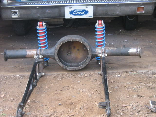

    heres mine, 9in ladder bar, coilovers.

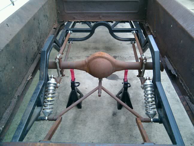

    Here's mine on my g***er project. Nothing really exotic, and my first attempt at anything other than parallel leafs. Used a pair of 2nd hand Jag coilovers and a pair of JEG's ladder bars and a universal panhard bar.
