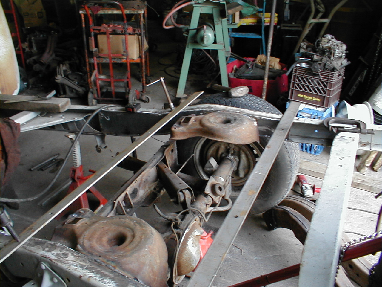

    Year 2000 rear end installation of a 1977 El Camino rear end in to the
    frame of a 1954 Chevy Pick Up. Work was completed over a couple of months. Other pictures in my album. Sorry, this is the best almost finished picture I have.

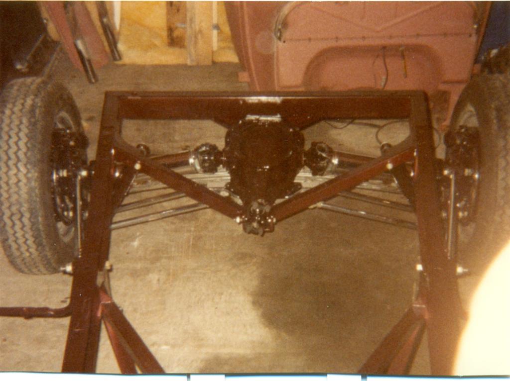

    Mine.built 30 yrs ago

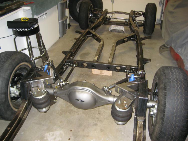

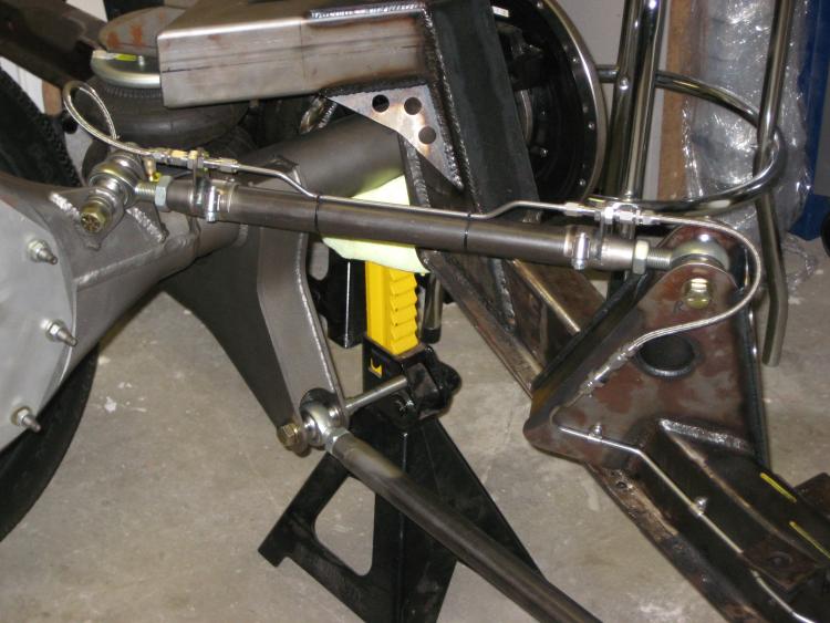

    Ford 9-inch, 4.56 Richmond, Moser nodular iron case, Moser steel spool, Moser 40-spline alloy axles, Fully-braced, narrowed and powdercoated housing

    Damn All American thats a sweet looking set up looks like you can dial her in nicely.
