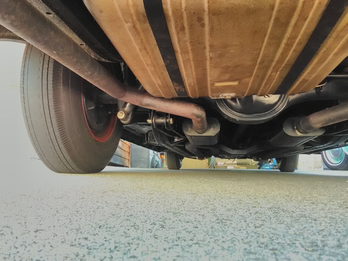

  2. Andy
    Joined: Nov 17, 2002
    Posts: 5,350
    Andy
    I guess the left side bar that GM used was due to space considerations.
    I put the left side bar the same distance out so the front bushings would be loaded the same.
    The length and off set of the bars is all a compromise an not that critical.
    Having the spring behind the axle produces a lift on the right side without any engine torque.
    The left wheel wants to unload some during braking.
    The newer instalations have a bar from the spring to the pivot and the axle pivoting. This eleminates the above problems. I never felt anything odd with what I am running.
