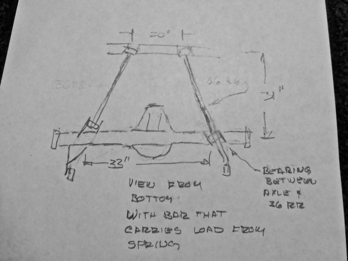

    Some sketches.
    I show the design used in my roadster and some others.
    There is also the design that carries the spring load on the left thru and not have the right side see the small moment caused by the spring behind the axle.

  19. Hnstray
    Joined: Aug 23, 2009
    Posts: 12,355
    Hnstray
    from Quincy, IL
    Andy,
    thanks for the drawings!
    Ray
  20. I'm still waiting to see something magic. At least all this smoke has lead me to believe there is some ancient mystical knowledge. It's like trying to pin down WTF ancient secret knowledge Rosicrucians actually possess. If any.
    So far I see a P&J ladder bar and a version of 60's Galaxie suspension.

  21. Andy
    Joined: Nov 17, 2002
    Posts: 5,350
    Andy
    It is magic.
    It balances the load on the rear tires and eliminates body roll from engine torque plus is simple and is compact and is free to move without binding.
    What features do you need?
    Hnstray and AHotRod like this.

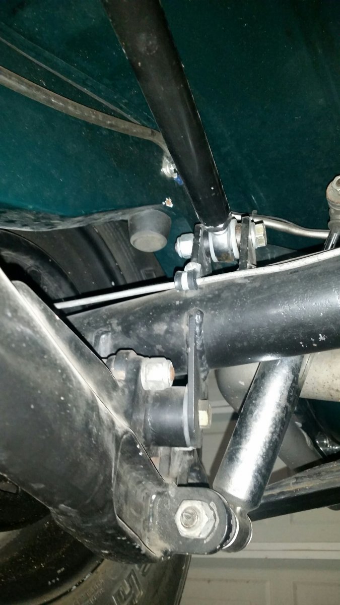

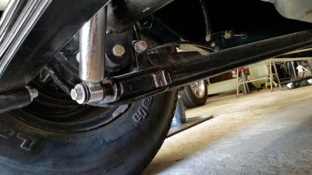

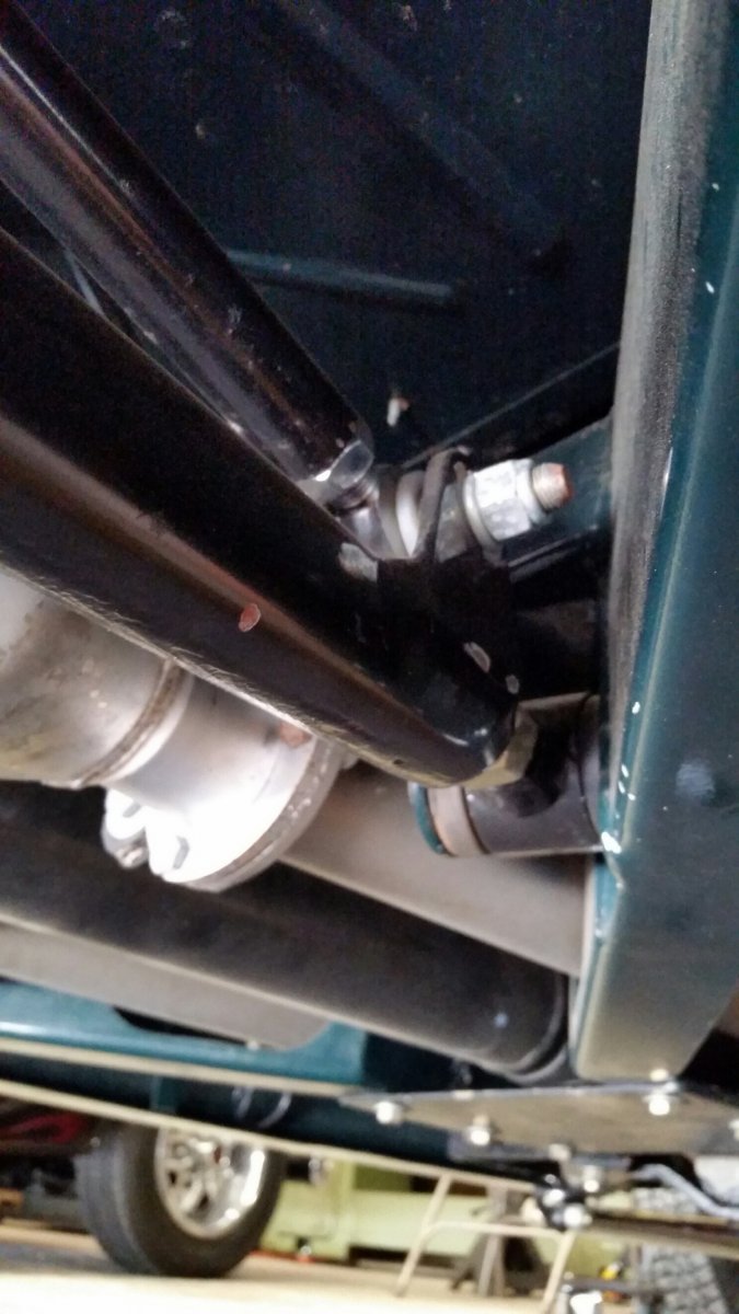

    20170704_085729_resized.jpg 20170704_085910_resized.jpg 20170704_091410_resized.jpg 20170704_090110_resized.jpg
    Here are some pictures of my 3 link setup that Andy and I designed for my roadster around 10 years ago. It uses '36 bars for the lower link. The first pic is how the lower bar mounts to the axle on the drivers side. Same thing on the passenger side. There is a large rubber bushing in mount tube that lets it move without binding. Second picture shows the pass side where you can see the upper third arm. Third pic shows the pass side where the links mount to the axle. I originally used the crappy urethane bushed ends you can purchase through any hot rod shop on the upper arm.. They only lasted a short while. Replaced them with industrial rod ends. You can also see the tube with the rubber bushing in it. The last pic shows the front of the lower link and how the upper link is connected to the lower link and the Chevy II type rubber bushings in a tube Andy mentions. I have close to 20K miles on this setup and it works great.
    It is not so much magic but sound engineering principles. And it is simple. Andy needs to be given credit for thinking out of the box and doing something different.
    Andy and Hnstray like this.
