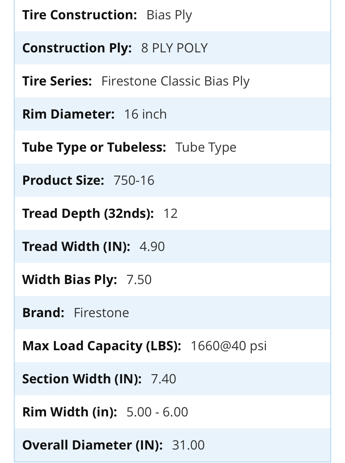

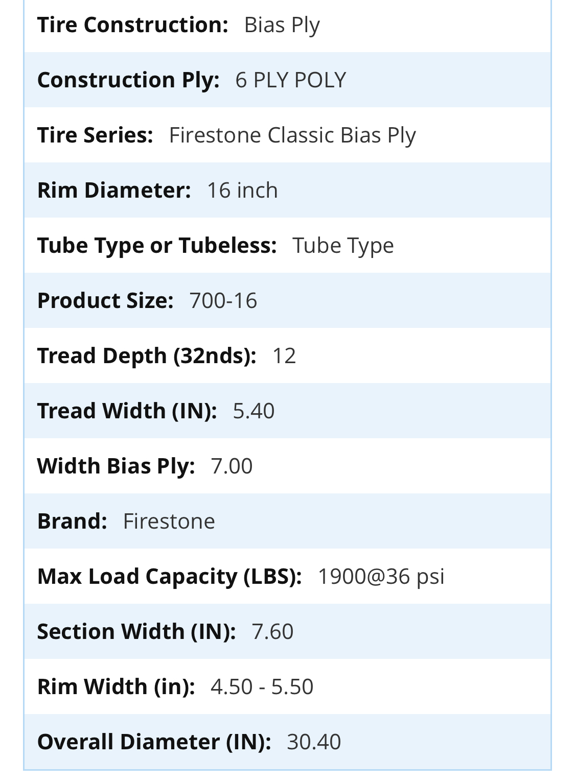

    I’m building a ‘32 Ford roadster prewar style, but about 1-1/4 lower than stock suspension height.
    I run 5.50-16 on the front and I’m hesitating between 7.00-16 and 7.50-16 for the rear ones.
    According the Coker specs. the 7.50 is taller but also narrower.
    Can you post some pictures of yours to help me in my choice ?

    Chatting to people at Pendine it would seem those in the know prefer a 7.00. Wider tread and not a truck tyre. 7.50s were traditionally a truck tyre. That's what I was told anyway.

    0.6” equates to your car sitting around 0.3” lower at the rear, - thats about 8mm to those using metric.
