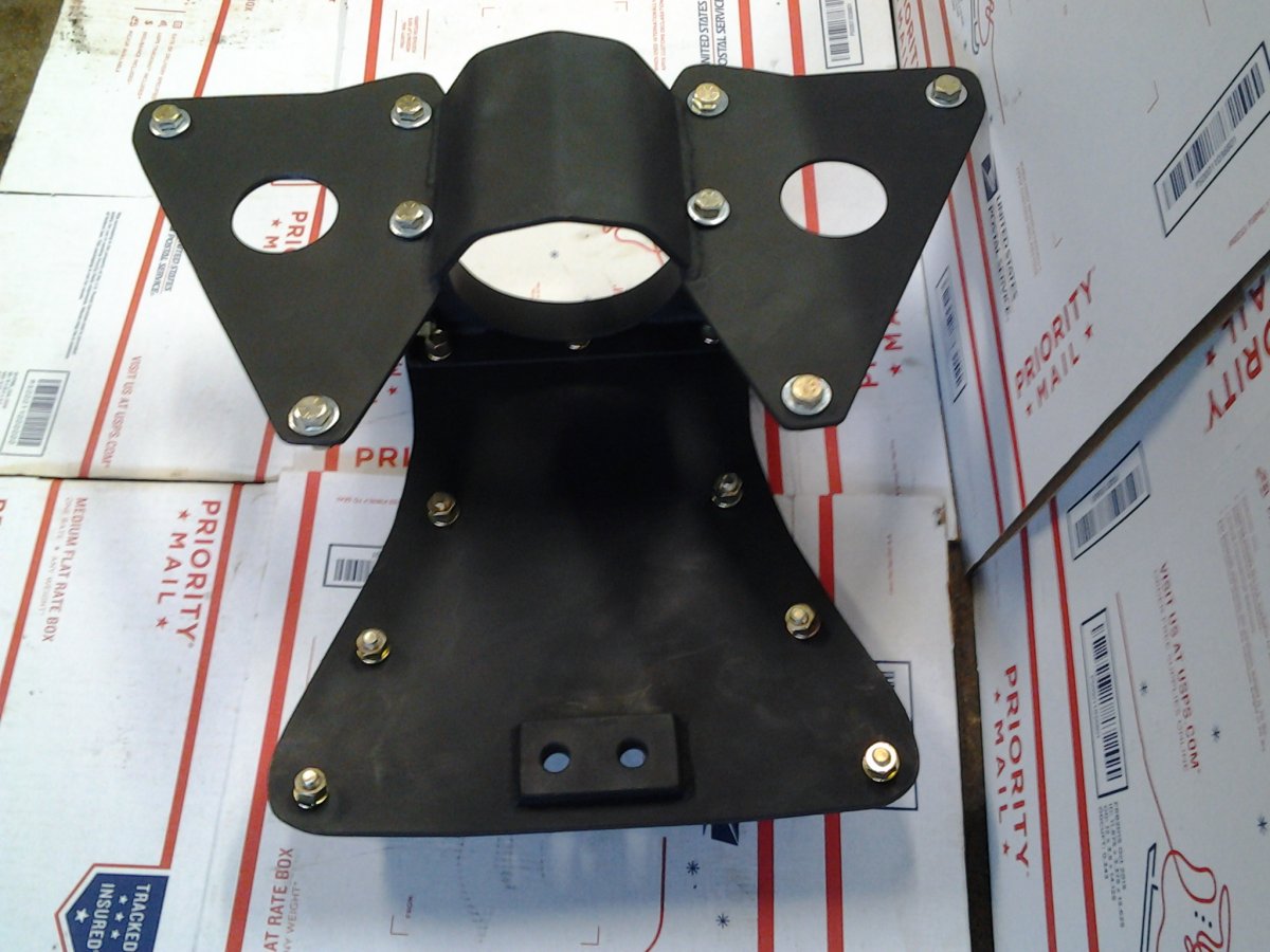

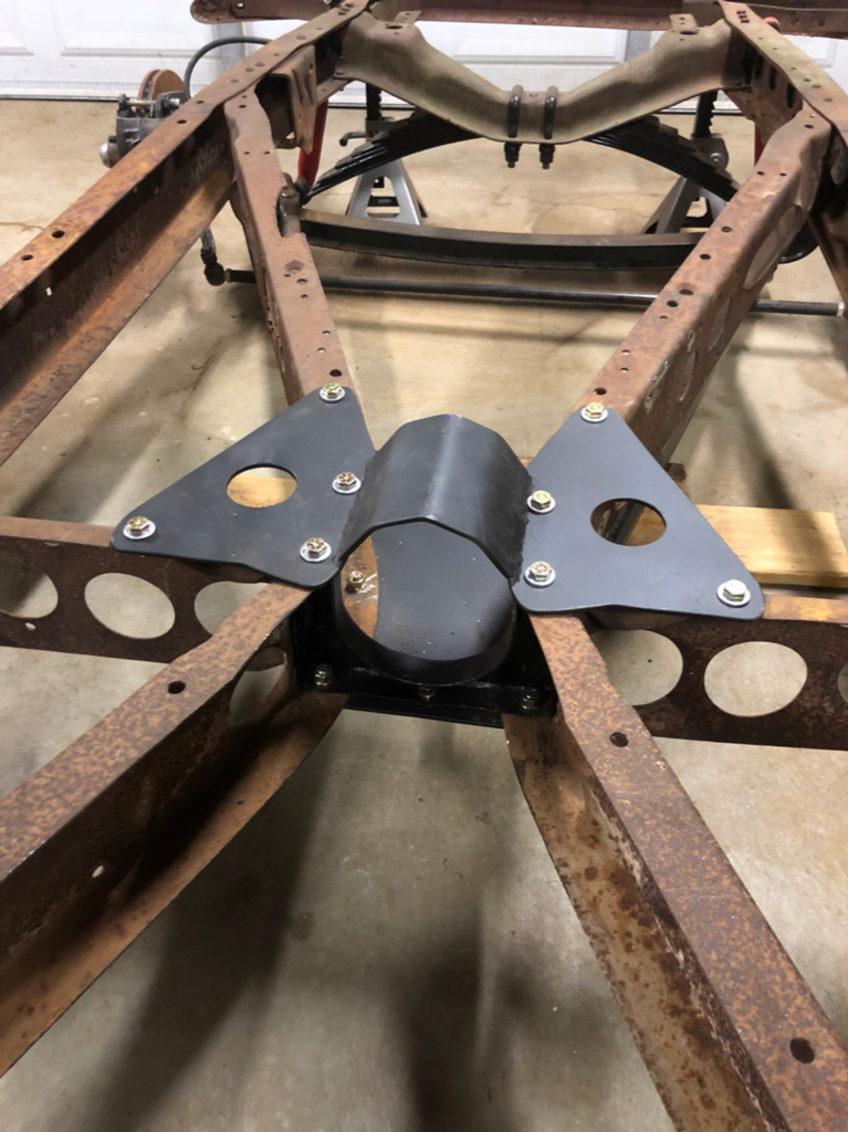

    This is what we use. Just drill the stock rivets out to 3/8" and bolt them in. 87ed96bc5b4f93953ccf98734f3b4bff (1) (1) (3).jpg 26a55560ae34515169ce00caab98d842 (1) (3).jpg 20161030_145043 (1) (1) (1) (3).jpg 20161030_145649 (3).jpg

  7. Bob Bagley
    Joined: Aug 26, 2019
    Posts: 105
    Bob Bagley
    Perfect, thanks a lot.
