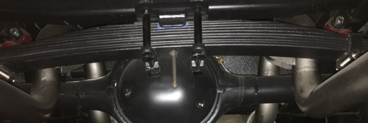

    Doesn't show to well, but you can just see the shackles poking down on each side. Spring mounts from Welder Series on the axle. Rear X-member is a straight tube with the spring mounted under it. Top of spring was approximately 2" above the top of original frame. 3" up travel on each side.
    Spring is 41 Merc front with full pack minus the little short one. Leaves smoothed and polished and treated with a special graphite coating between each leaf. Shocks are So-Cal.
    Ride was decent for a Model A and still bottomed out on bad bumps (common here on our roads), needs that missing leaf. for 1/4" more lift.

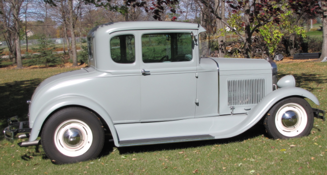

  7. I have to get my tape measure out, could possibly do it tomorrow. This is what the car looks like. 20160728_192149.jpg
    bct likes this.

    33700_1637201254161_6344287_n.jpg 66375_1634120457143_7756511_n.jpg This is a fairly easy fab if you have basic welding skills.
    bct likes this.
