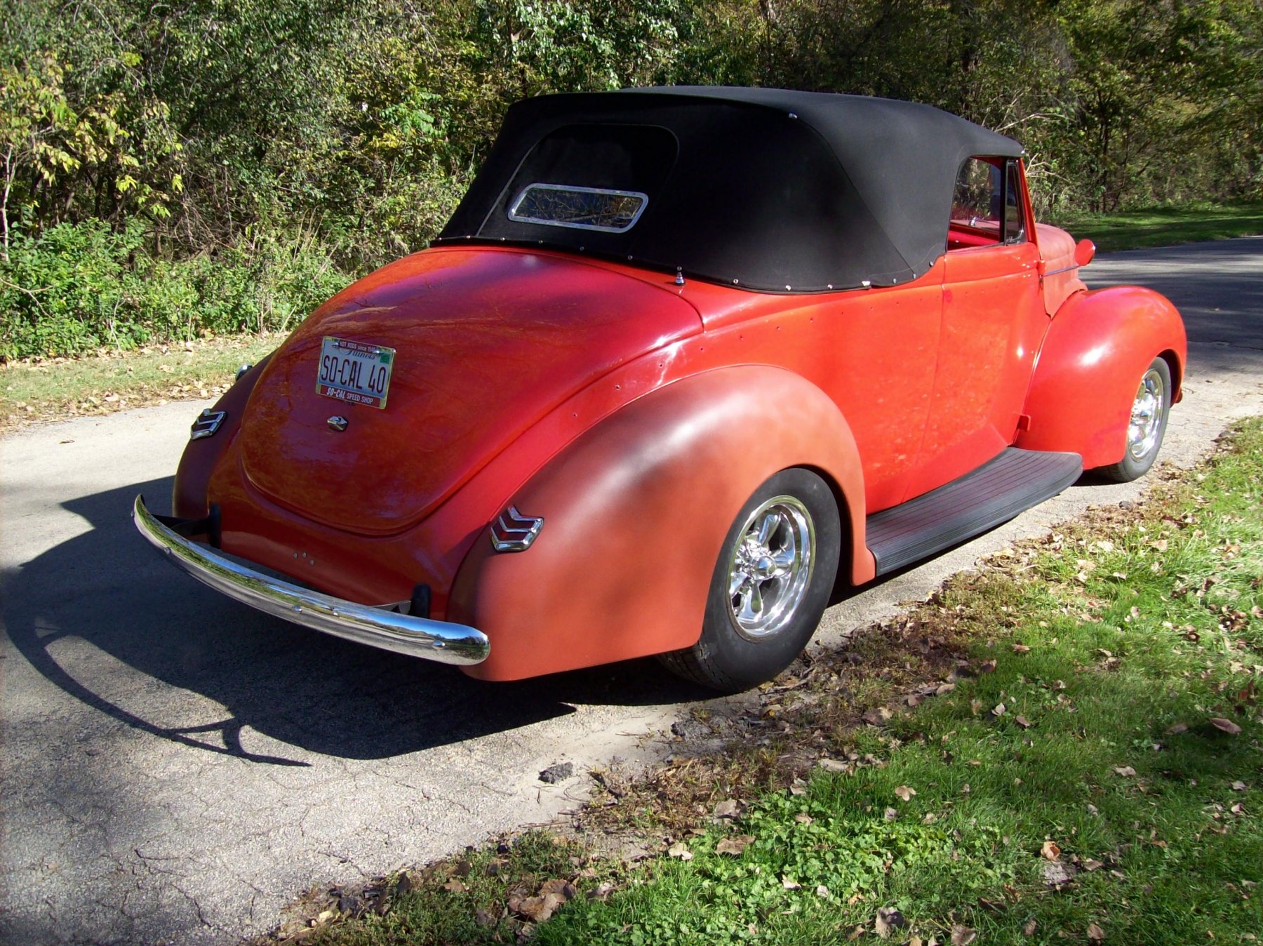

    as weedburner 40 said go with a 15 x 7 4 inch backspace. you can get vintique gennie 15 x 7 4 inch back of the shelf from jegs. with the gennie you can use stock hubcaps. with 4 inch you should have room for a 235 75 15 tire. 40 convert build 008.JPG

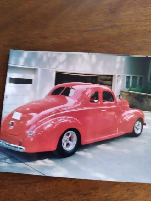

    some more of my old 40s . got my ist 40 when I was 13. had 2 40 sedans 2 40 coupes 3 40 converts all 235 75 15 1940 ford coupe july 1 2014 004.JPG 079.JPG thumbnail_Resized_20200914_183131.jpg
