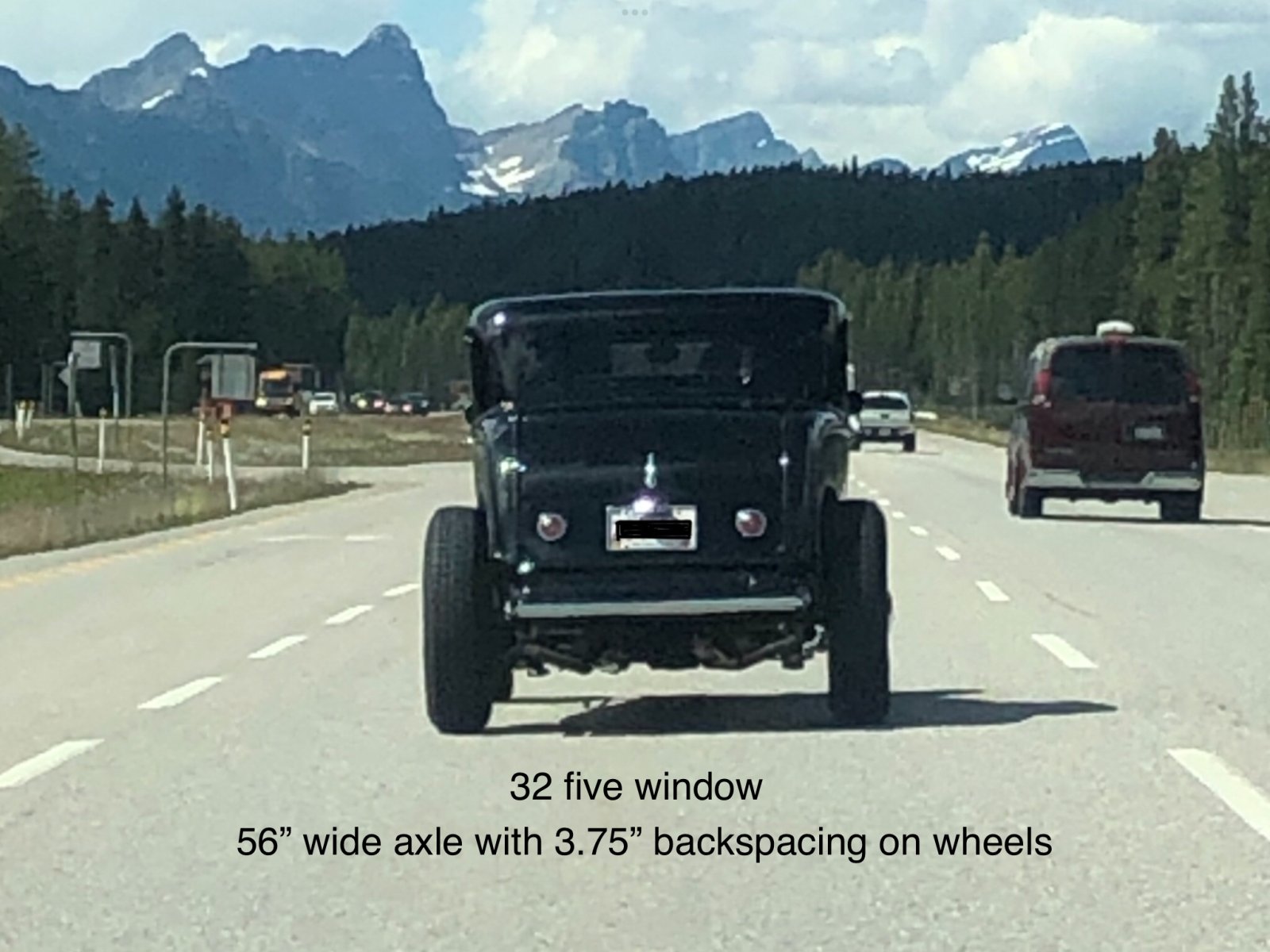

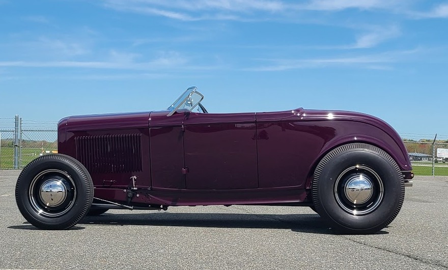

    Here’s a pic of a 5W with what I think is the perfect width for tires on a 32 highboy. Center of tire to center of tire was approx 55.5” (and they were the 750-16 tires).
    Vic Walter, billyt, Baron and 3 others like this.

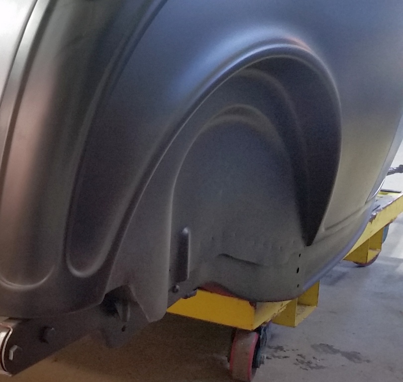

    I have found the roadster body has more of a flare on the reveal then the coupes. No spacer needed with the 6 inch wheels as the tire bulge was less on the wider wheels.

    Couperear quarter vs Rdstr rear quarter. Quarter panel coupe.jpg Rdstr panel quarter.jpg
    Vic Walter likes this.

    Just to add a little more confusion, here's my car with 15 x 5's and 15 x 8's. Always nice when you can totally change the personalty of a car with a simple wheel change. 20211002_181848 (1).jpg
    Vic Walter, billyt, Happydaze and 2 others like this.

    Baron,
    Your roadster with the new Halibrands is just awsome.
