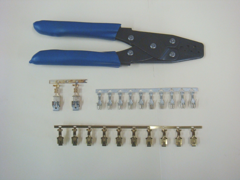

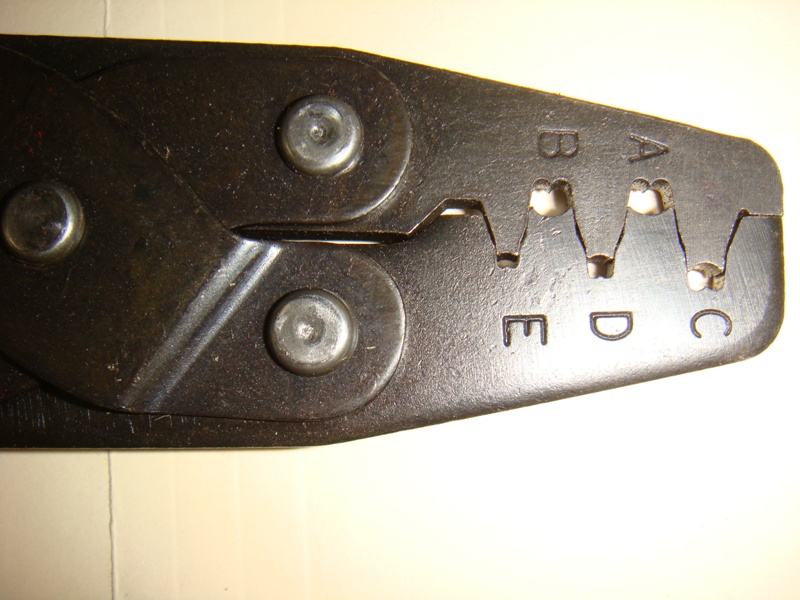

    Bought this crimping tool to use on the connecters that came with my wiring harness.
    The nose of the tool has letters by the different sizes of crimps
    How do you know which connecter fits which crimp?
    I know that this tools will not crimp the two large connecters in the photo that are for the 50 amp fuse. I plan on using more of these connecters than came with the harness kit. Is there a chart on line for this info?
    Thanks in advance for any help.

    Most of those terminals in the picture are going to be 14-16ga. With that crimper you'll have to crimp once around the copper and once around the insulation. Unless the crimpers came with some paperwork showing letters to wire size it will probably take some trial and error. The die for the insulation side will probably be a little larger than the die for the copper wire. You may just have to feel it out and see which die fits better, and you might have to get them started by closing up the terminal a little before crimping it
