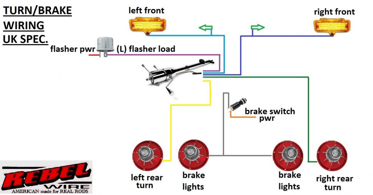

  22. Hi Rebel43, I have your most basic loom kit for use in my 27T Modified. Over here in the UK we need separate indicator/turn lights (coloured orange) and brake lights (coloured red). Any tips on how best to separate them out. I will be using a mechnical switch on the pedal and taking a spare ignition live from somewhere near the fuse box panel.

  26. REBEL43
    Joined: Feb 17, 2007
    Posts: 722
    REBEL43
    from TENNESSEE
    The 16 circuit would probably be a good fit. Relay your fans, and just trigger them off of the fuse panel. The fuel pump probably won't need to be relayed, unless you wanted to run a safety switch, or unless it is some type of high amp draw pump. If it's just a low pressure pump and doesn't need to be relayed, you can use the orange accessory wire in the 16 circuit kit (hot in run and start). There's also an electric choke wire that you can use, and if you don't need it, it can be used as a relay trigger for the fans. The MSD will just be powered off of the coil wire in the harness. Let me know if you need anything else. Sorry guys, I didn't get any notifications on these new posts and just caught them when helping someone else.
    mad mikey likes this.
  27. REBEL43
    Posts: 722
    REBEL43
    from TENNESSEE
    Really sorry I missed this, for some reason I didn't get a notification there were new posts. If you're running LED's (yeah yeah, I know...we don't say LED here) You could use the 18ga orange 3rd brake light wire for the brake lights, and just use the turn signal wires as turn signals. If they're going to be regular incandescent bulbs, I would probably run a new separate 16ga wire from the brake switch back to the brake bulbs. Something like this
