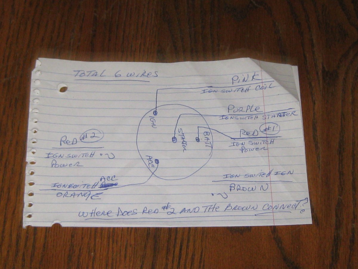

    ..Hi again... I need some help again... I have 6 wires going to the ign. switch, I am sure where 4 of the wires connect, ...and then there are 2 I am not sure where these attach 1 is red which I call #2 and the other is a brown wire....all 6 wires are marked...question is where do the red #2 and the brown connect?....see attach drawing. thanks miller IMG_5718.JPG

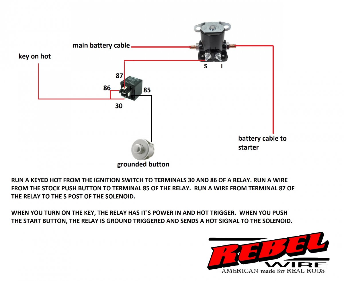

    I hope I'm right here. My memory tells me that the original Ford start ****on switch is a 1 terminal switch that completes the ground circuit for the original Ford solenoid. If you want to use the original Ford start ****on for a GM or more modern Ford solenoid you have to wire in a relay and use the start ****on to complete the ground to energize the relay.
    REBEL43 and olscrounger like this.

    Please note Silva in post 422 is using a two wire GM ****on.
    Phil
  8. You are correct pprather. I didn't notice that the two terminal switch was used when I first read Silva's first post. Just for general knowledge I think it is good to ensure that there is a way to make either switch work and how to tell one switch from another.
    REBEL43 and pprather like this.

    You are correct sir! I happen to have a diagram for that:

    If the labeling is right, the Brown IGN SW IGN would go on the same IGN terminal as the coil. The 2nd Red IGN SW PWR may not be needed if it's just a 2nd battery feed for the switch. Some GM column switches take 2 battery feeds, but looks like your switch just takes 1. Thoughts anyone?

    ...Anyone have and thoughts as to what to do with the red and brown wires? thanks miller

    This is my suggestion. Put the brown wire in the same terminal as the coil wire as Rebel43 suggested. The second red wire could be put in the same terminal as the first red wire.

    ..Thanks for the reply....I was thinking I could do as you suggest, but I did not want to say anything that would confuse the question,.. I will do as you suggest thanks to all for the help....Miller

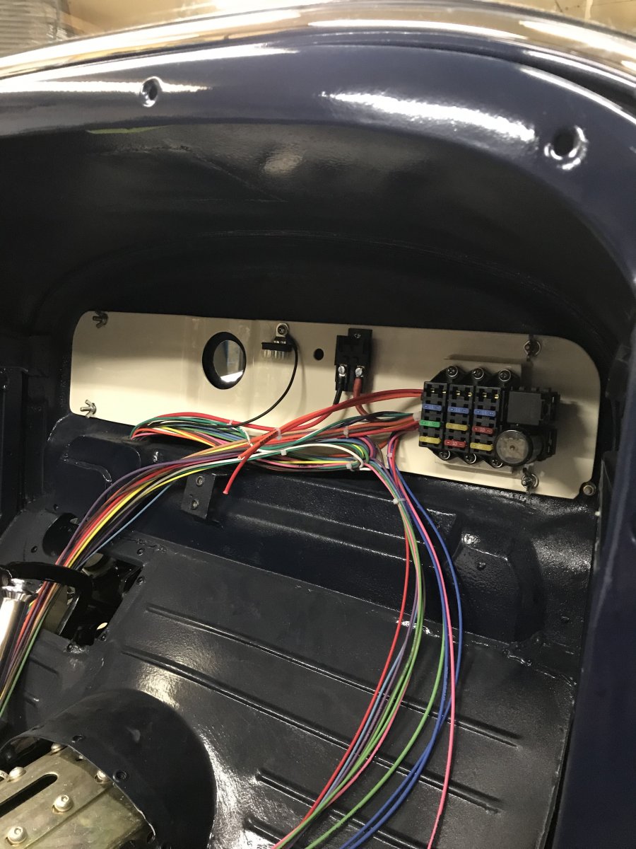

    So, I’m installing my 9&3 kit and I’m wondering if there’s any advantage or disadvantages to cutting the 21 wires that end up going through the grommet on the firewall and mounting terminal blocks to the panel under my dash inside the firewall on the driver’s side.
    My thoughts on it was that if I did that I’d be able to disconnect all those wires to remove the body if I ever decided that I had to.
    Maybe it’s not worth the effort?
    I’ve tried to plan for accessibility for most everything that would make it so the body wouldn’t have to be removed.
    Any thoughts?
    The37Kid likes this.
  16. The37Kid
    Joined: Apr 30, 2004
    Posts: 32,495
    The37Kid
    That is something I think about all the time, how many wires are there, and how large a hole do they require. I'm sure someone will chime in and tell you the wire size is way under sized so what is the proper size wire and hole? Bob

    I've had it both ways. My first rod, built in the 70's was home wired. It had a terminal block at the firewall. It really helped to simplify the front clip removal when I swapped engines
    My current rod built in 06 with a good quality kit has no block at the firewall. When I was talking to my fabricator about a ch***is swap, he said, " we'd just cut up the harness and rewire the car after ***embly.
    I'd seriously consider the block, but it does introduce the possibility of a breakdown at any one of the many connectors. For sure use ring connectors that require screw removal at the block to reduce the chance of a connector slipping off the block.
    I'm sure this post will get some comments, and hopefully some helpful suggestions.
    Phil

    Honestly Larry, I can’t see it being worth the trouble, I can’t imagine having to pull the body anytime soon. As you said, on the off chance that may happen it would be no more difficult to deal with it then
    Cosmo49 and Blue One like this.

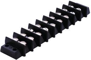

    I wouldn't use a terminal strip I would use some sort of a connector. The Deutsch ones suggested above are usually very highly rated.
    Blue One likes this.

    Most all the wiring ahead of the firewall can be easily disconnected, except maybe the headlights. Easy to unhook the wires, demount the harness, and tie it back in the unlikely case you remove the body. Why over complicate things. Besides; it is just another place for electrical gremlins to get into your life.
