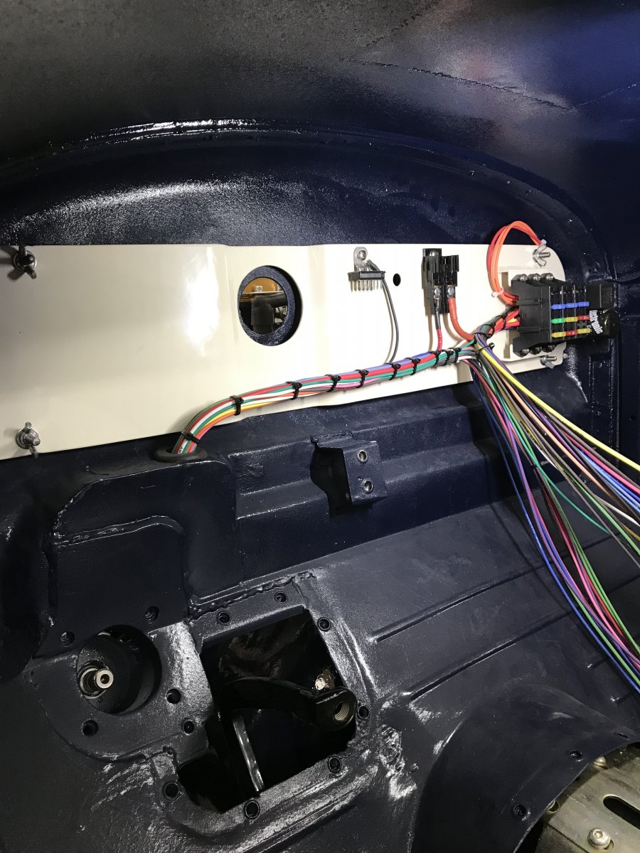

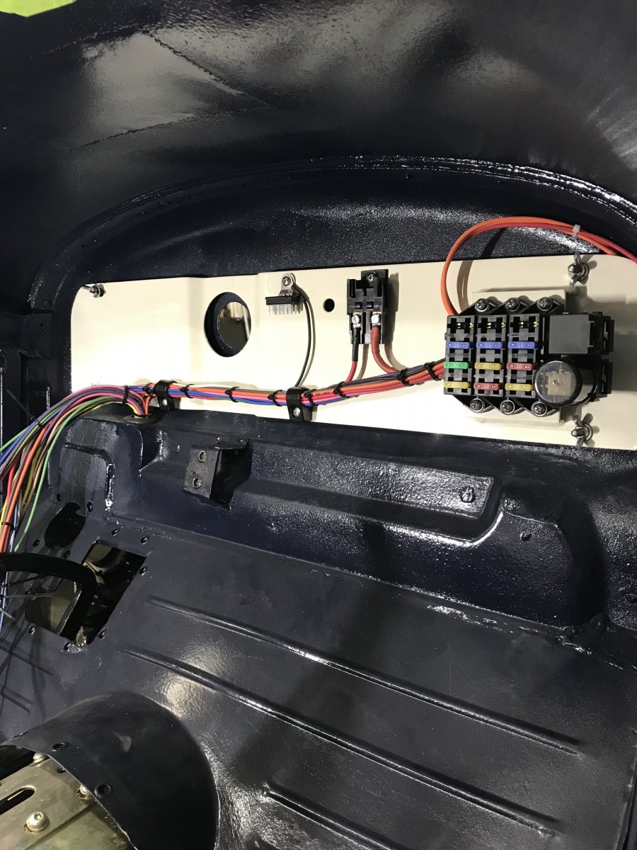

    I'm installing my Rebel 9&3 kit now, Jeremy was great helping me sort things out, and making a few modifications to my kit and tailoring it to my components.
    That along with some extra labeling he did to my wire bundles have really helped make this a good experience.
    One thing I wish I had sorted out was the length of the wires going to the various switches on the dash.
    The kit was designed for the fuse panel to be mounted on the drivers side and as such the wire bundles coming off the panel are long enough.
    Now for the however.
    I decided that since my RPU is so small and cramped, mounting the panel on the p***enger side would make it much more accessible.
    That worked great and required me to re-bundle those wires to get them moved in the harness back to the drivers side.
    As a result, the wires are shorter than they should be to get to some of my switches etc.
    I'm not really sure what to do about it at this time as I don't have any extra wire in the right sizes and colors :confused:
    I'll have to figure something out.
    jakespeed63 likes this.

  22. Blue One
    Joined: Feb 6, 2010
    Posts: 11,509
    Blue One
    from Alberta
    Thanks, I’ll scope it out and make a list and send you a message.
    Splicing is not a big deal if you do it properly, I would have preferred not but this was unforeseen initially.
    I usually do a crimp splice with a uninsulated connector and then glue lined heat shrink it.
    The wires end up not much larger than the regular insulation size.
    Thanks again Jeremy I’ll get back to you.
    Appreciate it.
    Larry

  29. Blue One
    Joined: Feb 6, 2010
    Posts: 11,509
    Blue One
    from Alberta
    Turns out that there are only 3 wires that are definitely too short now.
    Another 1 1/2’ of each will do the trick.
    You could probably roll them up and send them to me in a bubble mailer envelope.
    I’ll send you a message.
    Thanks,Larry

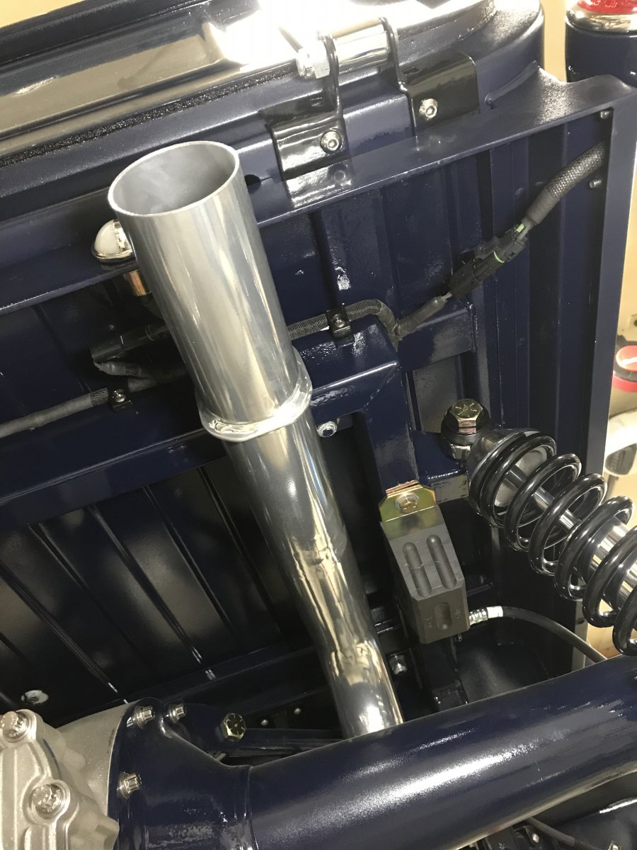

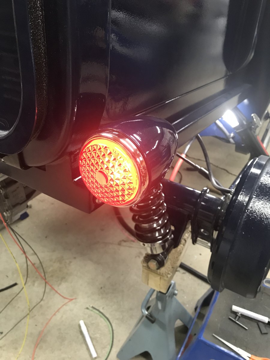

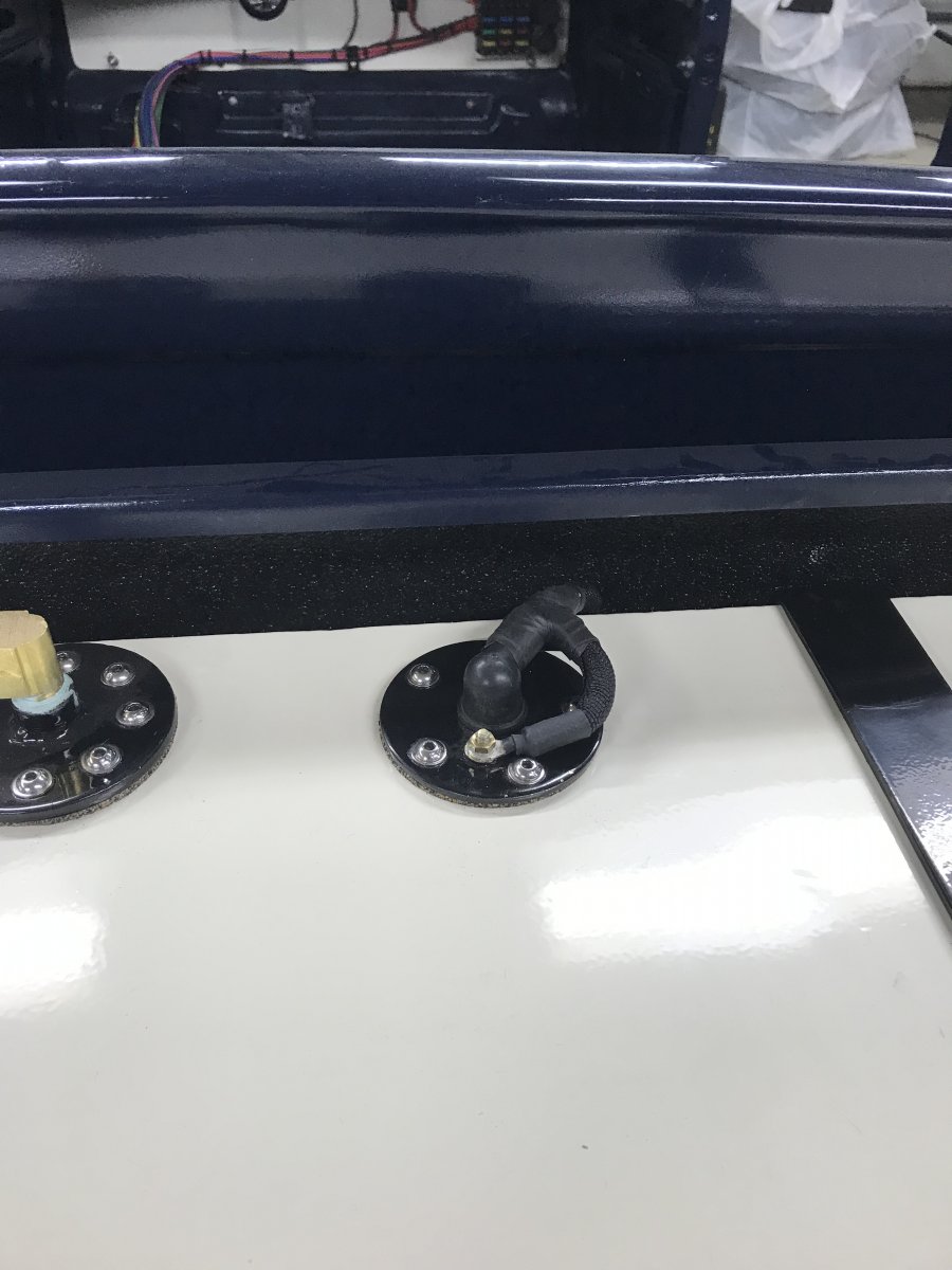

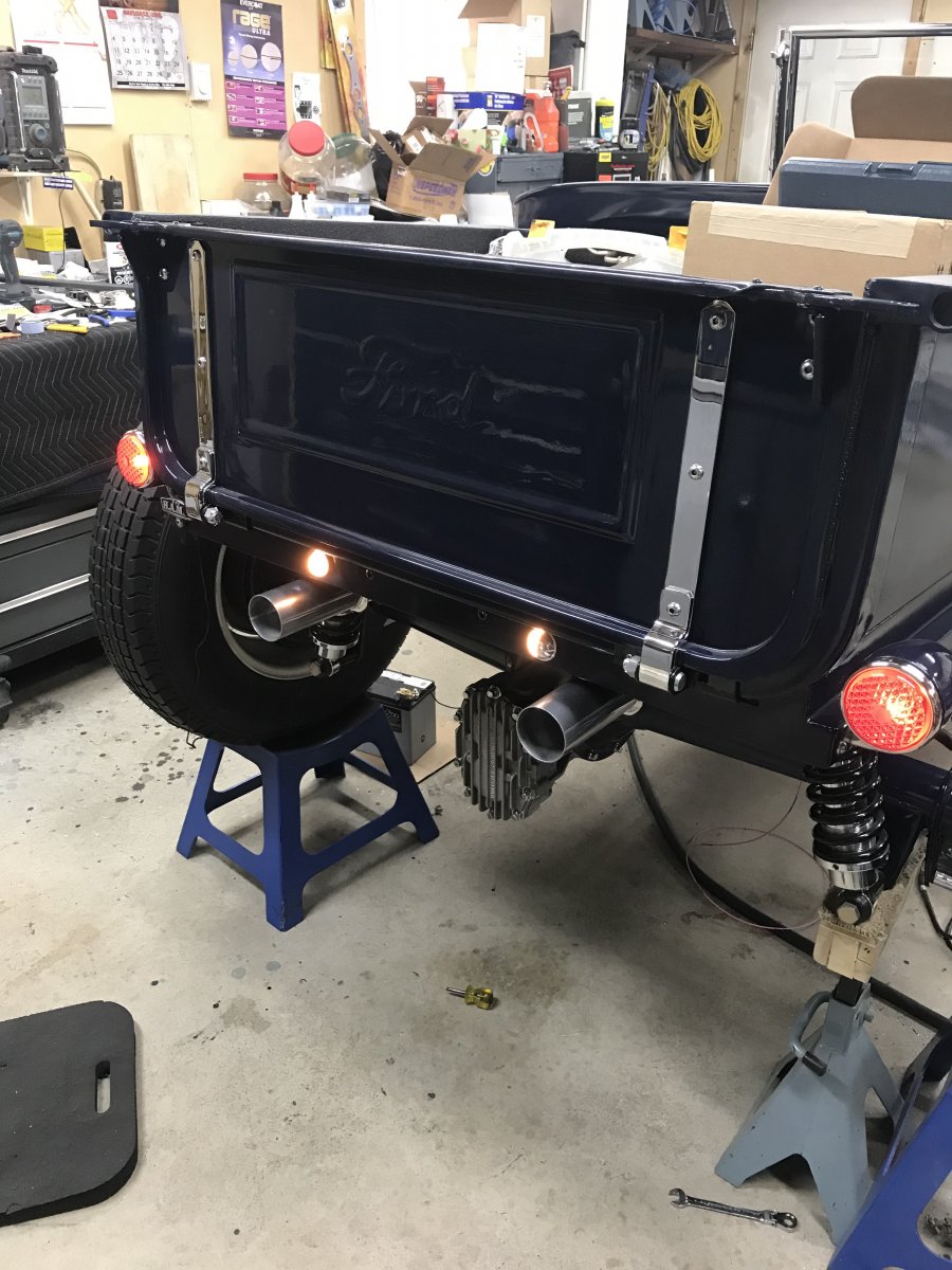

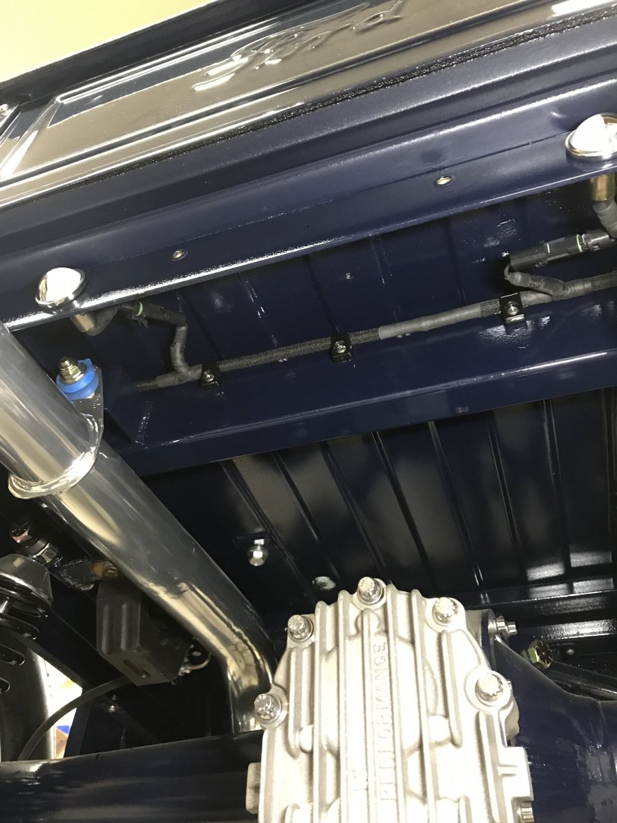

  30. Blue One
    Joined: Feb 6, 2010
    Posts: 11,509
    Blue One
    from Alberta
    Finished routing the wires back to my tail lights.
    Hooked up my fuel sending unit too.
    Loomed, mounted and working as they should.
    I used weatherpack connectors for the rear lighting.
    I have found that Rebel makes a really nice kit and Jeremy was really helpful in tailoring the kit to my components. :cool:
