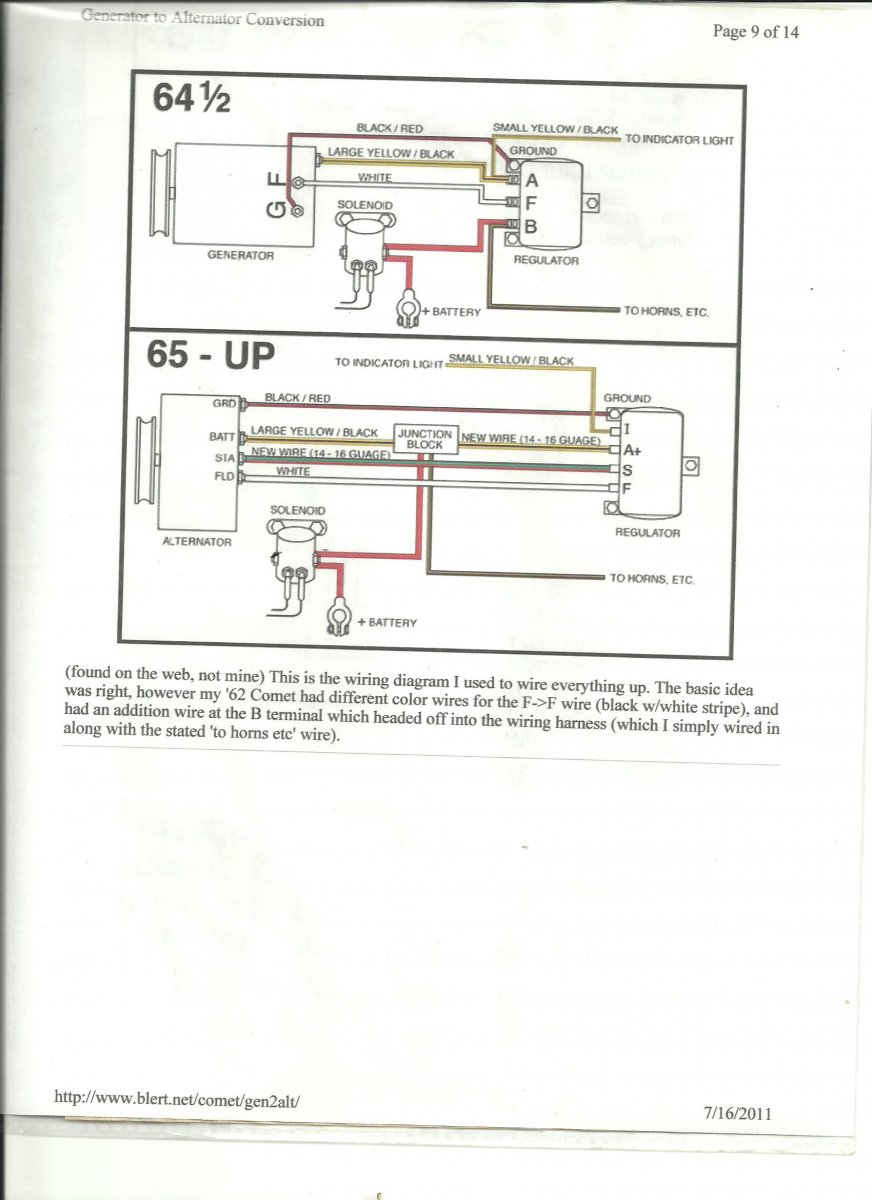

  27. I’m just setting myself up to wire my Modified using your 9+3 kit. I’m using a low pressure electric fuel pump, how should I wire it? I have a manual wiper and was thinking of using the wiper power wire, the pump will have its own switch on the dash rather than just coming on when I switch the ignition on. Also I have a Ford inertia switch I would like to use - should I run that through a relay.
    I will be fitting a front and a rear fog lamp, any suggestions for wiring those? Is there an existing circuit I could use (I won’t need the AC heat or the radio) or should I wire it separately?
    I’m a bit confused about the dimmer switch power wire. It’s not a term we use over here. Is it just the switch that lets you go from main beam to dipped bean (high to low)? Are parking lights just the sidelights or running lights (the 5 watt bulbs in the headlights). We don’t use them as parking lights here anymore - that went out in the 60’s.
    Finally (!), I’m using a generator with a separate regulator, is there a wiring diagram for this?

    Sorry, I started posting more tech online and got a little swamped, lol. The wiper wire will be fine to use, it comes off the Ignition side of the fuse panel, and would be good to run through the dash switch as an override. I actually was just talking about the Ford inertia switch on a fuel pump with Hotwire Auto and they suggest just running the power for the fuel pump straight through the inertia switch, I asked about a relay too. I would check out the wattage of the fog lamps, just to see if you needed to relay them and trigger the relay off of the fuse panel. The ac heat wire is a 14ga, radio is a 16ga if it helps. It would really depend on the wattage of the bulbs (I just like to be sure, there's some high wattage lights out there now).
    I believe the dimmer switch is AKA the "dip" switch. just let's you switch from high to low beam. Right, parking lights are the same as running lights, on with the first position of the headlight switch in most cases, some stay on depending on the switch. I'll attach a generator/regulator diagram to help out.
    don't worry about the "to horns" wire. We've already relayed the horn.
    Let me know if you need anything else.
