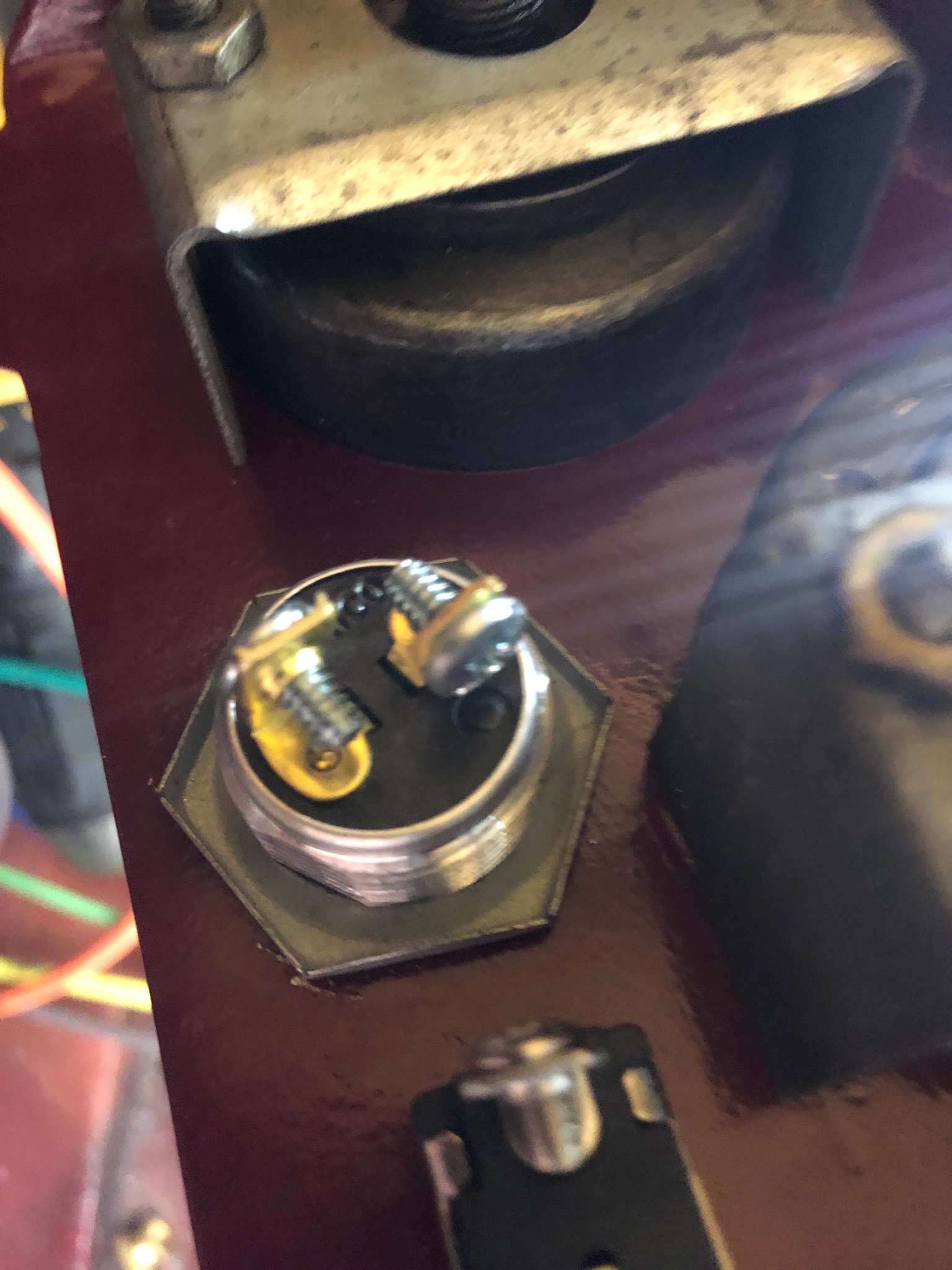

    I just Got the 6 volt Kit from ya for my Model A . I’m running a flathead v8 with a generator with the cutout on top. And I have the original style key ign. Switch in the original location. And a push ****on to crank it. I’m a little confused s where the coil wire (pink), the ign sw ( purple) ign sw (orange) and the power wire (red) wires should go. [​IMG][​IMG][​IMG]
    Here’s what I have . The ****on, the key switch, and the starter solenoid.
    Also where’s the dizzy get power from the coil?
    Sure I should know better but I had it all wired just like a model a was wired and it worked fine but I wanted to have a better fused set up and be able to hide it better along with using different light sw etc. thanks for any help!
    Also I greatly appreciate you getting the kit out right away!
    Phil
  15. REBEL43
    Joined: Feb 17, 2007
    Posts: 722
    REBEL43
    from TENNESSEE
    Phil,
    You'll have to combine some of the wires on the ignition switch. When you turn on the key, you'll need to hot the orange ignition, pink coil.....and purple start wire (if your start ****on is a 2 wire ****on and a hot triggered solenoid). The start ****on wiring depends on if its a hot or ground triggered solenoid. Let me know and we'll get it wired!
    Thanks,
    Jeremy
    Phil55Kratz likes this.

  17. Phil55Kratz
    Joined: Apr 15, 2012
    Posts: 176
    Phil55Kratz
    Now that I think of it the solenoid I just had a ground wire and the ****on broke the circuit.
    REBEL43 likes this.
  18. TrailerTrashToo
    Joined: Jun 20, 2018
    Posts: 1,475
    TrailerTrashToo
    I suspect that ****on "made" the circuit, i.e. connected the solenoid to ground.
    Phil55Kratz and REBEL43 like this.
  19. REBEL43
    Posts: 722
    REBEL43
    from TENNESSEE
    Probably a ground triggered solenoid. They both look pretty much the same. I've got one on my Studebaker, using the floor ****on to send a ground to engage it.
    If it's ground triggered, you can use the purple start wire and run it from ground, to the ****on, out of the ****on to the solenoid. If it's self grounded in the dash, you'll only need the single wire from the ****on to the solenoid. There's all kinds of ways to do it, just gotta know what the parts want and are capable of

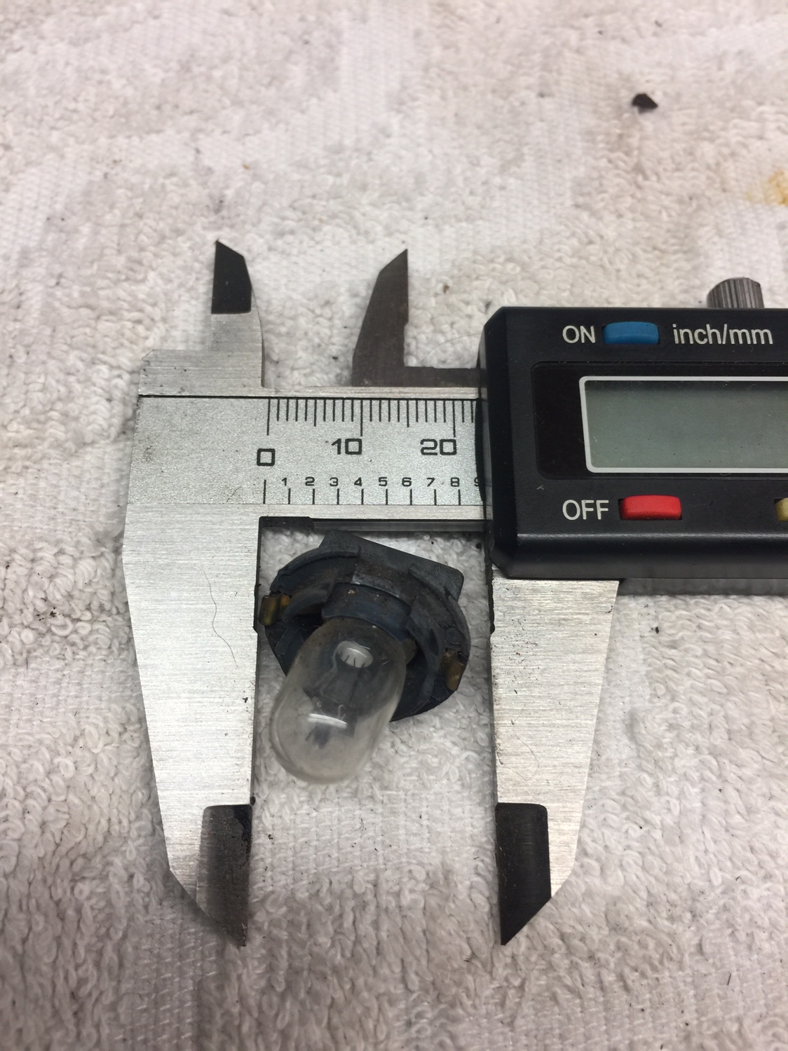

  22. jakespeed63
    Joined: May 1, 2005
    Posts: 2,867
    jakespeed63
    Been painstakingly restoring my Oldsmobile dashboard, piece by piece.
    Cluster is all done, but want to switch all the 194 peanut bulbs to LED
    Plus the holders are all garbage
    Found some kits on eBay but don’t seem to be the right size.
  23. TrailerTrashToo
    Posts: 1,475
    TrailerTrashToo
    Peanut bulb holders come in different designs/diameters. I ran into that problem maybe 30 years ago. The holders from the parts store were smaller than the hole in the printed circuit board. All the holders in my junk box were about 0.6" in diameter - and most of them were missing a lock tab...
    jakespeed63 likes this.

  25. TrailerTrashToo
    Posts: 1,475
    TrailerTrashToo
    Jake,
    You got me trying to retrieve 30+ year old memories - The Rockauto trick helped, I looked up Instrument panel lamp socket.
    https://www.rockauto.com/en/catalog...b+&+socket,instrument+panel+lamp+socket,21404
    They list both 1/2" hole and 5/8" hole - Even Rockauto is not sure what size to use. At least we now know that Acdelco, Standard Motor Parts and WVE/ Airtex/Wells makes replacement parts. Once you figure out the Olds dash hole size, you can use the part numbers at local stores...
    REBEL43 likes this.

  28. REBEL43
    Posts: 722
    REBEL43
    from TENNESSEE
    Looks like you guys got it. That's what I usually do, is measure the hole size, then just search for a bulb socket for that hole size. Make sure on your LED's to look at the + and - side of it and turn them all the right way, positive to positive and negative to negative on your printed circuit board
    TrailerTrashToo likes this.
