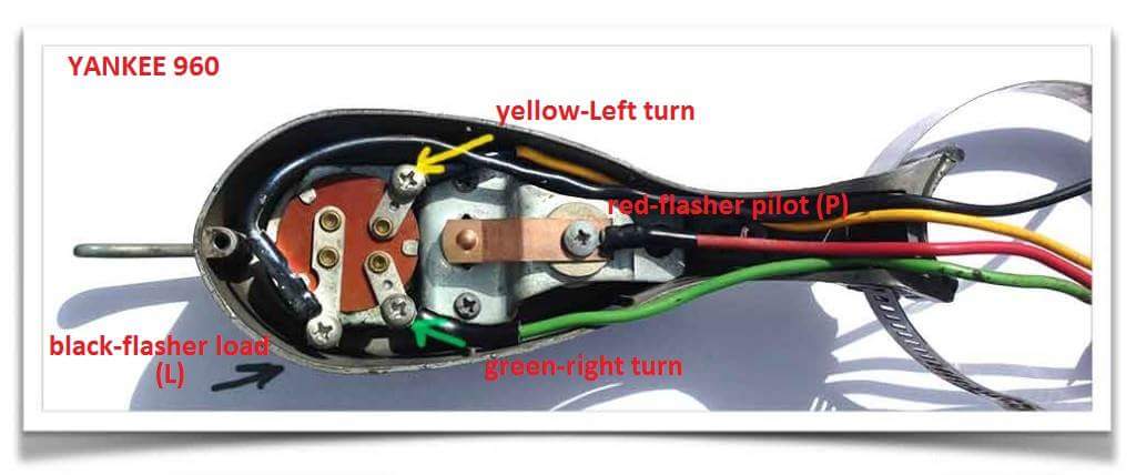

  22. REBEL43
    Joined: Feb 17, 2007
    Posts: 722
    REBEL43
    from TENNESSEE

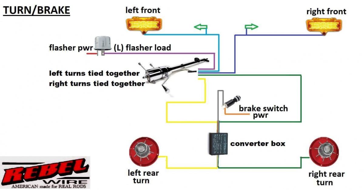

    This is one of the Yankee 4 wire switch diagrams I had. Not much to it, just a left turn, right turn, load or flasher wire, and pilot, which is the indicator bulb in the switch D36DE67D-4077-4C9C-9B71-B8BA4E6BA288.jpeg BC062189-8FB1-4707-80F6-421B9CF31E70.jpeg
    If you had this switch and wanted to use dual filament rear bulbs, you could use a trailer light converter box to sort that out. Normally your turn signal switch would do that, but a simple 3-4 wire switch can’t do that. So you would put a converter inline in the rear turn wires and bring the brake light wire into the input side. Then your rear turn wires would work as brake and turn signal
    Here’s a diagram showing the converter wired into the rear 42239AE9-EC37-46CE-9971-BE8148FB1D76.jpeg

  28. As this thread develops I'm sure it will be a great help to a lot of people. Some people seem to struggle with the wiring side of their cars and a thread like this helps to exchange ideas and solve problems.
    Good on you REBEL43 for starting this thread. Also, cool having the 64 Galaxie tail lamps in the turn signal diagram. :cool:
    REBEL43 likes this.
