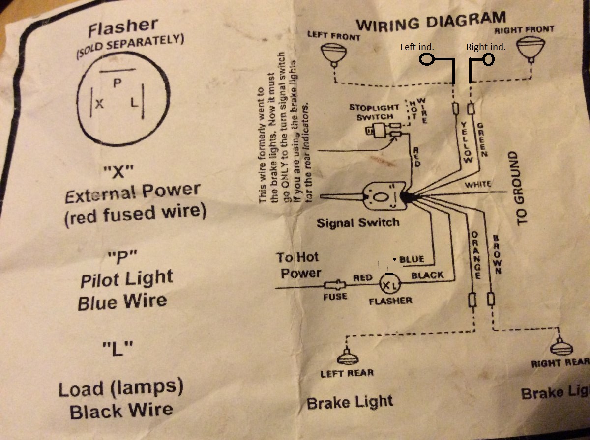

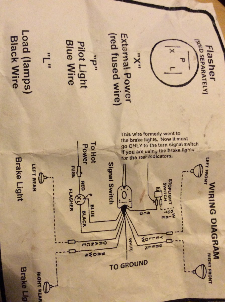

    Before I manage to burn my car to the ground I thought I,d ask for a bit of help with my flasher wiring. I want to use my brake lights as flashers so have wired them through one of the gizmos below. I,m not sure what to do with the red wire from the switch which is shown going to the brake light switch in the diagram. Also my Rebel wire flasher has 2 pins and the one shown in the flasher switch diagram has 3 pins. Built a few cars over the years but this is the first time wiring one and up until now has been pretty straight forward with the Rebel kit.

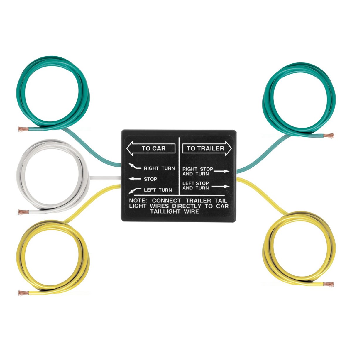

    If you're using the turn signal switch shown and have dual element bulbs in your taillights you don't need the trailer gizmo. Wire it as shown on the turn signal switch instructions. The P terminal on the 3 pin flasher is for the indicator built into the turn signal switch. There are ways to make that indicator work with a 2 pin flasher by tying into the front turn wires using diodes or you can just add 2 indicators somewhere else again tied into the front wires (no diodes needed).

    Thanks for the reply. I installed the trailer gizzmo because I was originally going to use a different switch . Thanks for pointing me in the right direction.

    You can still use the 10ga alternator wire for your charge wire from the B post on the regulator if you want to. The white alternator exciter wire can still be used for the indicator bulb in the dash if you have one. You'd run the white exciter wire from the fuse panel to one side of your indicator bulb, then come out of the other side of the bulb and use the rest of the wire to run to the A post of the regulator. Use 14ga wire for the Field wire and 12ga wire for the Armature wire. Let me know if you need anything else.

    You can also tie together the Pilot and Load wires and put them both to the load terminal of a 2 pin flasher. Trouble with that is, since the indicator bulb is grounded in the switch it will glow when the key is on (if the flasher is wired with a keyed hot) , and flash like normal whenever you use the turn signals. If you could get to the indicator bulb and change it to a hot coming in, it would work like normal with a 2 pin flasher and not glow. Not really worth the effort to rewire the switch, but it's interesting I still wish they'd make the switches with 2 load wires ( the ones with the hazards built in) so they didn't all work off of 1 flasher

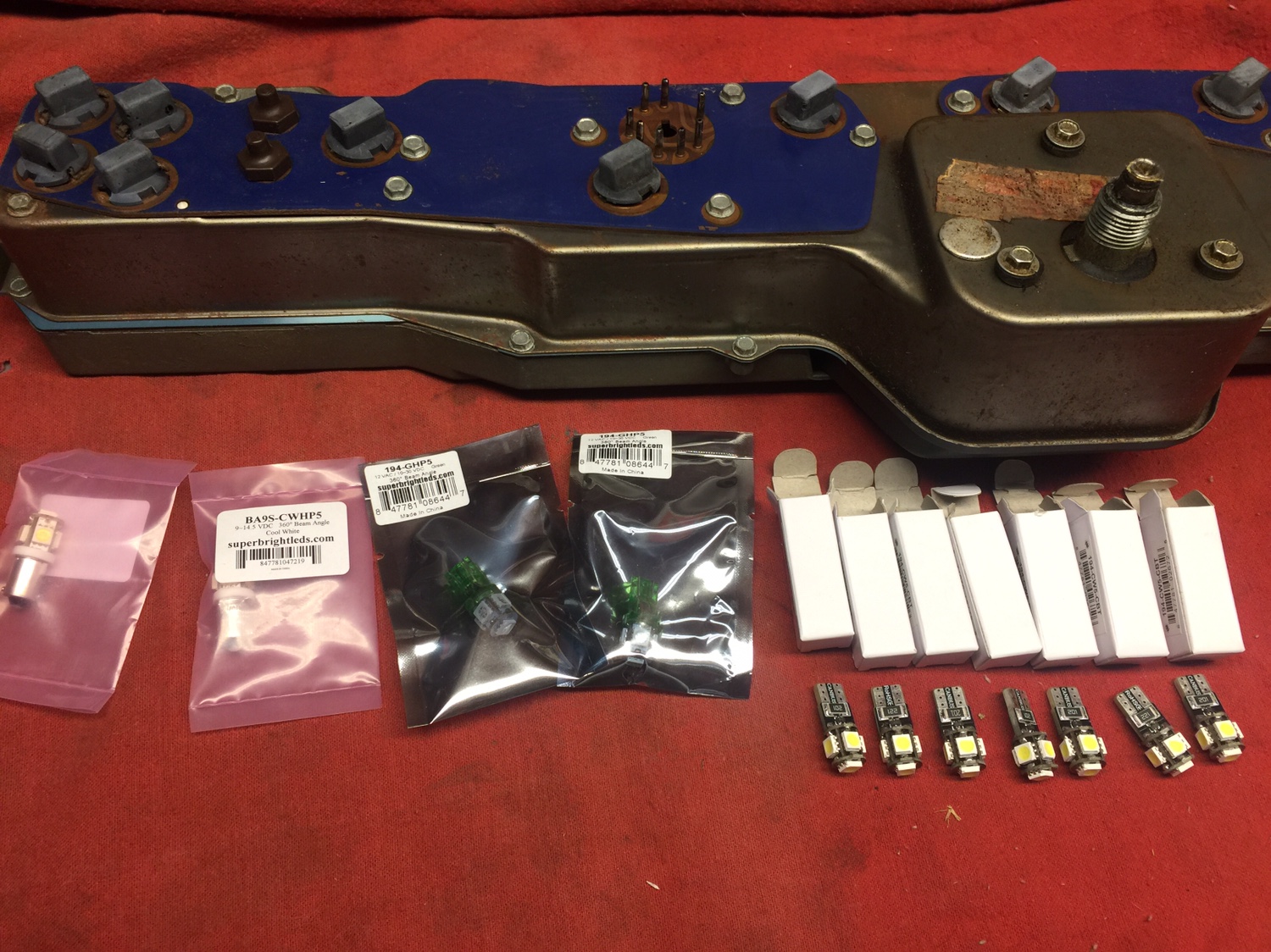

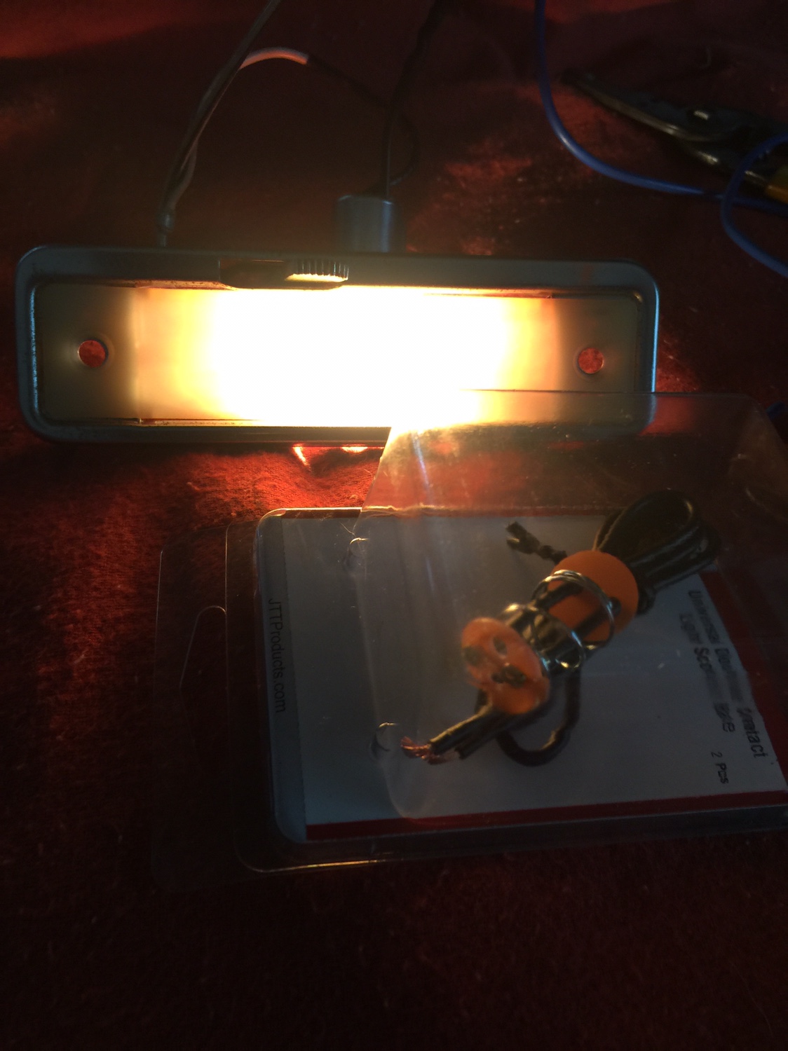

    Swapped LED bulbs into my ‘64 Olds 98 cluster. Will I need to splice an electronic dimmer into headlight switch to cluster circuit??
    LAROKE likes this.

    I just recently saw a rheostat that could dim down LED's, on a Halloween prop site of all places, I was looking at some Wiper motor wiring and a potentiometer setup. You never know where you'll find useful information. Most of the LED's I've seen won't dim down with a regular headlight switch, just too sensitive I guess and the switch can't drop it far enough. It's either off or on, but I'm sure there are other switches out there for it. If you want I can find and send you the info I found, I didn't look at it closely since I was looking at the wiper wiring

    Speedhut Gauges sells an electronic dimmer especially for LED's. I have one on my roadster which has failed. Fortunately, when it failed the lights stay on, not off.
    John

    Definitely don’t want to waste my time with something that will break. Ultimately at this point, more concerned with good solid illumination, than dimming
    Trying to wrap up this dashboard portion, of the project and move on.
    Patiently awaiting a cool light panel to backlight my Ninety Eight plaque
    Was able to fix broken map light with new contacts kit [​IMG]

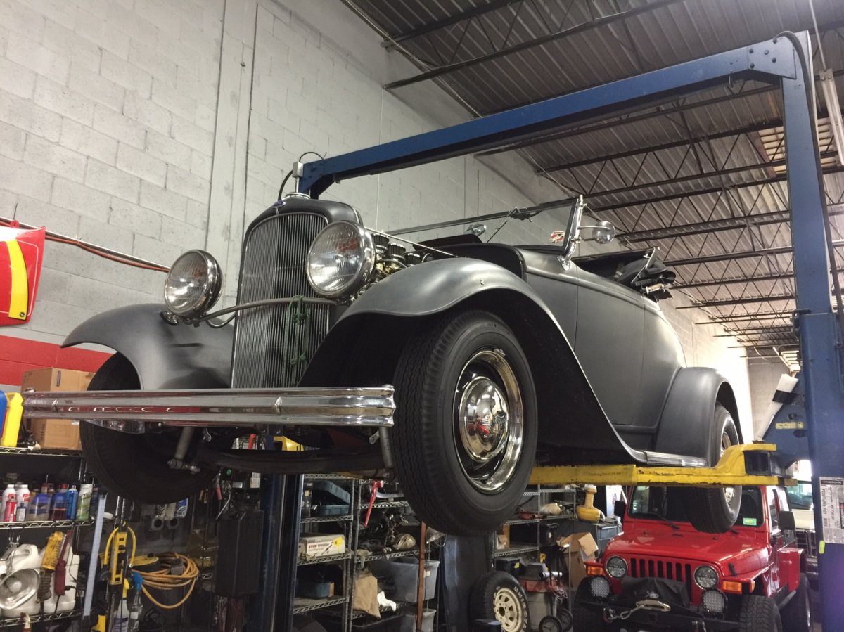

    Finally(last week)finished the Rebel Wiring job On Bill’s ‘32
    Big thanks to Jeremy for all his ***istance.
    60’s GM tilt column, through us a curveball.
    Otherwise went fairly well.
    So glad to have all that spaghetti in the trash. Car was so unreliable
    Props to Misfires Car Club Brother Chad, whom did most of the heavy lifting.
    Excuse the half *** exhaust. On the short list of things to upgrade. Car was purchased about 13 years ago, from a VA backyard builder. Brookeville body ‘56 354 Hemi w/5 speed

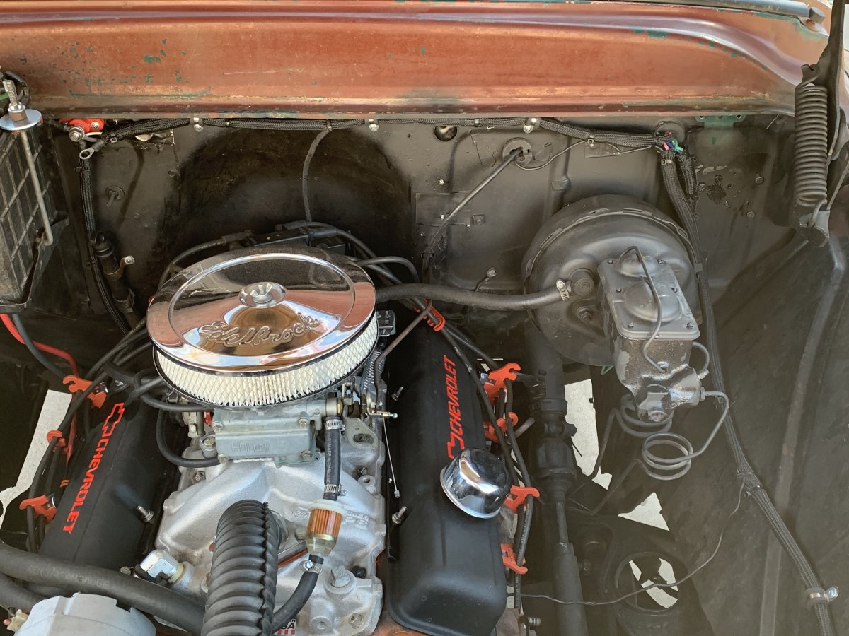

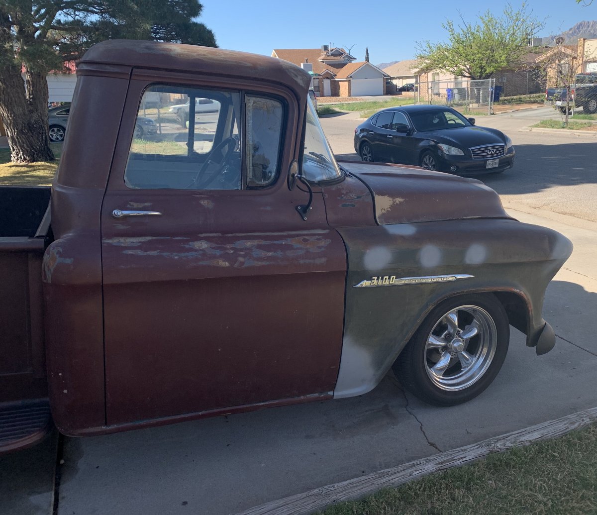

    Big shout out to Rebel Wire and Jeremy. Thanks to work from home initiative my truck is back up. Picked her up from exhaust shop yesterday. Complete rewire using the 9+3 kit along with a few phone calls. In the 2 years I have had her this is first time with turn signals and a fuse box. Very straightforward and Rebel wire was available several times to clarify some questions. I highly recommend them for your next project.
