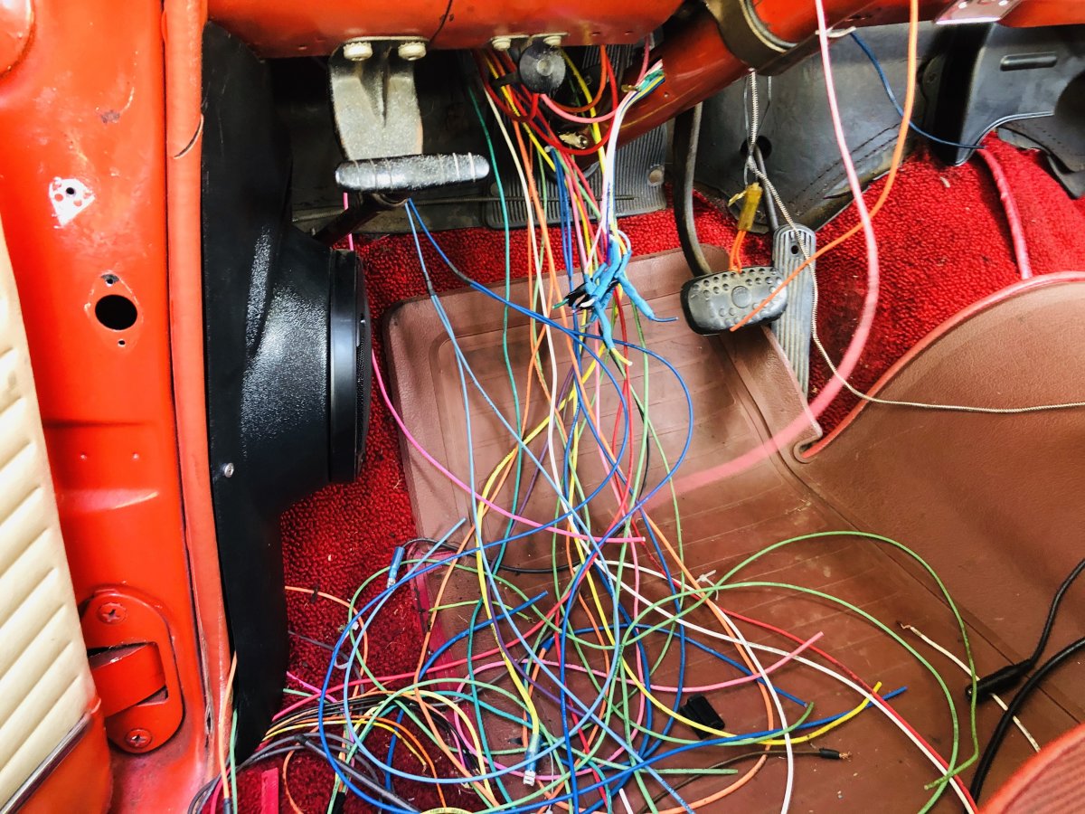

    Been wiring a guys 55 Chevy on the side after work, actually I was supposed to “clean up the wiring” but I ripped about 90% of it out and put it back new. I left the fuse panel since it was ours and I happen to know the guys that built it, haha. Just wanted to post a couple pictures in case it might help someone out with theirs. Here’s some before pictures
    AD7347BD-CD4B-4D3F-AE69-100CDA60DE3B.jpeg 5173F3DA-2DF3-42EC-A9FF-49C1085F3785.jpeg 4A30BDA2-A984-493A-8FC6-90114ECABB9A.jpeg D3F1DD51-9D04-45AE-B353-77ACD53098B9.jpeg 7C3DBF0E-7225-4930-917D-75EC1E324926.jpeg 670EB48D-C802-4F36-B49C-73D2AB469017.jpeg
    Here’s some pictures along the way

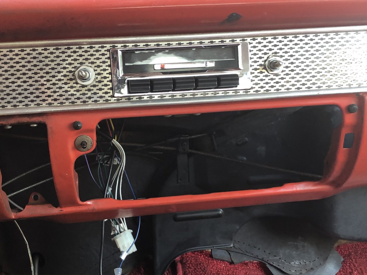

    DB204525-763E-4AB9-8369-AF1E1B00B3BC.jpeg 6CE71E3F-AF13-458C-8C42-089D8501619F.jpeg
    Testing the rear sockets to see which is the turn and tail wires. Bright would be the turn/brake and the dim would be the tail light F8F57582-999A-4636-98E7-D6B93DF357EF.jpeg 1C906C7D-C419-4B4D-9041-8D2A9EF16AFD.jpeg EBE410DC-2351-49DB-96F5-6EABBA24363E.jpeg F252FAAA-BC6B-4097-B303-8D816D29975C.jpeg 23907DC2-4218-4B81-9CE2-6E36954ED453.jpeg C1D71074-1AD5-4609-B6B7-7891F846475C.jpeg put some male and female connectors on the stock turn signal wiring
    Made a gauge harness with disconnects so it’s easy to wire on the bench and pull out later if needed, which was needed because the fuel gauge turned out to be bad. 6BAFA5E6-B5CC-4CC8-8484-1A89C6DD1D77.jpeg F9143AAF-290C-4C00-B8D4-258686AEDB2D.jpeg A428CFAF-A27F-4829-B5C9-39D98FBC94A7.jpeg
    Changed out the stock dash light bulbs to green LED’s, because I just like that old green glow!
    93F642F2-960F-4296-A3FD-BE1A544EE962.jpeg 541913A3-9201-49AF-A622-3B4F6F1D2609.jpeg AD3DF68B-A569-4965-AE36-DB45E02754B8.jpeg
    I also put connectors on the custom auto sound head unit and speaker wires to make it all serviceable down the road BBF1C10D-777C-4B54-865A-636F294F7CB8.jpeg C9A6B5DE-265F-4351-BCC8-22D7BF788E05.jpeg

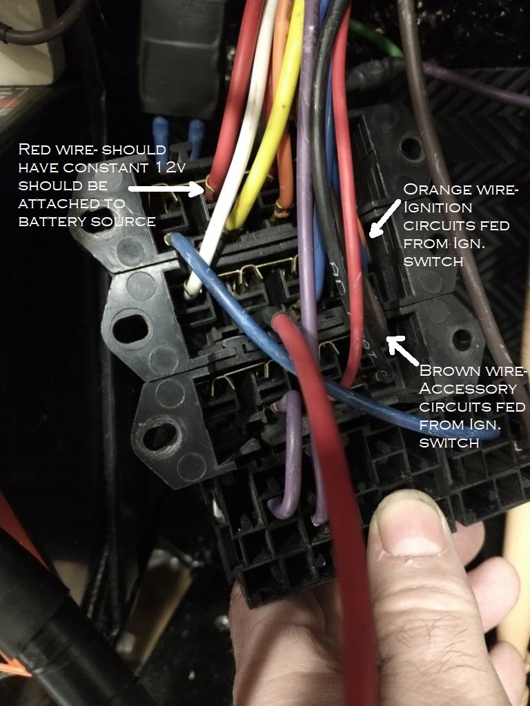

  10. Looking for some advice. I bought this Rebel loom a long time ago - 10 years plus. I started installing it in my Model T Modified just a few months ago. It has had modifications because lighting is different over here and I'm using a generator and not an alternator. When I turned it on for the first time it turned the engine over but little else worked.
    Looking at the back of the fuse box I could not see any live feed to most of the units (see picture below). I put jumper cables from the main live feed and it all worked as it should.
    Am I missing something? Should it work without jumpers or do I need to add some permanently?

  11. RICH B
    Joined: Feb 7, 2007
    Posts: 5,944
    RICH B

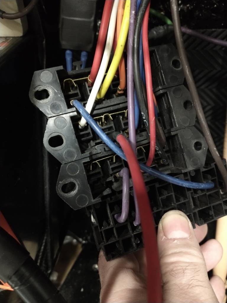

    Looks like there is a feed to each of the three buss bars; maybe back check to see why the feed wires aren't powered up.

  13. 24riverview
    Joined: Jan 13, 2008
    Posts: 1,112
    24riverview
    You should have a constant 12 volts at the red wire, if not check your battery feed (starter solenoid/relay?). If a problem there you also may not be getting a voltage feed to your ignition switch, you should also have voltage at brown and orange wires with key in ignition position.
    REBEL43, Hombre, pprather and 3 others like this.
  14. Yes, there is a constant 12v at the red wire but nothing at all on the other sections of the fuse box. The starter turns over fine. When I put jumper leads from the red wire to the bus bars in the other sections, everything works as it should.
    Thanks for the help. I will run my multimeter over it tomorrow. It's midnight over here just now.

  15. Much appreciated, 24riverview has given me some useful pointers and I will follow those up tomorrow.
    Sent from my moto g(8) power using The H.A.M.B. mobile app
    Hombre and pprather like this.
  16. Got it wired to a switch and a ****on - no key. Traced it to that. Have revised the wiring so fingers crossed that's it

  17. REBEL43
    Joined: Feb 17, 2007
    Posts: 722
    REBEL43
    from TENNESSEE
    Sorry guys, I was off work last week and have been rewiring a 67 VW Single Cab while I was off. The power for 8 of those fuses come from the ignition switch. The brown accessory wire powers 4 fuses and the orange ignition wire powers 4 fuses. Go to your ignition switch, key on, those wires need to go on a terminal that's hot when the key is on. If it's a simple off-on switch you may have to tie them together with the coil wire. Let me know how it goes. Got back to work today and working on about 40 harnesses to ship out, haha.

  18. Hi Jeremy, thanks for getting back to me.
    There's no key, just a master switch and starter ****on. I've traced it to the switch. It's an NOS dual pole switch from a Russian aircraft. It wires like no dual pole switch I've seen before and that seems to be the source of the problems. Will rewire it tomorrow and all should be well.
    If you could let me know what to do with the alternator exciter wire to get a warning light when the generator isn't charging then I can ****on it all up!!

  19. REBEL43
    Posts: 722
    REBEL43
    from TENNESSEE
    You might have to make a jumper with the red ignition switch power, if it has multiple power in terminals to get the double pole single throw type operation. Let me know how it works out.
    For the generator light, you'll just need a 2 wire bulb (nothing self grounding in the dash) cut the white exciter wire and let it be the power in and power out. So the white exciter wire will come out of the fuse panel and into one side of your 2 wire bulb, cut the white exciter, run the rest of the white wire from the other side of the bulb out to the Armature terminal of the voltage regulator.

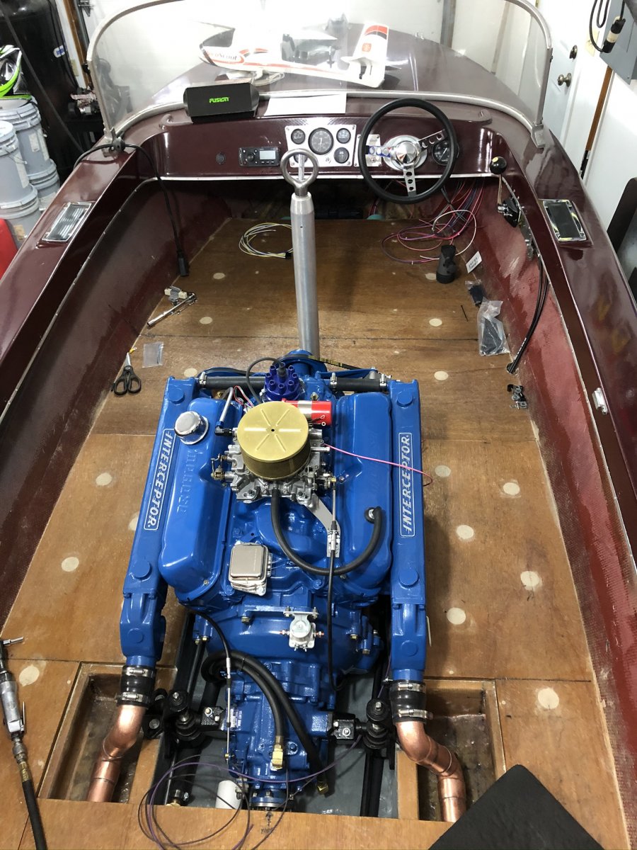

  21. Chucky
    Joined: Mar 15, 2009
    Posts: 1,862
    Chucky

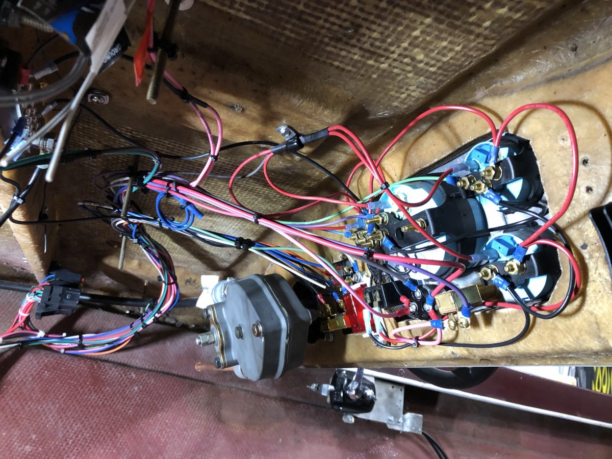

    @REBEL43 I just finished wiring my 1966 Correct Craft inboard 302 tow boat. Waiting for warmer weather before firing it up. Everything went very good during the installation. Thank you so much for custom building my harness!
    C0849FA5-E2B7-4CFC-AAE1-D7199B86BE64.jpeg A190618C-A4AF-4504-9B54-7BC53B8759F9.jpeg
