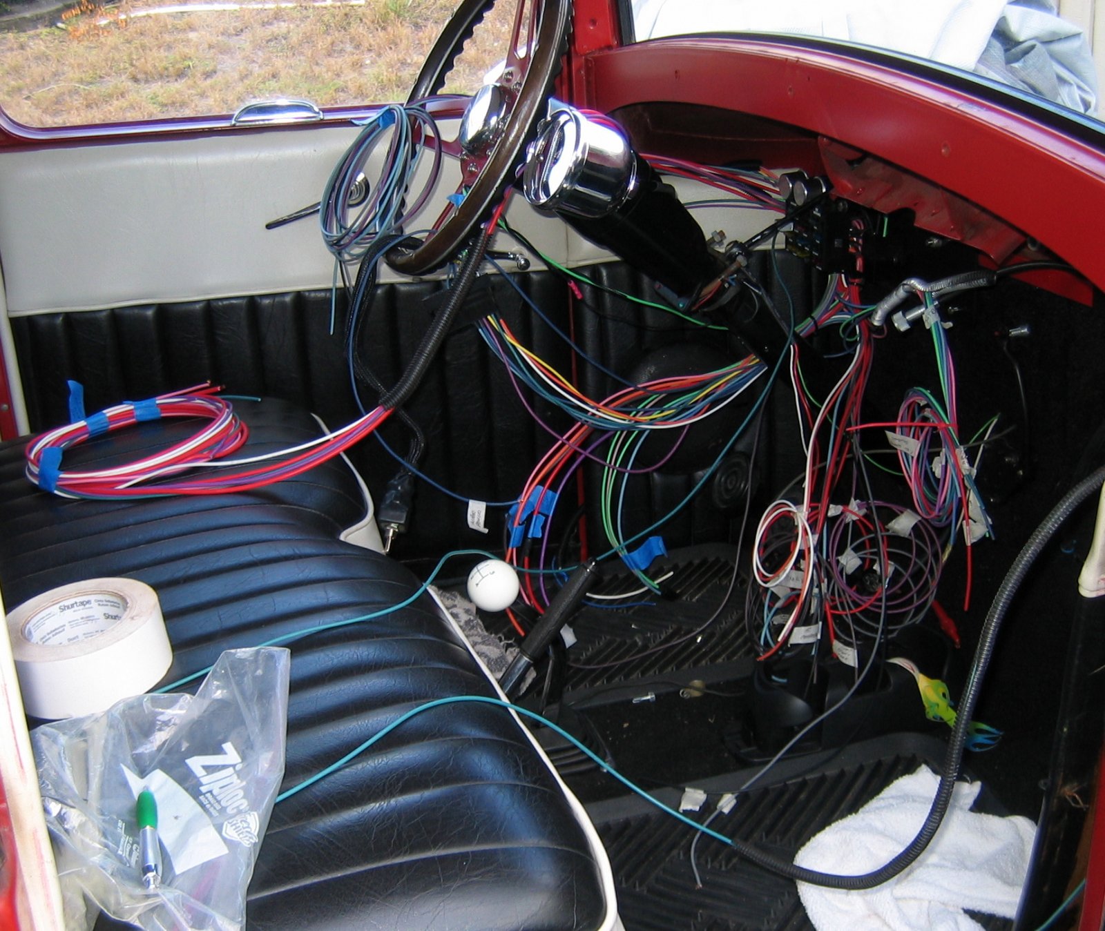

    I just received the third wiring harness to install in the latest car and I'd like to make the hazard lights operational on this car. Do you add a 12 volt feed that is switched to the brown (IIRC) wire in the turn signal switch harness to operate the hazard lights?
    A friend and his son are coming up to look at the wiring harness for his 49 Chevy g***er, they were going to order from another vendor but I convinced them to at least see what the compe***ion had:)

    Rebel wiring made me a very nice 21 underseat harness for my 36 Coupe. I've got the wiring laid out to where it goes. Dash is wired and reinstalled. The car has power windows and power door poppers already installed. I've purchase an aftermarket power window wiring harness. the p***enger door p***enger window switch has 5 wires in it. Blue and Green go to the motor, brown and brown/black ground, red is 12V. I'm installing 5 pin relays in the drivers side door. I can't seem to figure out how to connect the p***enger side door p***enger side switch wiring into the relays for the PS door. I've ran 2 wires from the PS motor to pins 30. I've attached a wiring diagram I'm using but I'm overlooking something. any help is appreciated. power window relay wiring diagram.jpg passenger side switch.jpg

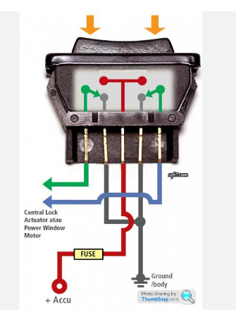

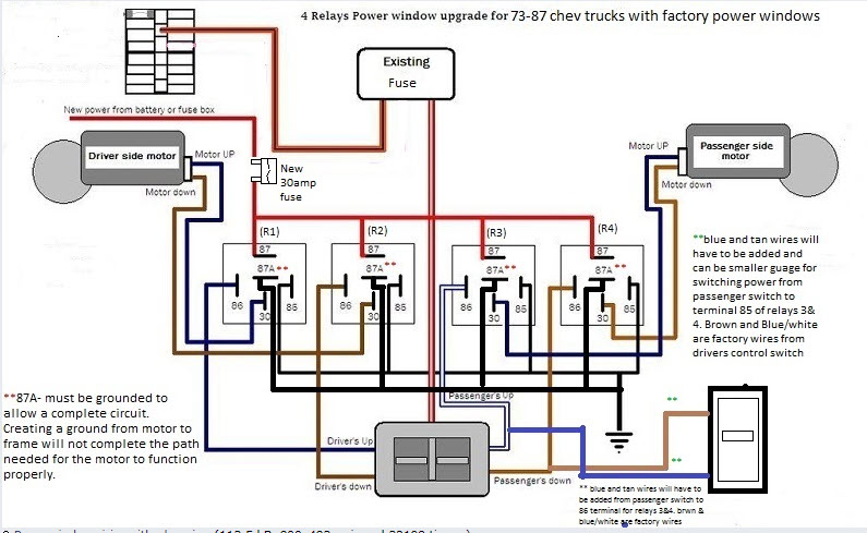

    I you are using the 1980's truck wiring, then you will need to get the 1980's style door ****ons. Note, the PS ****on only has two wires, hence the need for an 'up' relay and a 'down' relay.
    If you use a five wire ****on on each door, driver will have to reach to operate PS window, but no relays are needed.

    Not completely sure what you're asking here but if you want to use a 5 wire switch with the diagram shown just don't attach any ground wires to the switch.
    I agree with pprather though, 5 wire switches in both doors would eliminate the need for relays.
    clips221 and pprather like this.
  18. The large diagram is basically correct except it fails to show one wire. The five-wire switch will work, just don't connect anything to the 'ground' terminals and you'll have to run same the 12V power feeding the master switch to the p***enger switch which the big diagram doesn't show. Connect those three wires at the p***enger switch as shown on the switch picture. If the switch operates backwards from the 'master', just switch the green and blue wires.

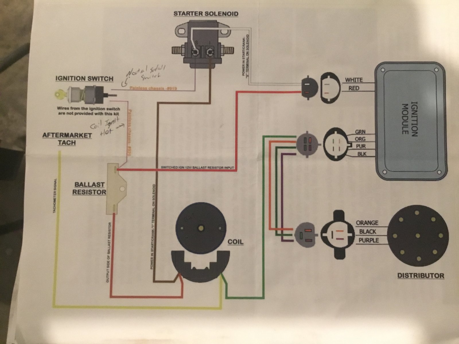

    I’ve started wiring my 51 ford. Im using the rebel wire 9+3 kit. My car has a 302 sbf and I’m running the duraspark ignition system. Im also using the painless wiring duraspark ii ignition harness p/n 30812. I’m trying to figure out what I need to do to make the 2 harnesses work together. Has anyone else done this? If so any information would be greatly appreciated.
    so far I have figured the painless wire 919 is the neutral safety switch and wire 920 is the coil ignition hot wire.
    I don’t know what to do with the pink coil wire and the tach wire on the rebel kit a to make it work with the painless harness.

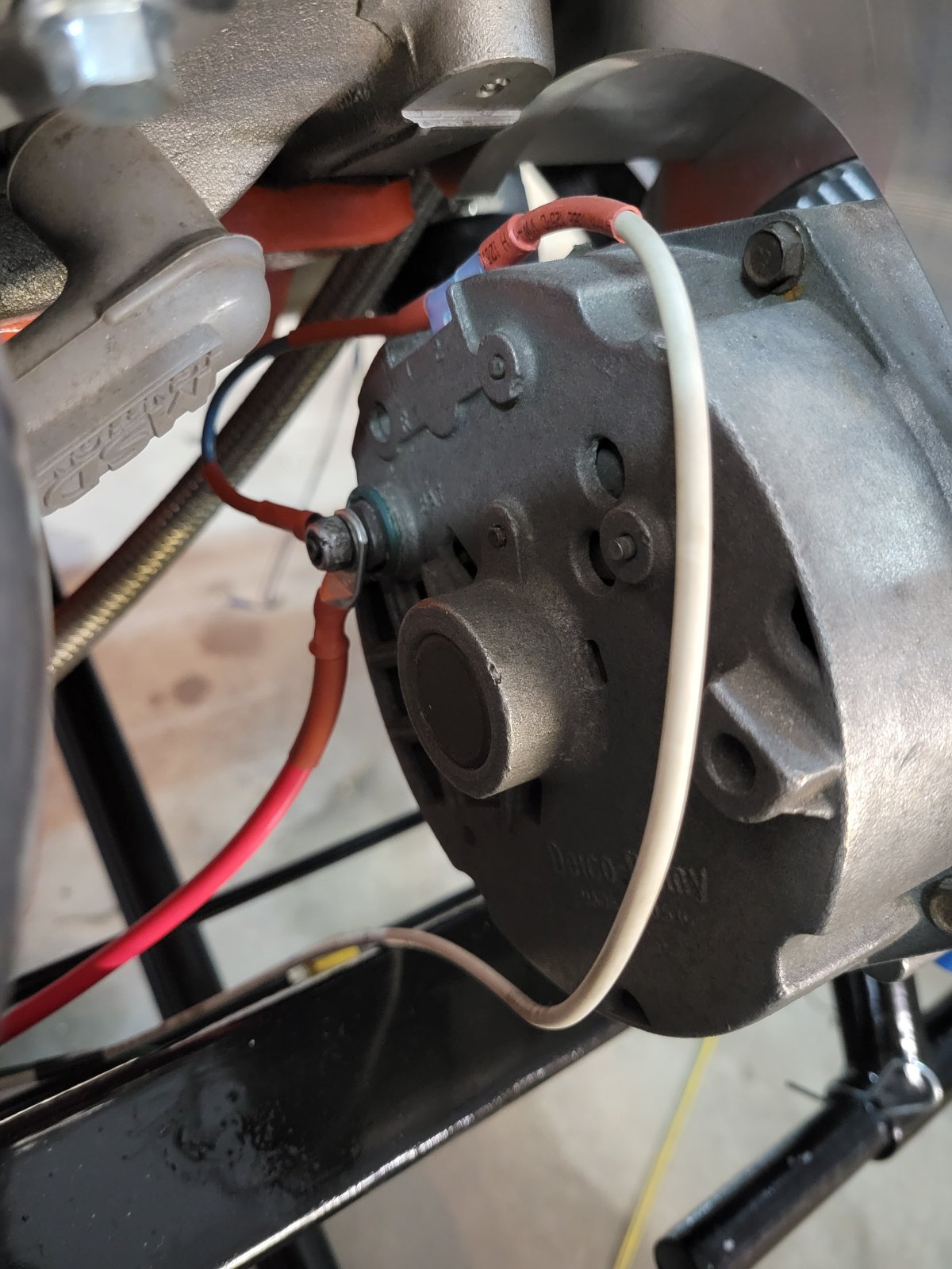

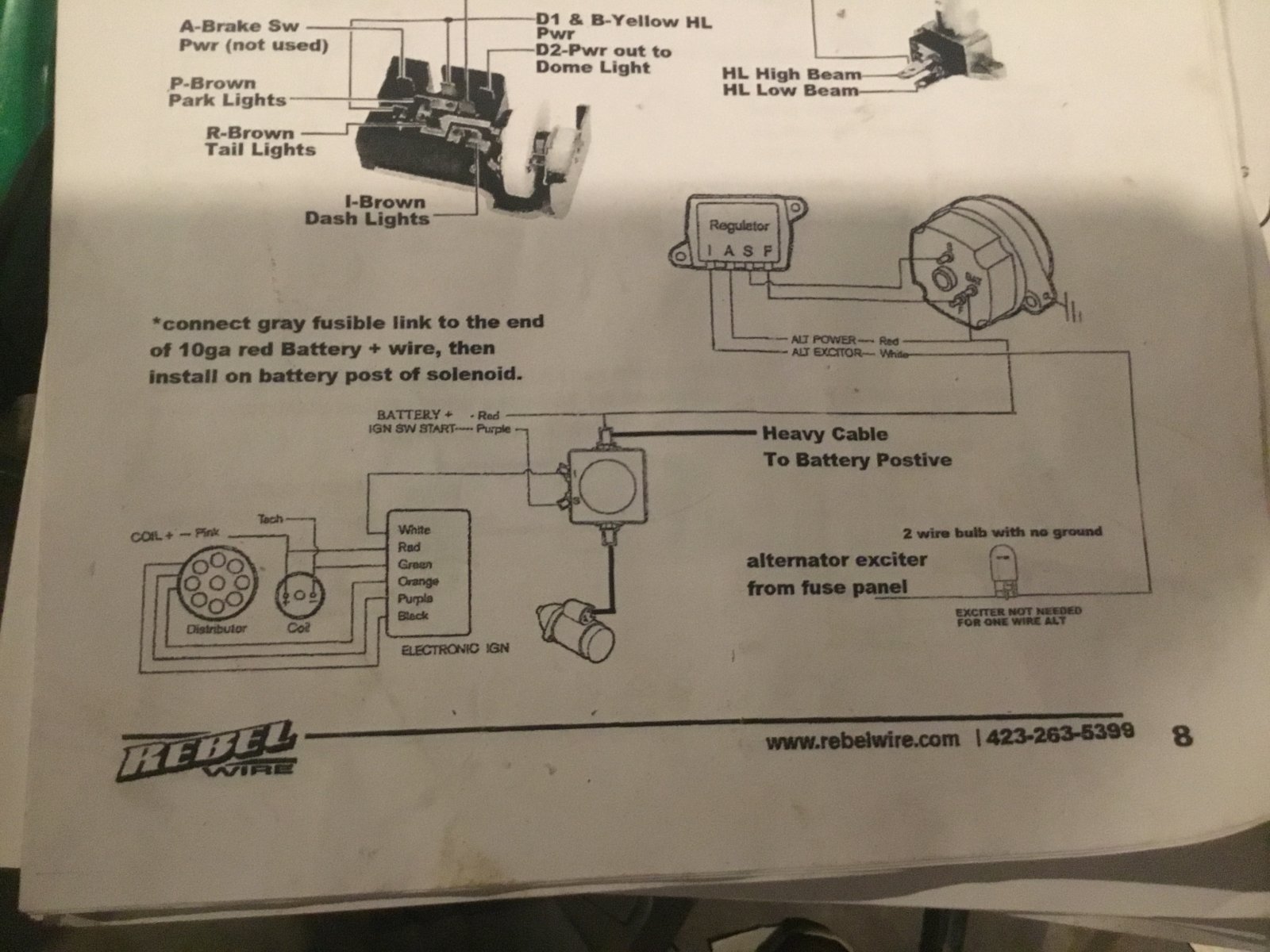

    I recently wired my alternator to NHRA rules and ran my red power wire back to the battery side of my 2 post battery cutoff switch.
    With switch off it drained my battery, I ***ume the battery fed back to the late style GM alternator and out the white exciter wire to wherever I hooked that up to.
    When configuring the 3 wire alternator to act like a one wire, is the exciter wire still needed ?
