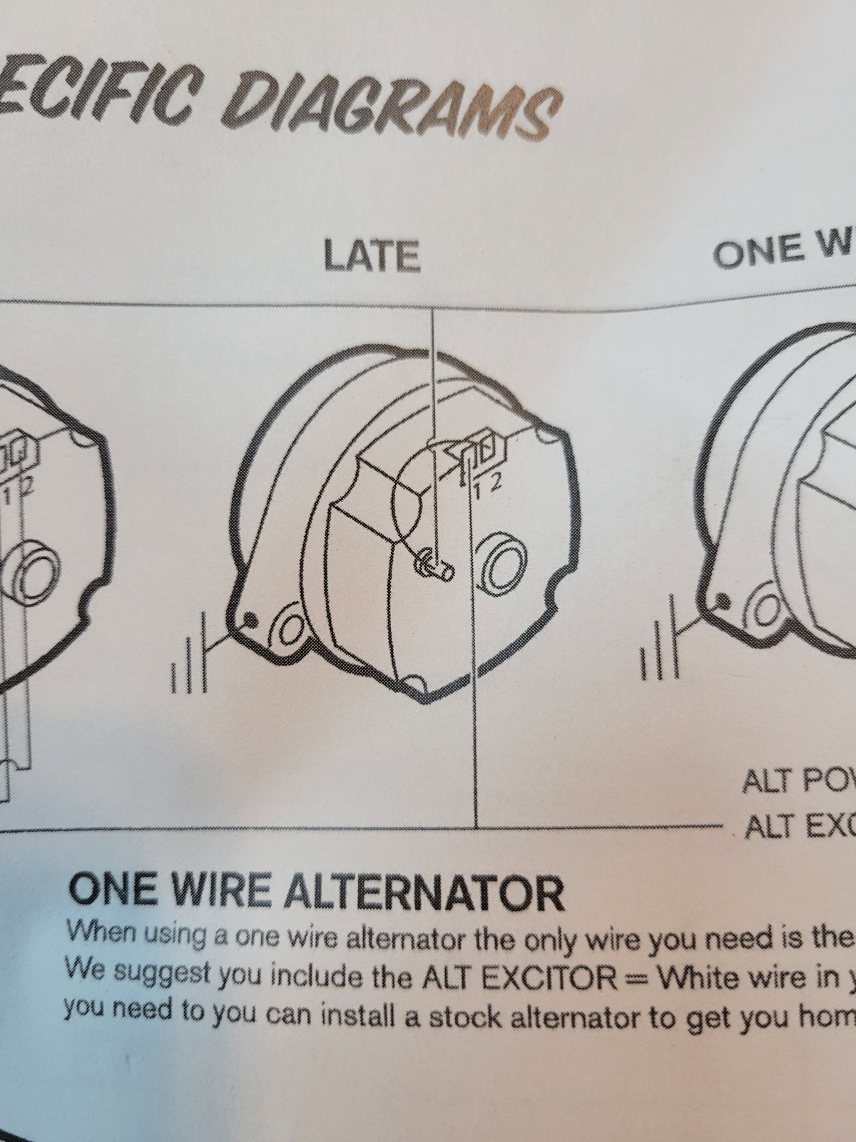

  1. swade41
    Joined: Apr 6, 2004
    Posts: 14,523
    swade41
    from Buffalo,NY
    After looking at this I think I may have the 1 & 2 wires out of the alternator crisscrossed, would that cause the battery to drain ???

  2. Johnny Gee
    Joined: Dec 3, 2009
    Posts: 14,420
    Johnny Gee
    from Downey, Ca
    Add a light bulb to your thin red wire would recreate an idiot light, what would the result be?

  9. REBEL43
    Joined: Feb 17, 2007
    Posts: 722
    REBEL43
    from TENNESSEE
    Looks like the white exciter and the voltage sense wire are swapped around at the terminals. On another note, I was recently messaging with Skratch and he was working on an old Chevy and the diode had gone bad and it wouldn't turn off. He had an old article that showed moving the battery wire to the F or 2 terminal with no exciter to make it a one wire. That worked, alternator still charges with no backfeed problem (this car had an on-off switch and push ****on so all the coil, exciter, and ignition wires are tied together).
