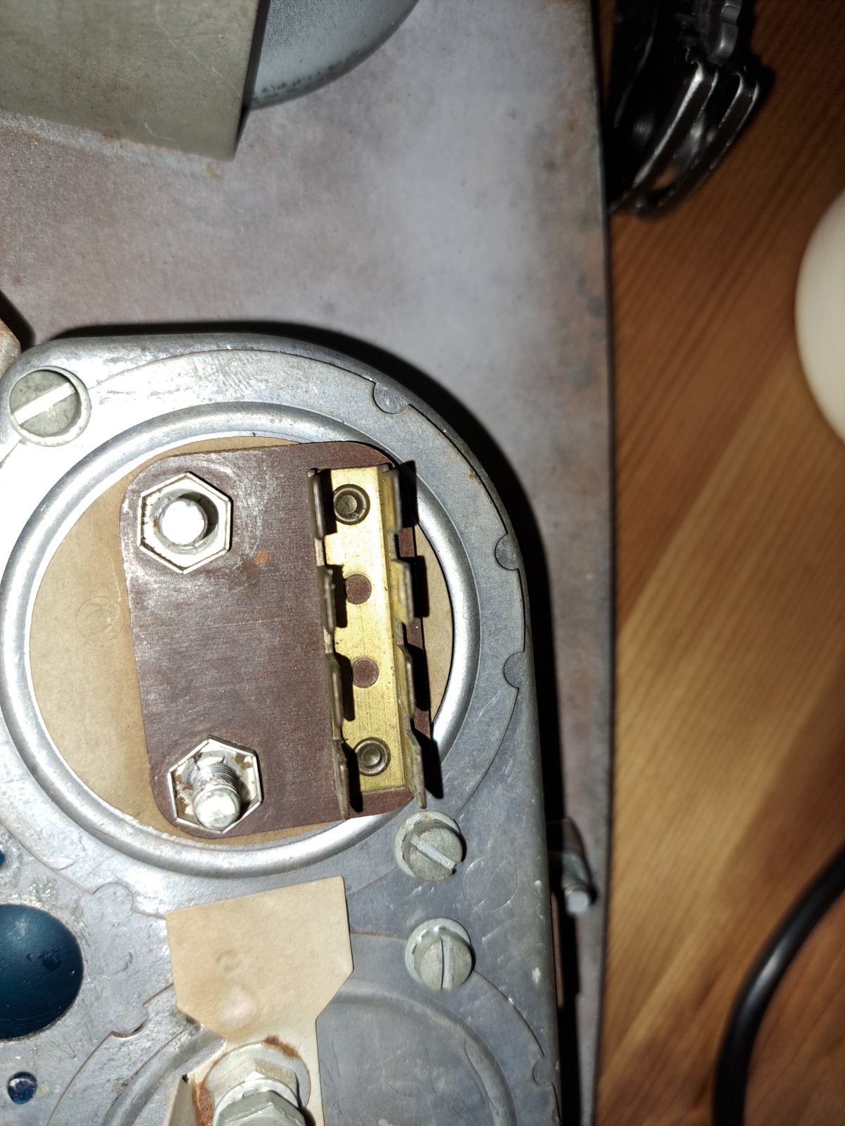

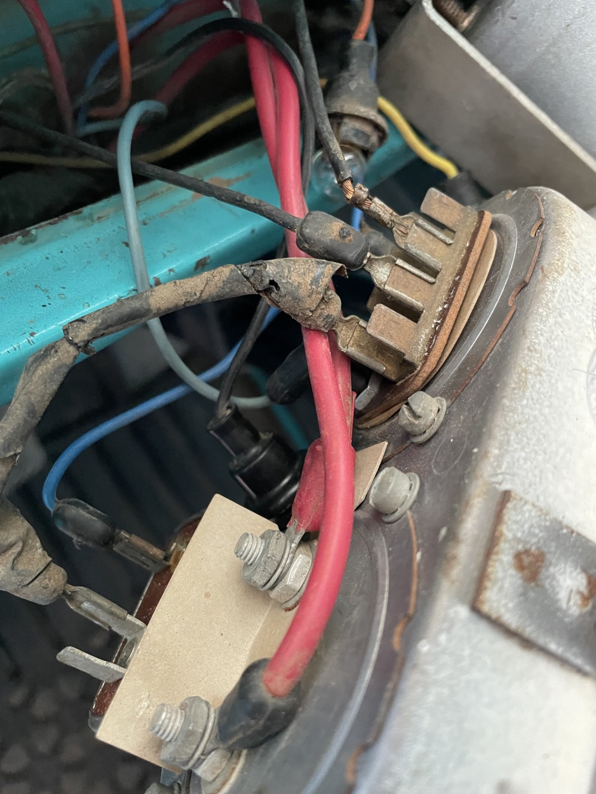

    I have a question about gauges on my '61 Dodge. Will I need to use the gauge power wire, or is, for example, the fuel sender wire and ground wire enough? Or water temp sender and ground wire good enough?
    The reason I ask is that these gauges, in their previous wiring, had a lot more going on than the Rebel diagrams show. If the sender and ground are good enough, to which terminals on the fuel gauge would those leads go?

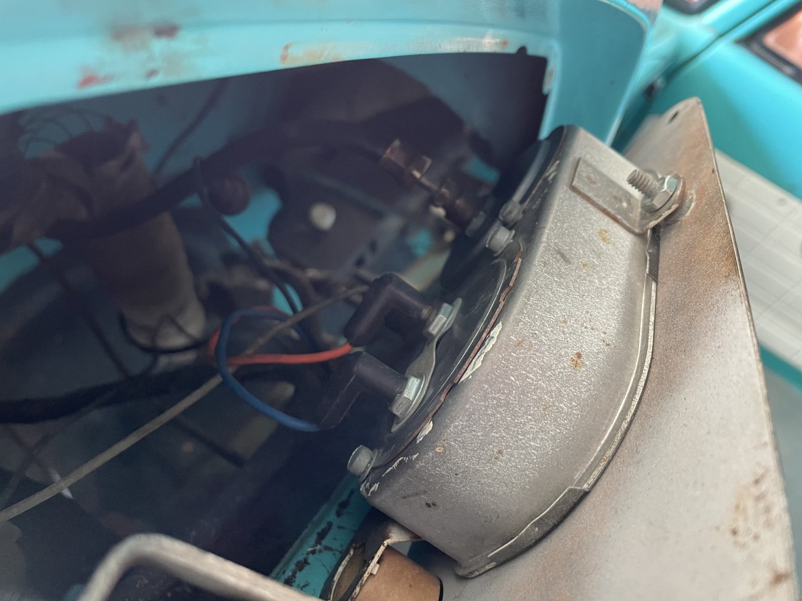

    Gauges operate by grounding out through the sending unit; but need a power input (gauge power wire); either full 12 volt or limited voltage depending on design.
    Thing attached to the panel in the first picture looks like a Ford constant voltage regulator; so maybe the voltage is reduced to the gauges. I can see one terminal has a B by it; but can't make out the rest. Any chance your original pictures show where the wires went.

    Looks like the multiple spades above the fuel gauge is just a separate hot bus to pull hot wires off of. Looks like they brought power into the regulator (12v) and jumped it up to the strip to be able to grab 12v if the needed it...then the factory blue wire comes off the other side, probably a pulsing 5v like a Ford. Then the blue wire just jumped to the fuel and temp gauges to feed them. The amp gauge isn't fed off the regulator. It needs it's own 10ga wires in and out if you want to run it. They used to be problematic on the Mopars, and I wouldn't recommend it if you've upgraded to a higher output alternator.
    So the red gauge power wire would be your keyed 12v into the voltage regulator (where the double spade is in the picture). Then jump off the other side and feed the fuel and temp gauges. Any indicator lights get 12v and don't come off the regulator. The sender wires, fuel and temp are really the ground sides, but come off the senders and vary the grounds through the senders to make the needles move.
    So on each gauge you'll have the jumper off the regulator and a sender wire. You probably don't even need the bus spades above the fuel gauge, unless you wanted to use it as a ground bus maybe? run a good ground to it and pull the grounds off of it for the dash lights, high beam indicator, turn indicators... Let me know if you need any help with it.

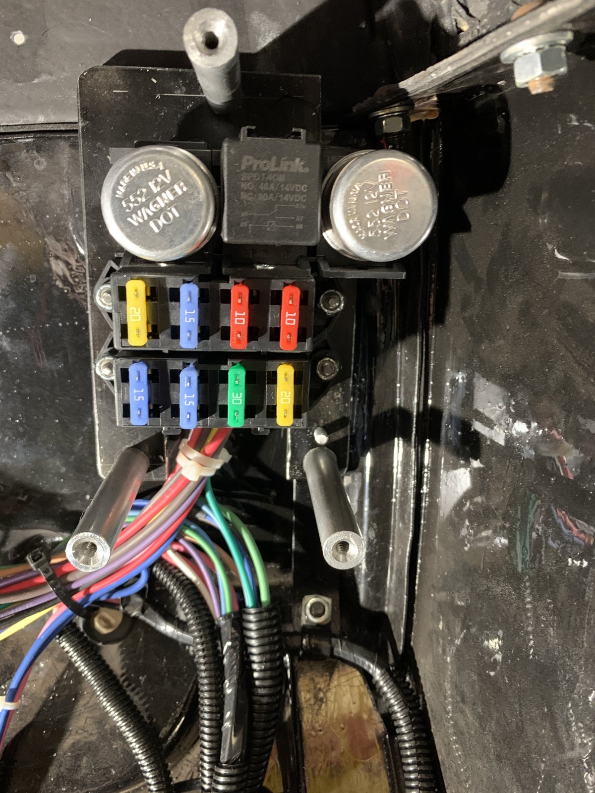

    I'm wiring my '29 RPU with an 8 circuit Rebel Wire harness. My second one, so some experience. No OEM switch gear is being used. Universal aftermarket stuff, ignition switch with no "acc." position. The brown "acc" wire in the ignition switch bundle is not hooked to anything. Off, on, start positions only. Put power on the fuse block today and checked the fuses. The bottom row of 4 illuminate a test light on either blade, the top row of 4 (just below flashers and horn relay) show no power on either blade with switch on or off. What I have working: headlights high and low beam, power to the coil, solenoid with switch in the start position, power to ignition coil/ballast resistor, pink constant power cell charger/radio wire, horn. I have not confirmed power to tail/brake lights or TS functions yet.
    With switch in either on or off position, I have no power at the blue radio wire, the blue wiper wire, and the red gauge power wire. Why no power on the top 4 fuses? IMG_1315.JPG

    Bob, can you check for continuity between the brown acc wire and the fuses that are missing power? I'm thinking that acc wire needs to be hooked to the 'on'.

    This would be the problem. The ACC position is powered both during the ON and ACC positions of the switch. Without an ACC position, this wire should be tied into the ON position as well. Tail lights should be powered from the headlight switch, turn signals and stop lights should be powered from a fuse(s) through the flasher and brake switch possibly also off the brown wire.
  25. The kit has 2 power sources, battery power and ignition power. The dead row is most likely switched power from the ignition switch. The great thing about the Rebel kits is that you can modify them to suit your needs, I switched circuits around, eliminated the turn signal/hazard set up all together and added things to the empty spaces.

    Everyone is telling you right on this. The top row of fuses are powered by the brown accessory wire and needs to be powered by the ignition switch. You can put the brown wire on the ACC position and it will power the 4 dead fuses. The running lights (park, tail,dash) will be powered through the headlight switch and will be a constant hot. You should be good when you get the ACC wire connected to the switch.

    Thanks for the help, all. In the absence of having an accessory position on my switch, I attached the wire to the ignition terminal and that powered up the 4 top fuses. The "switched power" circuits are now functioning. I'm good to go for now, but I'm sure I'll be back for more help when I hook up the turn signal switch.

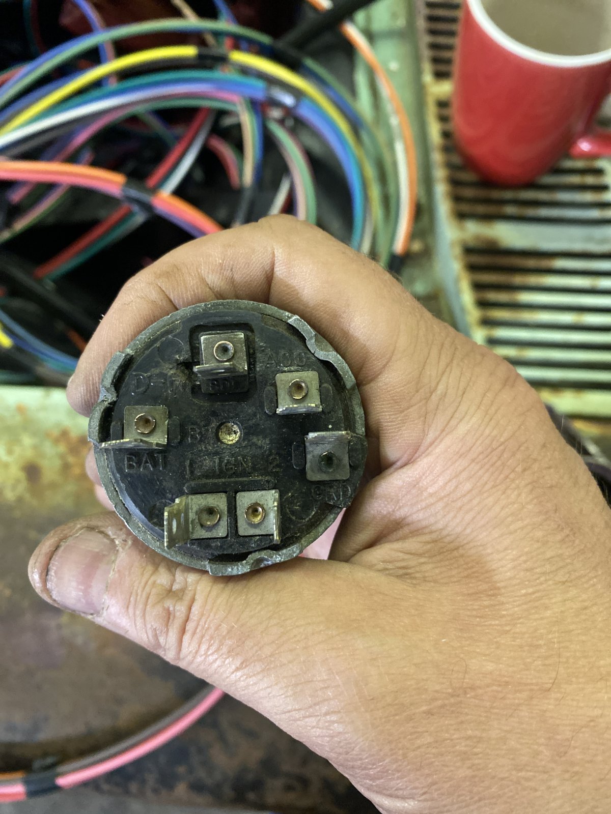

    Currently fitting a 9+3 kit into my 1962 Buick special wagon, my ignition has 6 tabs yet the Rebel kit has 5 wires, can anyone advise what goes where please.
    Many thanks
