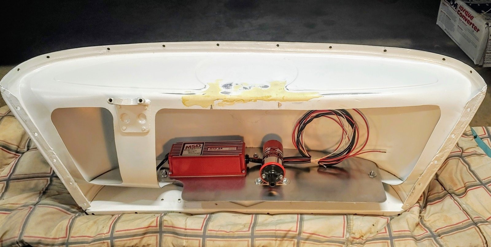

    5) I'm mounting the fuse panel above the p***enger side toe board (see picture below). Is there enough wire to reach all the components?

    No- just the opposite! That's just the MSD box wiring. The fuse panel will be added on the right, where the coil of wire currently is.

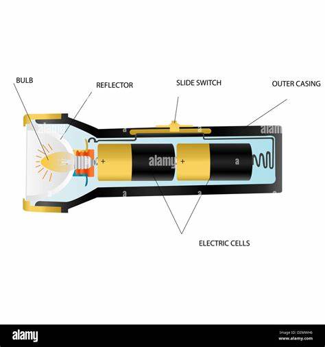

    @The37Kid , I reread this whole thread yesterday, and I must say, your consistent avowed dislike for and fear of electricity is amusing, but makes me wonder why you don't just go old school diesel with air start? :D
    How the heck do you even connect a battery on your stuff, including a flashlight (torch for the tea sippers)?
    Most things in the car operate the same way. Battery power, switch, component using the power and something connecting it all.

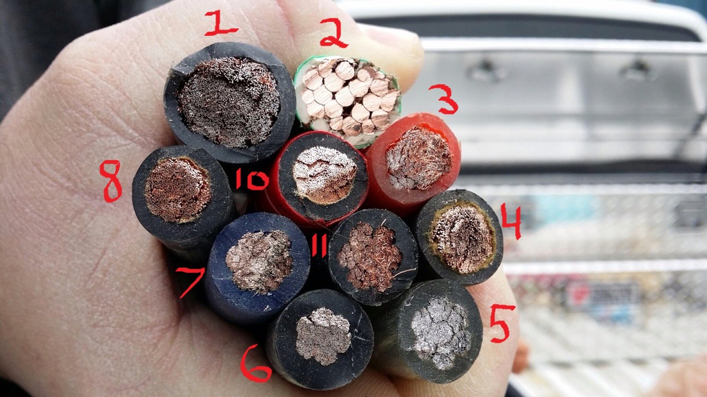

    Over the years I've read most electrical threads on the HAMB. Not having the knowledge of how it works and the constant correction of how things are done I just gave up. Name ANY electrical related topic and there are several ways of doing everything, putting your money on any reply and having it contested by another, just isn't worth the risk of the fire. There is no rule about finishing a project and driving it. The good times were back in the 1970's, body repair, and painting other peoples Cl***ics, Great Tines.

    I get it, it seems like comments on what should be solid, simple answers end up being "which Green is best? " arguments.
    The fire thing you always fall back on is unrealistic, though. There are guidelines that can be followed to prevent you from overloading a circuit and causing a fire. If you connect your 12 volt battery to ground and the starter with speaker wire, then turn the key, it will overload. There will be heat and the insulation or wire will melt. This is just like sticking a paper clip in wall socket.
    The arguments are usually about if single ought cable from the trunk is good enough or you want double ought or welding wire or automotive wire. Other arguments are usually of this same type. There isn't anyone putting forward that speaker wire is good. Only that one person wants 100 percent safe, another wants 125 for the rare but possible, and another thinks anything under 150 is rolling the dice.
    There are reasons for each position, but it's all not going to immediately cause a melt down. It's degrees of a level of safety above normal operation.
    Which wire is best? It depends on the exact use. If one fit all possible uses BEST, the others would not be made.
    dana barlow likes this.

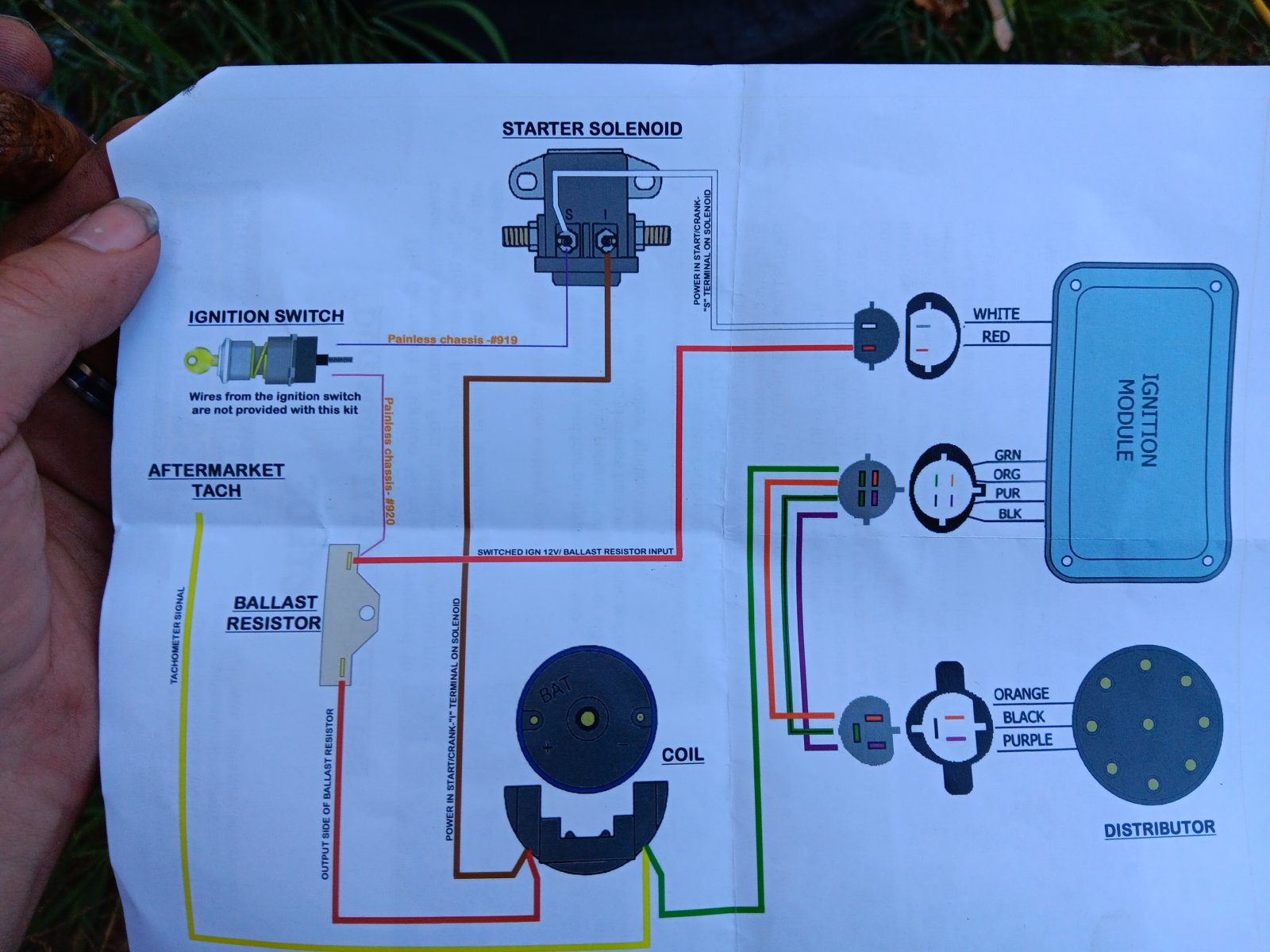

    Need some wiring ***istance.
    I am trying to wire up my engine to hear it run with a push ****on to my duraspark.
    I'm using the Painless duraspark kit 30812 and have it wired up per the diagram inplace of the ignition switch I have a momentary switch. I push the ****on and nothing happens. I was able to get it to start with a hot wire from the bat to the switch but it would die the second I let go of the ****on.
    This is the only wiring I have in the car right now
  23. pprather
    Joined: Jan 10, 2007
    Posts: 9,013
    pprather
    I don't think a momentary switch is a replacement for the functions of an ignition switch.
    The momentary switch interups the hot lead to the coil as soon as you let it go to off.
    topher5150 likes this.

  25. 24riverview
    Joined: Jan 13, 2008
    Posts: 1,122
    24riverview
    What pprather said and as shown you have no power supply to your switch. I would go with a toggle and your momentary, you'll need a supply wire from the battery terminal on solenoid to both switches then from other side of toggle to resistor, other side of momentary to solenoid S terminal.

  27. Something else is off in the wiring. The switch they show is just the starting circuit and should be not powered with the key returning to the "on" position. So a push ****on would work, just to crank the engine. Something else needs to be sending continuous power to the coil and box (big red wires in diagram) with the key switch "on" and something else needs to be supplying the switch with battery power.
  28. RodStRace
    Joined: Dec 7, 2007
    Posts: 9,031
    RodStRace
    Which is why @24riverview added a toggle switch to turn on power to the ballast!
    Kelly Burns and 1oldtimer like this.
  29. Yup, see that now.......too focused on the 1st pic.
    RodStRace likes this.
  30. topher5150
    Joined: Feb 10, 2017
    Posts: 3,769
    topher5150
    Skinny red wire coming from the starter terminal on the solenoid then to the on/ off switch. Bigger faded red wire to the s terminal and blue wire to the ballast.
