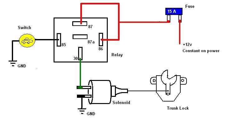

    Is this what you're talking about as far as relay(found it on the webs)?

    Yes, sort of.
    Pin 30 is normally the fused, heavy current feed. For you it can be always 'on'.
    87 is the controlled supply output to the solenoid (for you) normally.
    It will work either way, but that is typical connection.
    85 and 86 are the trigger circuits.
    85 is normally ground, 86 is normally switched power.
    In your case, the switch is on the ground side. Nothing wrong with that. What is usually done would be ACC power (for you) to the switch, then to the relay. This shortens the amount of circuit powered with switch off.
    So it will work as you had it, but all the time. It will also be 'backwards' to conventional ways these are wired.

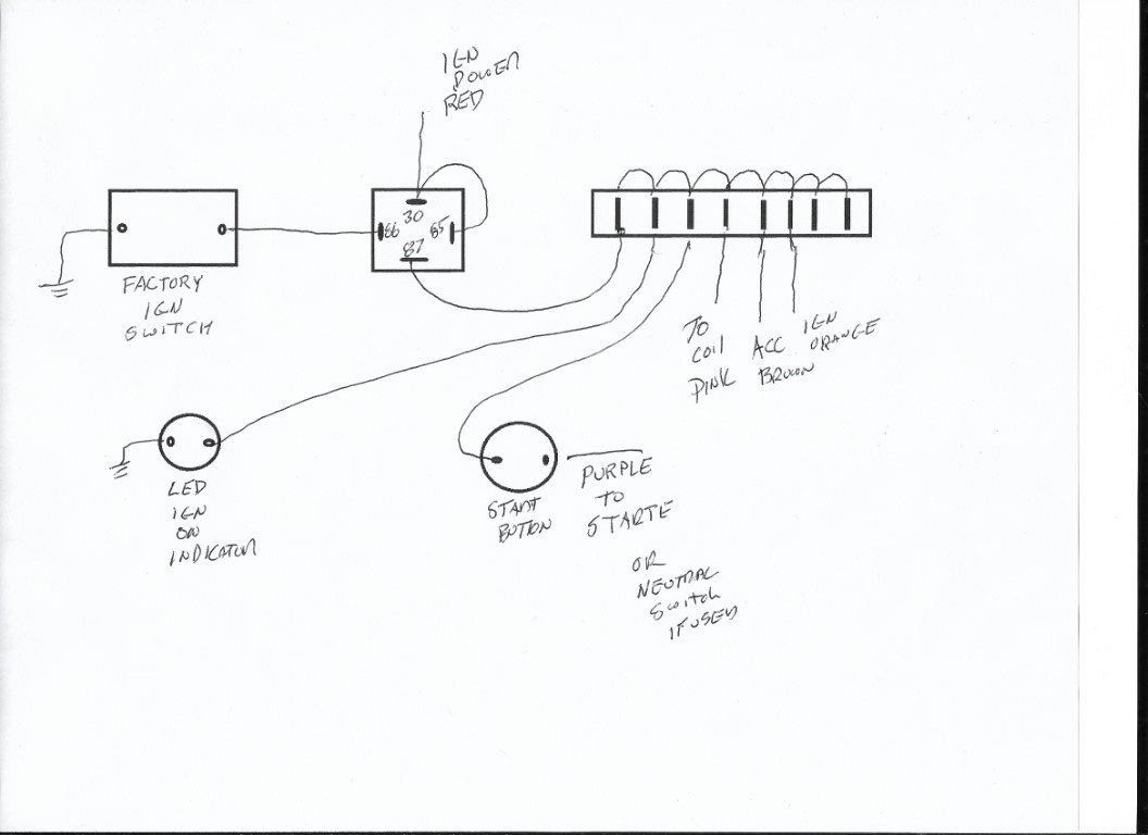

    tarheelrodr
    First timer installing a wiring harness and need a little advice.
    I’ve read this entire thread probably 6 times over the last month or so and I’ve gotten a lot of great info but not the specific answers to my questions about terminating the ignition wire bundle (IGN SW PWR, IGN SW ACC, IGN SW IGN, IGN SW START, IGN SW COIL) to my 34 Ford pickup OEM ignition switch (on/off).
    The details:
    Rebel wire 9+3 harness
    34 ford pickup column drop with 2 position OEM ignition switch
    Push ****on start switch with 2 posts
    Small led indicator light to remind me ignition is on
    Ford style 4 post starter solenoid
    Stromberg efire dizzy on 59A flathead
    Pertronix flamethrower 1.5 ohm coil
    Facet electric fuel pump on momentary toggle (backup fuel pump)
    I gather from reading this thread that the IGN SW PWR red wire should terminated on one post of the ignition switch. The IGN SW IGN orange wire and the IGN SW coil pink wire should be terminated on the second post of the ignition switch. Also I will need another wire (purple) from second post on ignition switch to push ****on and then another purple wire from start ****on to S post on starter solenoid. This will allow power to IGN circuit on fuse panel, 12v to coil, power to start ****on when ignition switch is turned on.. please correct me if I am wrong.
    That leaves the IGN SW ACC wire left to terminate. Now I've read in the rebel installation guide that all IGN wires must be connected for fuse panel to work correctly so my question is where to terminate the IGN SW ACC brown wire?
    This vehicle won't have power windows ,locks, e fan, wipers, heat or ac, etc. the only real “accessory” will be a hidden USB port for phone charging . And of course electric fuel pump. If I remember correctly, Jeremy connected electric fuel pump circuit to one of the unused fused connections and I imagine it is a keyed hot maybe powered by IGN SW ACC? I'd have to look at panel to see where the fuel pump wire goes. So I am thinking the IGN SW ACC brown wire also needs to be terminated on the 2nd post on my ignition switch?
    Thanks in advance for your advice.

    I would reconsider using your original ignition switch directly. You should use the stock switch to activate a 30 amp 5 pin relay. The brush in the original switch may not like the additional load.
    Run IGN SW PWR (red) power wire to 30 and with a jumper to 85. Connect 86 to one terminal on the ignition switch and ground the other terminal. Connect 87 to a small terminal strip. Connect ign (orange), coil (pink) , acc (brown)to this strip. Connect a wire from the strip to you start ****on, connect the starter wire (purple) to the the other side of the start ****on. Connect your led indicator light to the strip. A cell phone plug can be connected to the terminal strip if desired.
    Find the fuel pump wire in the harness and run that to your momentary switch and then on to the pump.
    Just Gary and pprather like this.
  24. tarheelrodr
    Joined: Feb 6, 2007
    Posts: 225
    tarheelrodr
    Thank you for that simple solution and illustration. Got it.

    I didn't mention it; but the wire from 87 to the terminal strip and the jumper wires on the strip should be the same size as as red IGN power wire. The lead to the start ****on should be the same size as the purple wire. Probably enough excess of both in the harness to use. The jumper from 30 to 85 and the wires to the factory ignition switch can be small gauge.
    Just Gary likes this.
  26. tarheelrodr
    Joined: Feb 6, 2007
    Posts: 225
    tarheelrodr
    Thanks. Does this also mean wires in relay coming out of 87 as well as the jumper on the relay need to be same size wire as the red IGN wire?

    The wire from 87 on the relay should be the same size as the IGN power wire on 30. The jumpers on terminal strip should be the same too. If the kit is similar to others there is probably enough extra length of the red IGN power wire in the harness to provide the needed wire without having to source more.
    The jumper wire from 30 to 85 can be a smaller wire as the relay coil has a small current draw. Same goes for the wire from 86 to the original ignition switch and the ground wire from thete. A piece of small gage wire left over from elsewhere in the harness like a tail light wire or similar would do.

    Richb, I’ve been doing some online research on relays to understand how they work and why you recommend the jumper between 30 and 85. Is this what is called a negative trigger relay setup, right?
    if so, does it matter if pins 30 and 85 or 30 and 86 are jumpered to accomplish same negative or ground trigger relay?
    I am not trying to question your knowledge on this but I have a relay that came with an el cheapo start ****on control panel that is jumpered 30 to 85. Also saw other examples online but they had jumper on 30 to 86.
  30. RICH B
    Joined: Feb 7, 2007
    Posts: 6,013
    RICH B
    In this case it doesn't really matter between using 85 or 86 as the relay coil input and the opposite as the trigger.*
    In this application it seems simpler to wire as a ground trigger.
    Other cases such as headlight relays a power trigger is simpler.
    * Some relays have a internal diode across the coil to protect sensitive trigger switch contacts from a back spike when the coil field collapses. In that case it makes a difference in which manner 85 & 86 are wired. Not relevant here.
