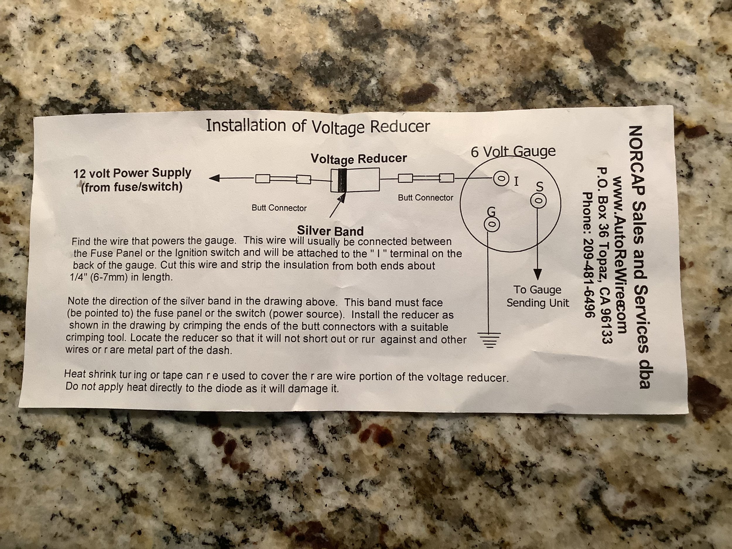

    Just wanted to say a BIG thanks to folks on this thread who guided me through my first wiring harness install..!! All wires are roughed in now and it was a huge success. Just need to loom em up.
    The only issues I’ve found are:
    1) Ron Francis headlight switch not working as stated in their paperwork. It’s a 4 way switch; off, park lights, low, high beam. When switch is pulled out in 3rd click, low beams should have power but both low and high have power. I called them and they sending me another one.
    2) my dash mounted oil pressure gauge is not working. The one threaded into the block is working. Dash gauge is a vintage SW 6v gauge with an inline voltage reducer installed. I’ve not started engine to let it run, only turned it over with coil wire disconnected. With ignition switch on, I getting 8.66 volts to sender and 5.74v to gauge. Any ideas?
    Just Gary likes this.

    Please provide more info.
    Like this?
    www.ebay.com/itm/396361691969?msockid=135791a3119469b22d5887ec10c068d4
    Car is 12 volts, with a big honkin' alt, right?
    The inline voltage reducer is before gauge and/or sender, right? Should be 12v in, 6 v out. Depending on the meter used this may vary, depending on the reducer.
    Which way does the sender work? Usually they are zero ohms at zero pressure, higher resistance at higher pressure. However, different manufacturers did things different. How many wires on sender and gauge?

    Yes 12v system on pickup with 90 amp alternator. Inline reducer at gauge. Power to gauge is daisy chained from another 12v gauge not direct from fuse panel. Gauge has 3 terminals; ground, ign, sender. Sender is SW #279-A and I have 1 wire connected to it. I do remember calling SW to get proper sender for that gauge. Can’t find my notes on ohm specs.

    Okay so, keyed 12v power to gauges, this gauge is supplied roughly 6 volts input
    , along with a ground and a sending unit wire.
    I don't know how you are getting more voltage at the sender.
    Since the sender unit is a single wire variable resistor to ground, the gauge should see 6 volts, the wire from the gauge to the sender (disconnected) should be the same.
    You can leave the sender disconnected and connect your meter to the sender connection not the wire and ground in OHMS. It will show the resistance at zero PSI.
    Speedway says this sender has 240 ohms resistance and 80 psi.
    SW says 240-33 ohms.
    https://www.stewartwarner.com/products/sender-pressure-279a/
    same here.
    https://vehiclecontrols.com/shoppin...heavy-duty-thick-film-pressure-sender-80-psi/
    Crank it over again (coil disconnected) and the sender resistance should change as pressure builds.
    It may be zero PSI = 33 ohms, or zero PSI = 240 ohms. 80 PSI will be the other end of the range.
    rod1 likes this.
  17. tarheelrodr
    Joined: Feb 6, 2007
    Posts: 220
    tarheelrodr
    At 0 psi=229 ohms, at 40 psi=185 ohms
    RodStRace likes this.
  18. RodStRace
    Joined: Dec 7, 2007
    Posts: 8,757
    RodStRace
    So long as that matches the gauge, you should be ready to go.
