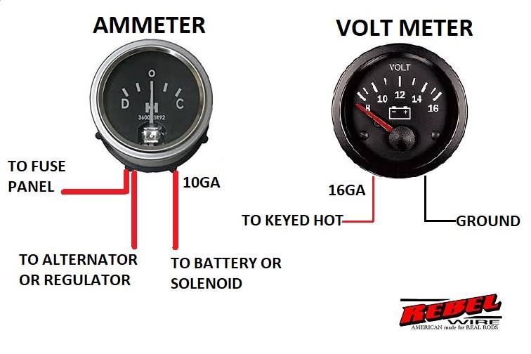

    Back on the rails this morning... I talk to a lot of guys about ammeter or amp gauge wiring. It always comes down to what you're using for an alternator/generator and a gauge. I know a lot of guys don't want that dead gauge sitting there and want to see it move, but honestly, how much is that gauge telling you or how many people know how to interpret what it's telling you? The wiring is also different: routing, size of the wire needed, etc.
    So let's say you want to reuse that old amp meter, which on most setups is around a 30-40 amp gauge capacity, because that's what the charging system used to be. Then you go in and upgrade to that one wire alternator, which is probably at least 80-100 amp. Now granted in the ideal situation, that alternator should only put out what is needed by the system, and that old amp meter should really be sitting at 0, not charge or discharge all the time, meaning you're system is using what is being put out by the alternator (like it should be). So basically if you're not adding a bunch of electronics, you might be safe using that old amp meter with your upgraded charging system, the safer gauge is a volt meter, but if your alternator ever sees the need, it has the capability to fry that old gauge. So you add in some electronics, air conditioning, electric wipers... and have all of it on going down the road, you do run the risk of overloading that old gauge. Kind of like running a higher pressure fuel pump with an old carb setup. That needle/seat and float setup might work for a while on higher pressure, but why push your luck? For those that want to know the difference in wiring the amp meter vs a volt meter, here's a quick drawing:
    So you can imagine the way that amp meter works. if what is used by the system is equal to what's being put out, the needle sits at zero. If the system is using more that what's supplied, it moves to discharge, if there's an excess over what the system needs, it moves to charge. Also if your battery was ever discharged, or you decided to boost someone off, you would see it jump up to the charge side.
    For anyone who wants to know about amp meters in depth, just call Mark at Mad Electric. Very nice and knowledgeable guy, and willing to tell you anything you could ever want to know on the subject. His website is also full of information http://www.madelectrical.com/index.shtml

    spot on about that am-meter gauge opposed to the volt gauge. Had a fire in one of my cars under the dash because of that damn thing years ago (95 or 96). I was younger and didn't know better, its been a volt gauge ever since in any car or boat I've built. very good tip for a modern powered resto.

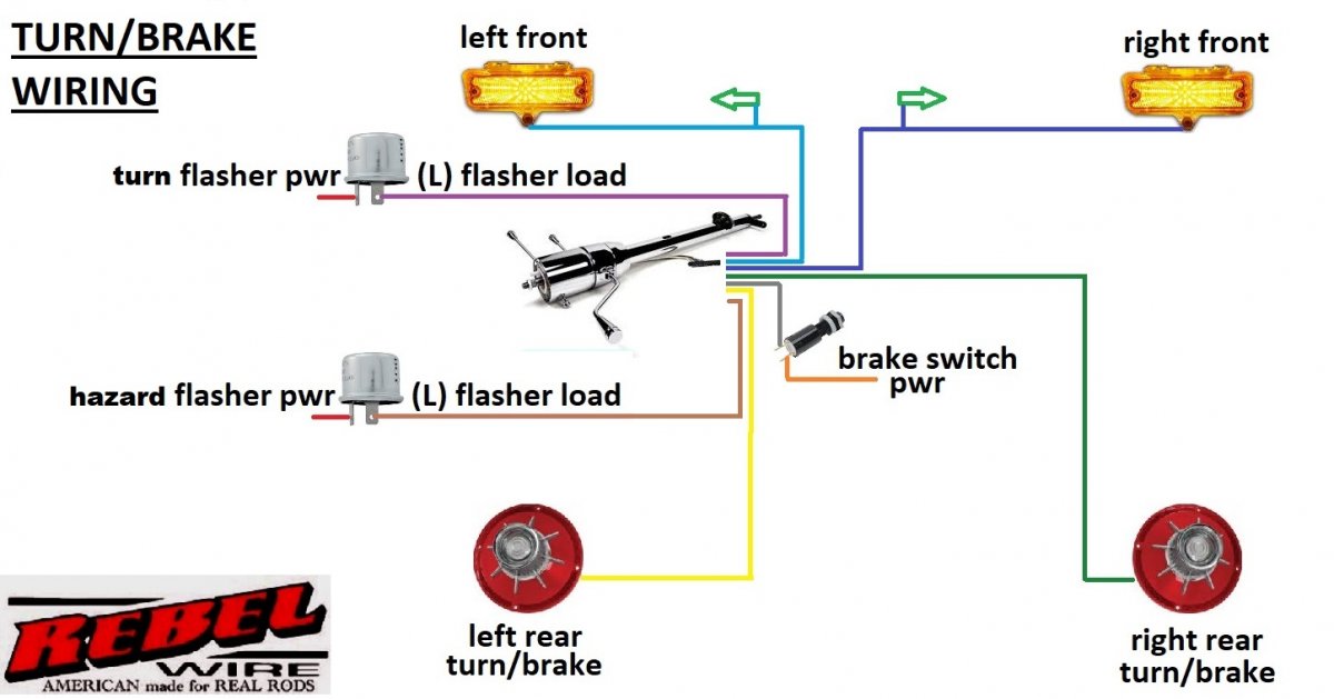

    I have a pair of reproduction 37 Ford taillights that are LED. 2 wires, a green and a black. How are they wired in for tail stop and signals ?
    I have a 3 pole flasher and also a Limeworks column mounted turn signal switch.
  17. REBEL43
    Joined: Feb 17, 2007
    Posts: 722
    REBEL43
    from TENNESSEE
    They must be self grounding, and use one wire for tail lights, and the other wire would be stop and turn. Your turn signal switch has to have a brake light wire running into it, and the switch sorts out brake from turn before sending power back to the rear. The 3 pin flasher is (X power, L load, and P pilot) just like a 2 pin, but with an extra Pilot terminal for the turn indicator in the switch or a single indicator bulb. All I would do first is ground the housings and bench test the lights by powering up the 2 wires one at a time to see which wire lights up bright and which one is dim. That will tell you which wire is for running lights (dim) and which one is brake/turn signals (bright). Let me know if you need any help with all of it.
    There's a picture of 2 bulbs back up in this thread, of bench testing some 1157 bulbs. Yours would work the same way, but they ground by the housing and not by having a separate ground wire

    The turn signal switch/bulb wiring will basically wire this way, just according to your Limeworks switch colors and the 3 pin flasher instead of the 2 pin. You can see how the turn signal switch takes the brake switch power and sorts it out before sending power back to the rear lights. If it didn't do that, everytime you hit the brake, it would over ride the turn signals and just go solid instead of being able to blink one while the other side was solid

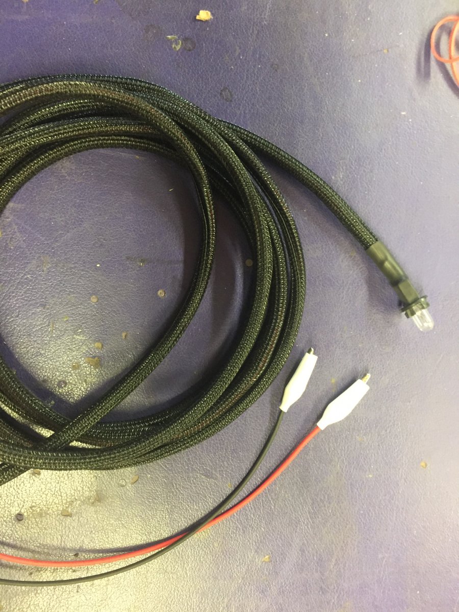

    I was reading an article from Rod & Custom 2009 article. It was telling how to check for a short. The technique was to remove the negative battery cable and clip the negative side of a test light to the negative battery cable. Then connect the positive side of the test light to the positive battery terminal. They called it a "draw test". The article went on to say if the light comes on you have a "short". In this instance how is ground being made to complete the loop since there is no connection back to the GROUND side of the battery? The cable itself is disconnected. I realize the cable is grounded to the frame probably. Thanks
  25. REBEL43
    Posts: 722
    REBEL43
    from TENNESSEE
    That’s funny, just because I did this myself yesterday. You pull either cable, only one, and the test light goes in between the cable and the battery terminal. The other battery cable stays connected to the battery like normal.
    It is a draw test, but I did mine in the negative cable, doesn’t really matter. The bulb element just lights up when you have a parasitic draw. The more the draw, the brighter the light. It’s all a complete circuit, whatever is drawing has a complete circuit when it shouldn’t, just like a switch is on, or some contacts are closed somewhere when they shouldn’t be. I actually made myself a long test light so I could pull fuses one at a time while watching the bulb to see when it goes out. When you pull the fuse for the drawing circuit the bulb will go out. So I made one with about 12ft leads so I could connect to the battery and bring the bulb in the truck with me
    Turned out mine was an interior light. Even with the bulbs pulled, but the truck also had a delay timer, so I’m thinking the contacts were probably sticking in the relay. When I pulled that fuse the bulb went out completely. That’s great timing on the question, very relevant!
    Basically you’re right that it still has a path to ground and it’s all a complete circuit. You’re just using the bulb element as an indicator to show you that you have a draw and when you’ve found it. keep in mind small draw, very dim bulb on can be normal, since you might have a small draw from something like the memory on a newer radio

    Ok so BOTH cables DO NOT have to be connected to the battery terminals to do testing.
    A parasitic draw as you called it can happen because the ground was found without both + and - battery cables being connected to the respective battery terminals. Hence the the name "short".
    Am I understanding it correctly??

    REBEL43 I don't know about the rest of the guys but I see a product there in that test lite that could me marketed and sold!

    You want both cables connected to the battery, but one will have the bulb inline between the cable and the battery terminal. So In my case I left the positive cable connected and put my test light between the negative cable and the battery post. The light came on because something had a path to ground.
    Even though both cables are connected, nothing should have a complete path to hot and ground because all the switches are “off” when you turn a switch “on” then you should have a path to ground. So with a parasitic draw it’s basically like you left a switch on and it drains the battery. I’ll recreate mine sometime today and take some pictures to show it

    I had thought about building one to use in the shop and had this draw problem come up so it was a good time to build it. Then it just kept getting fancier. It worked out great. I’m always needing little stuff like that.
