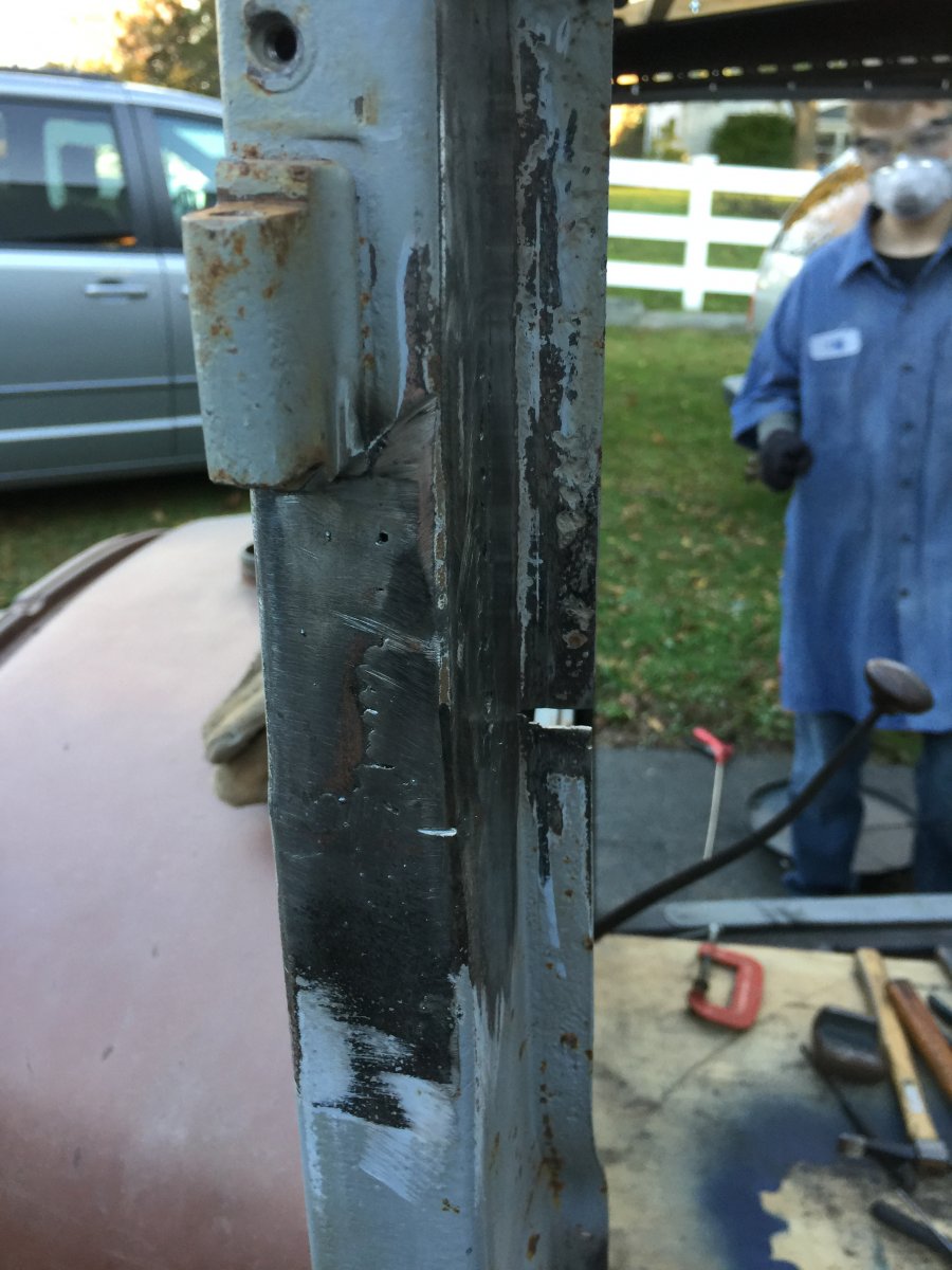

  1. nice work on the door and firewall repair

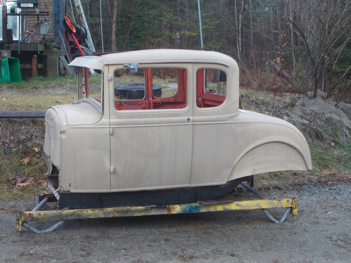

    OK, Since I finally mustered up enough courage to chop the top after reading everything I could find about it and the the Model A was the easiest one to do I'm like OK, lets get this show on the road.
    Before people post about the bracing I looked high and low and it was a solid 50/50 to brace or not to brace. No extra steel kicking around, ok, no bracing it is. Well it wasn't that easy but that's about how it went as there was more over thought and sweating about that too.
    Line up everything ahead of time, found some nice thin cutoff wheels at one of the box contractor stores .040" and .0625, nice and thin, cleaned them out. Gloves, face shield, hearing protection since I'm already deaf enough, one last deep breath and...............oh ****, gotta get the body back on the new frame.
    So, body back on, shimmed and bolted down. The body doesn't have much of its wood left and it's pretty flexible. Lets try this out and see how it looks.
    Ok, cut the top off, no turning back. SO at first I was like, WOW cool, then oh s%!#, then well before we go there lets try and get the top back on. The roof wood was from the 1st build and I left it in for strength but its going. I trimmed of the 3" pieces and then plopped the top back on.
    OK, wow a 3" chop was just right, I like it. So i'm less scared but have quite a bit of clean up work and so much welding to do.
    I rehung the doors and installed the gas tank to tighten things up. cleaned up some of the "not to straight cuts" pulled and tacked the top in place and tacked the door tops back on.
    I pie cut the "A" piller area to get them to line up and tacked them together, that seemed to work pretty well.
    At the back corners I cut two relief slits to pull the metal in and just kept t******* them till the sheet metal pulled in evenly.
    I don't have more pictures, I was so nervous, scared, concerned, and busy trying to put the top back on that I missed taking more pictures but you get the jist of it, a 3" chop looks great on a Tudor.

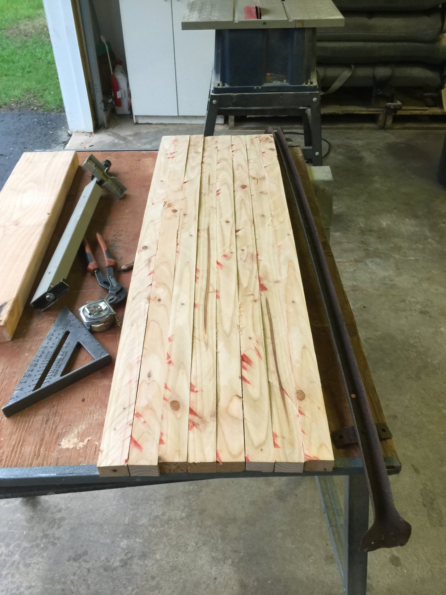

    OK, Body and roof wood. Well, I priced this stuff out because wood working is another task that I'm not proficient at. Well, at over $1000.00 for a top and body kit i'm like, oh H$!! no, I guess I'm making my own some how.
    Don't get me wrong, I can build stuff. My wife and I have remodeled most of our house including a complete kitchen and dinning room tear out but all that stuff isn't the same. No fancy band saw for the curved lumber, no router. A table saw, 40 year old Montgomery Ward jig saw, belt sander and circular saw and that's it.
    So, how much can I build and how much will it cost you ask, well I started with $100.00 worth of douglas fir because I don't think I need some hardwood for a car that will never see summer, winter and the such living outside and all. Add $50.00 worth of ***orted hardware to bolt this all together and don't forget an couple hundred tiny a$$ nails to attach the sheet metal to the wood with and draw untold amounts of blood from my fingers every time I missed the damn nail. Some stain for a really nice color and then a semi gloss urethane for a nice finish.
    I'm really happy.
    Cliff Ramsdell
    The Starting product, will it be a finished product or a pile of fire wood???

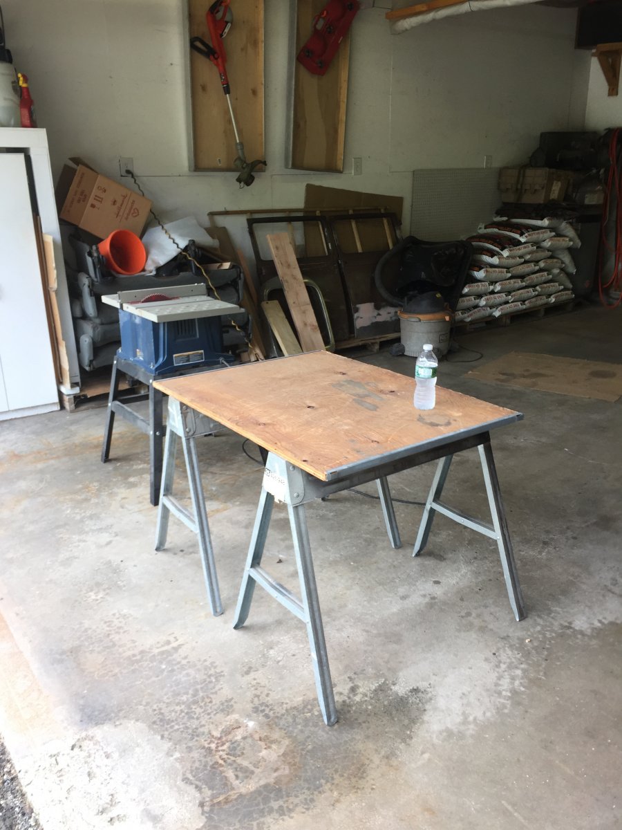

    755.JPG Like I said, not much to work with. A clean area, small table and the lack of desire to spend the money.
    I made templates for most everything. Since it had a chopped top any prints or body kits were not going to work for me anyway.
    752.JPG 756.JPG So, I started with the door posts first, next was the header which I made to accept the visor being moved up. Then the wood above the doors and rear windows, the back window wood and then the curved pieces for the rear of the body.
    The curved pieces were the worst and I tossed a couple of mistakes because the table saw grabbed them and sent them flying like a boomerang. Yes I had on gloves, yes I had on a face shield, yes, I was wearing a jacket to protect myself, no I didn't get hurt and no, I don't recommend doing it like this, I'm just saying......
    753.JPG 754.JPG 757.JPG 758.JPG 759.JPG 761.JPG 765.JPG 766.JPG 767.JPG 768.JPG 769.JPG 770.JPG 771.JPG
    I drilled pilot holes for the millon little nails, it was easier to get them in but still didn't stop my fingers from getting wrecked especially when your working upside down and in weird angles. a very small pair of surgical locking pliers helped once I got smart enough to go looking for them.

    The top wood was another exercise is personal abuse. Again I had to make curved cuts with a table saw. It's tough, the saw will kick your ****, it doesn't like doing it. I used a couple of nice sharp blades which made the task easier, set the blade low enough to just cut through the wood and made the best of it.
    I used the roof bow that's in the center as a template for the curve and went to town. The Router, that I borrowed for a buddy, was great for doing the cut outs needed to fit the rear wood and roof bows.
    T nuts were used to secure the bows.
    Cliff Ramsdell
    779.JPG 782.JPG 785.JPG 786.JPG 788.JPG 791.JPG 797.JPG 792.JPG 793.JPG 794.JPG 795.JPG 799.JPG 800.JPG 801.JPG 807.JPG 808 (2).JPG 827.JPG
