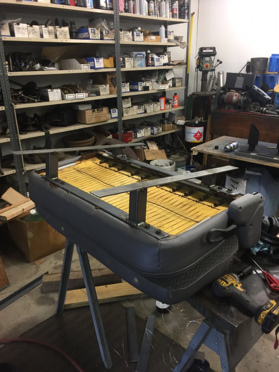

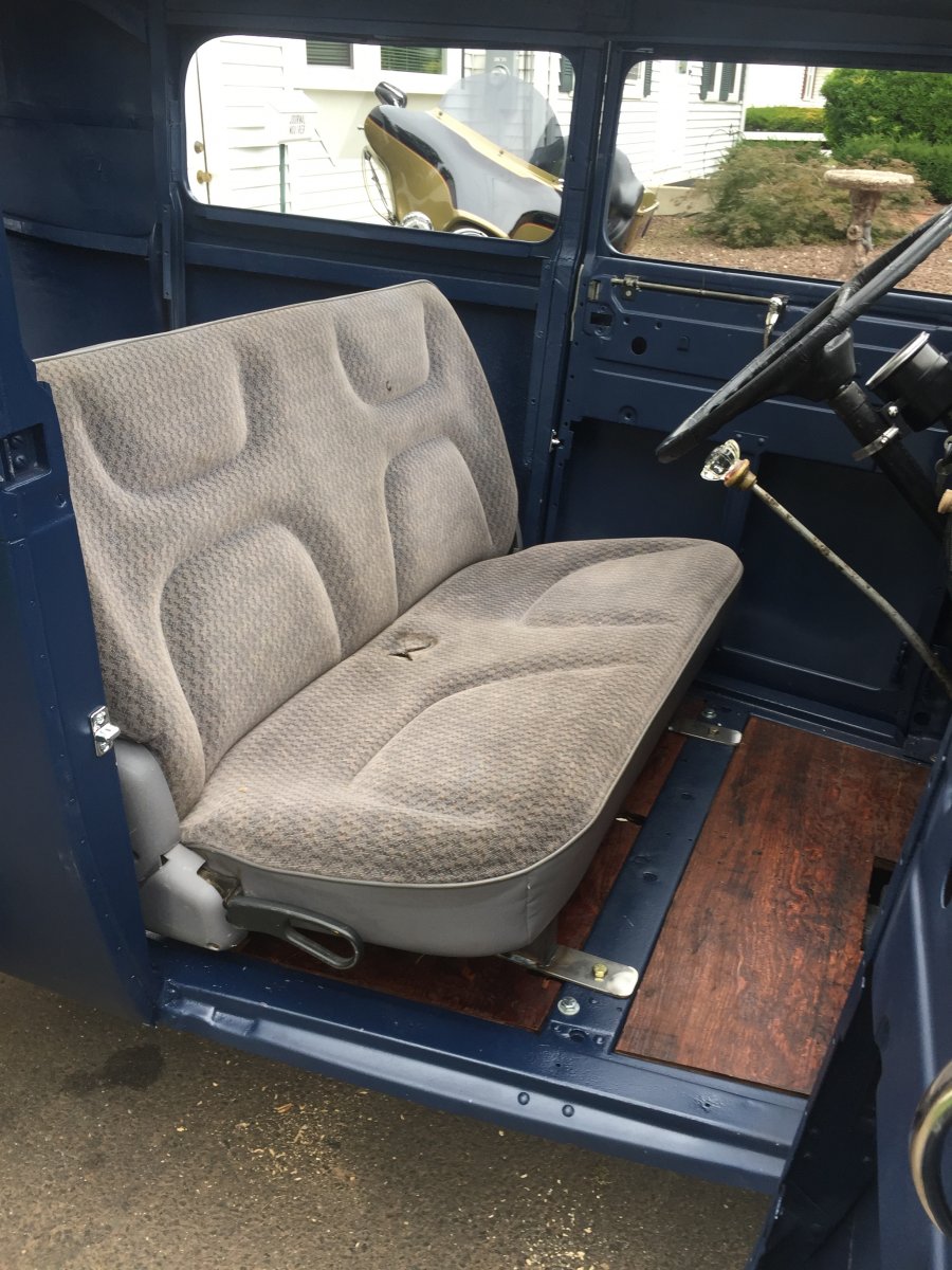

    Well, the car is moving along nicely. The dash came out nicely and the speedometer position will work. Seating in next. I went back to a stock model A tank so I could add room for a rear seat so more than one grandson (three at this time) could ride and both me and my wife could go too.

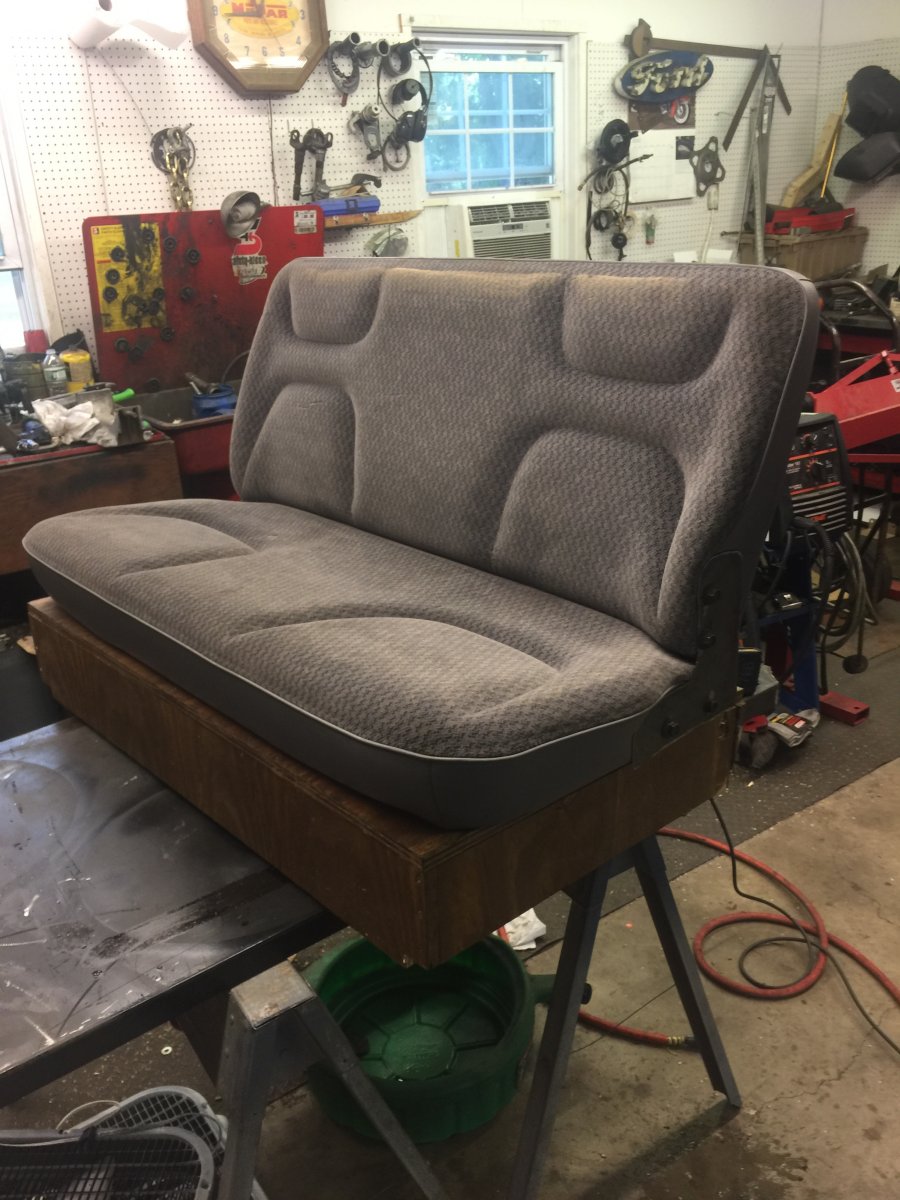

    The first build had a 2nd gen Dodge Minivan seat in there. It had a fixed back but had built in child seats with a 5 point harness. worked great but no access to the back. I bought a nice pair of 3rd gen Dodge minivan seats, a nice grey pair and the added benefit is a matched set and the front seat back will fold flat allowing access to the back seat.
    So, lets lay these things out and figure out how they will fit into the car.
    Cliff Ramsdell

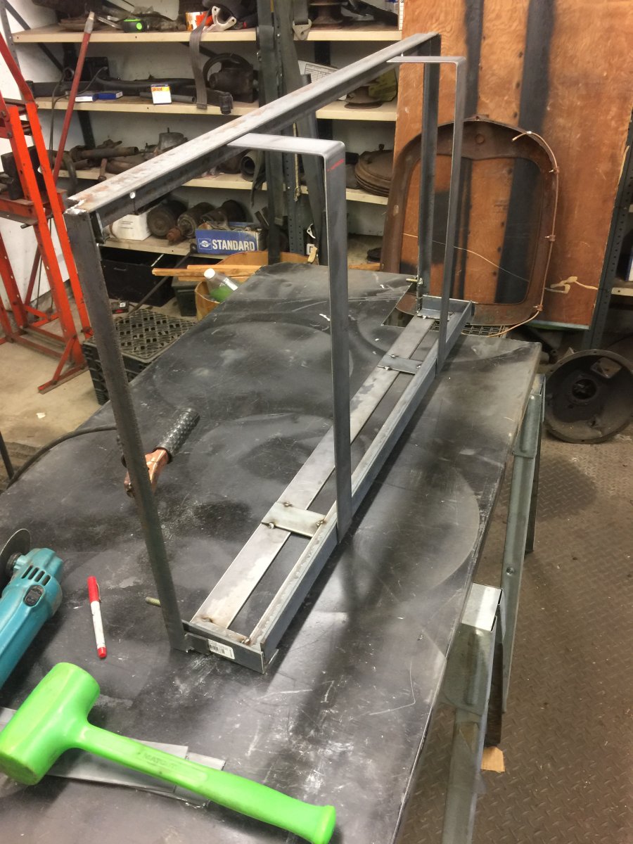

    I used some lumber to mock up seating position and height front and rear to give some nice comfort and back support, you know us old guys.

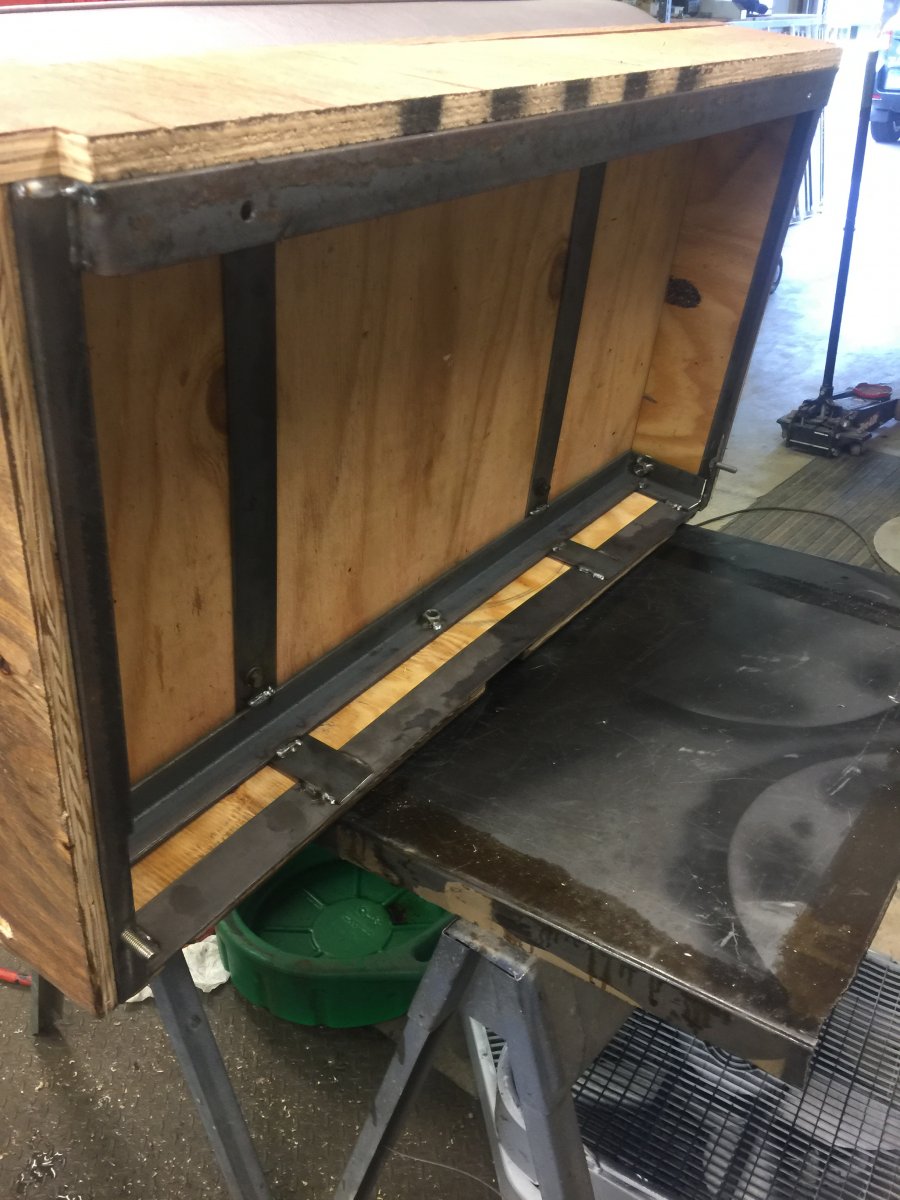

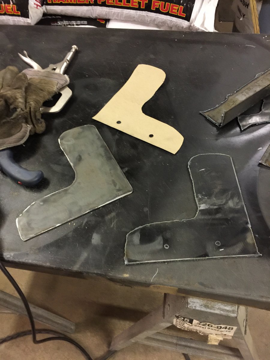

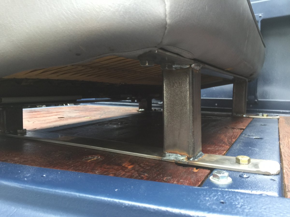

    338.JPG The steel frame is 3/16" flat stock and 3/16" square tube. I used the stock seat fasteners and made my mounting even side to side in the car.
    There is about 5" in the front and about 1 1/2" in the back. I'm thinking room for a small heater in the middle, we'll see.

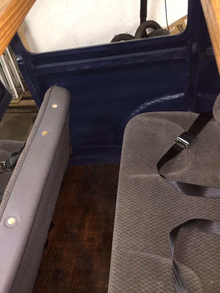

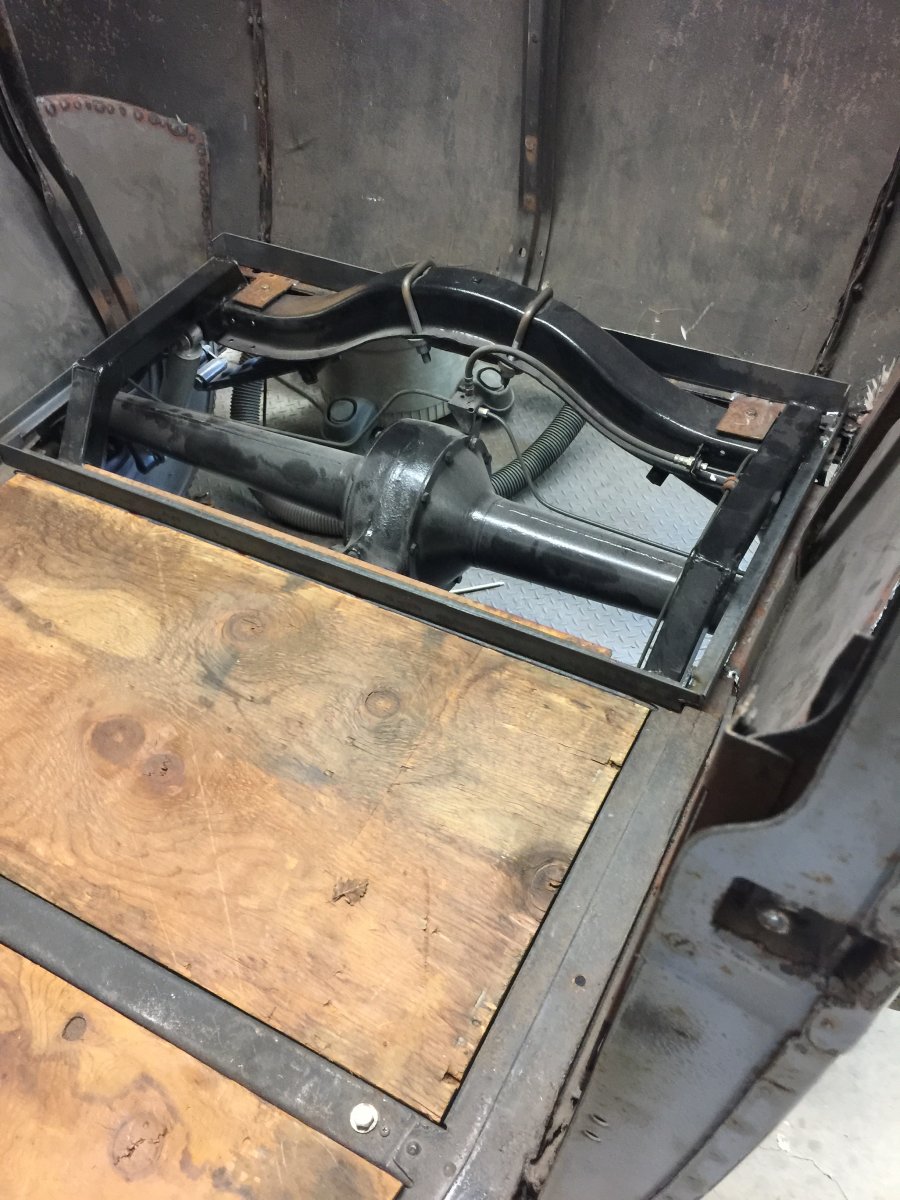

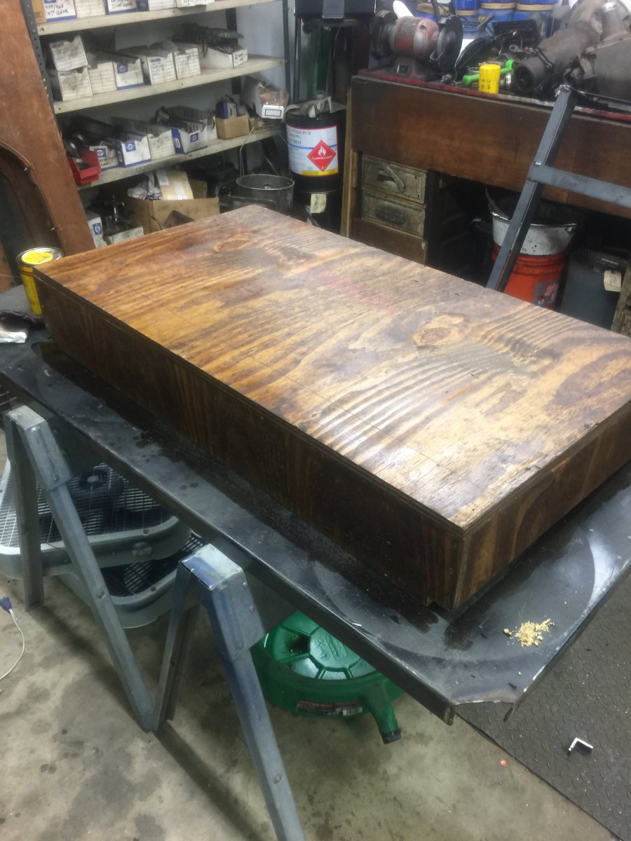

    The rear seat had the kick up for the frame in there along with the rear body mounting. I made a steel perimeter frame that has provisions for mounting the whole seat base ***embly.

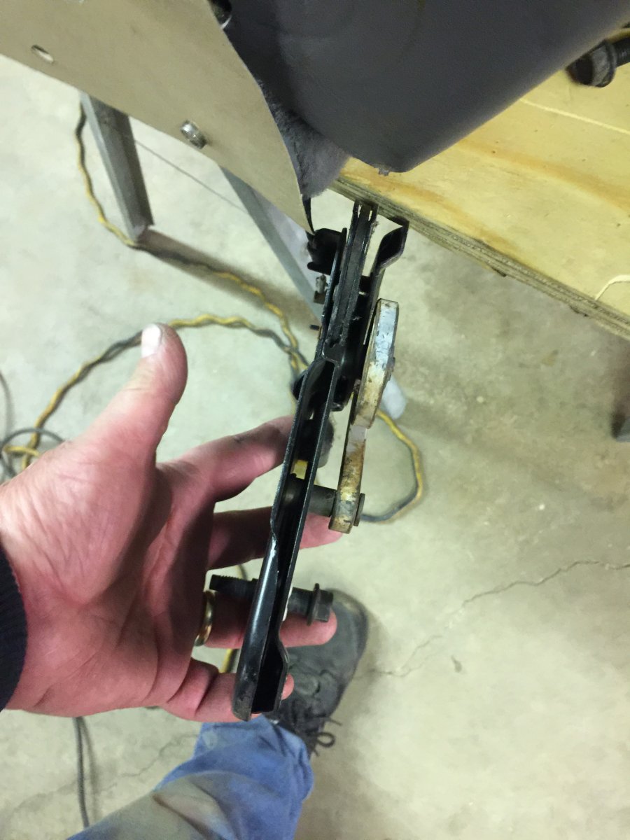

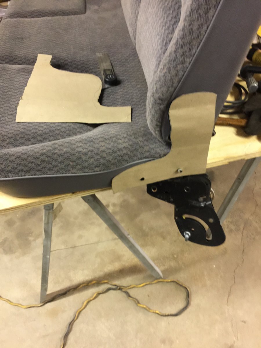

    345 (2).JPG 453.JPG 349 (2).JPG 460.JPG The rear seat from the minivan is just too wide with all the reclining hardware on them so I pulled everything off, made two flat steel plates (.140") and drilled them to match the bolt pattern of the original hardware and included a seat angle of 103 degrees. This placed the base just right and the seat back at the body with clearance for trim. I can fit my 6' 2" 250lb carc*** in the back between the seats and ride with reasonable comfort and headroom.
    358.JPG 356 (2).JPG 355 (2).JPG 353 (2).JPG With the base stained (same color as the top and floor, same but different outcome) the seat was bolted to the ***embly and the whole thing was installed into the car. Because the car was painted at this time and the top wood installed my two sons helped me out.
    458.JPG 459.JPG Mounted and new seat belts for all seating positions.
    Well, another part of the puzzle in place. Whats next, i don't know since the thread is catching up to where the car is now.
