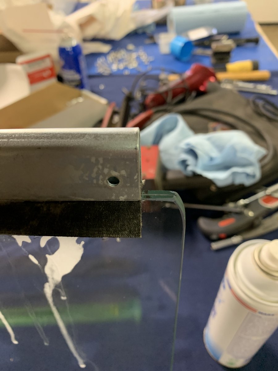

    The front gl*** is next. Again, I had nothing so I had to buy the gl*** runs, window channels, regulators, everything.
    I picked up a pair of gl*** channels from one of the specialty dealers and when I went to install them, well I thought I was going to break the gl*** doing it. No way, no how these were going on. One is bent all the **** and I finally gave up and spent the money for another pair from Snyders Model A parts.
    Gl*** on the bench, spray with gl*** cleaner, install the welting and work from one side to the other, done. Both installed in like 2 mins.
    Cliff Ramsdell
    The ones with the black finish are the "lesser quality" and the ones with the zinc finish, well I will say that they are a better product and may have cost a a few buck more but... you get what you pay for.
    As you can see this one didn't fair so well trying to install it. I only tried the one and I can't believe I didn't break a window.
    The one from Snyders was smooth as gl***, so to say to get installed. the windows are ready for installation. time to prep everything else.

    On a gl*** channel installation side note. I put the gl*** into the runs and marked the gl*** on each side so I knew where the gl*** channel should be installed. This allowed me to get it right without having to pull the channel off the gl***. I used gl*** cleaner instead of oil, its messy enough doing this job, slippery too.
    I hope all this helps someone else and that would make this worth the time posting.
