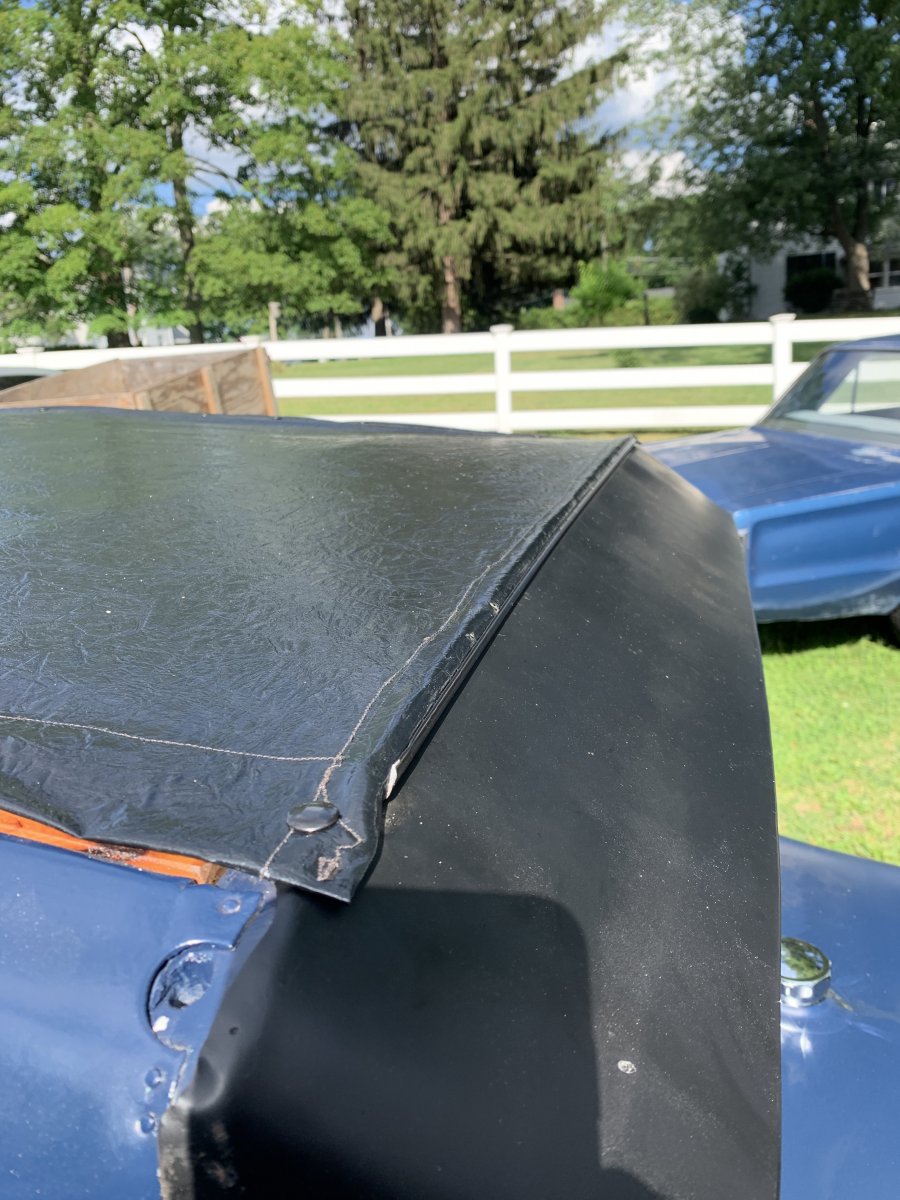

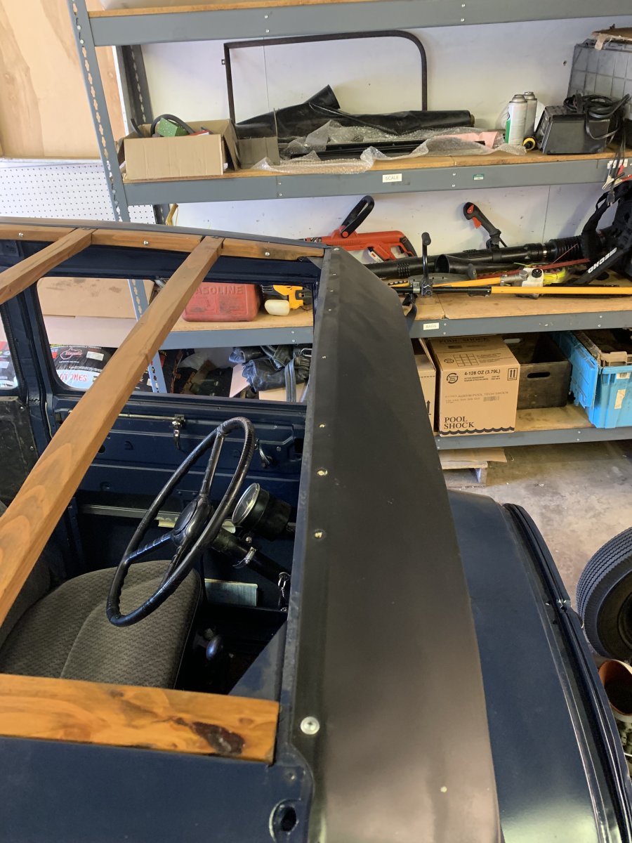

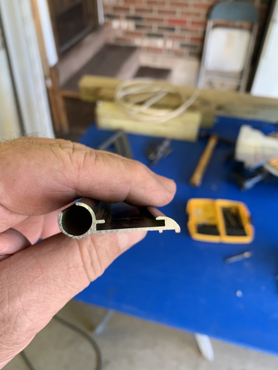

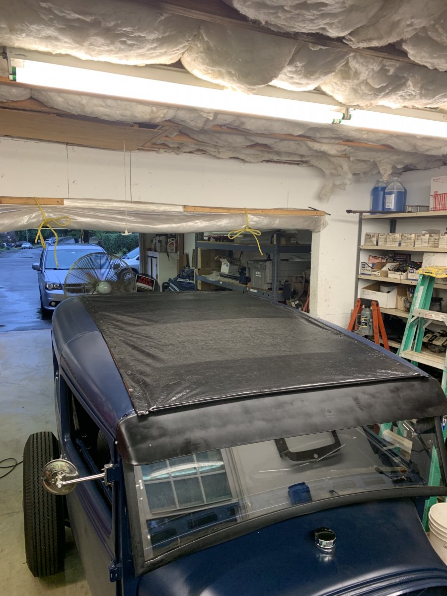

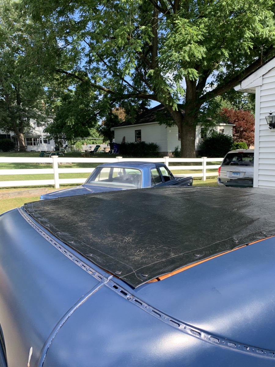

    So, with the windows in I figured the next step was a top for the car. The last setup was a piece of canvas snapped on and it was a great sun shade but offered nothing in the way of water protection.
    I picked up a roll of top material at the swap meet, a nice piece of awning trim from the local RV place and a pack of 50 black snaps and hardware.
    784C31ED-611D-400F-88BF-7E7EBE4E11BF.jpeg 7CF905B5-A116-4652-9AF3-D65DC65ABB9E.jpeg 3837CCB7-4603-48DC-9627-61DA63DDB804.jpeg D1DE0926-5CAA-42CE-A75F-565F0C0F8B99.jpeg

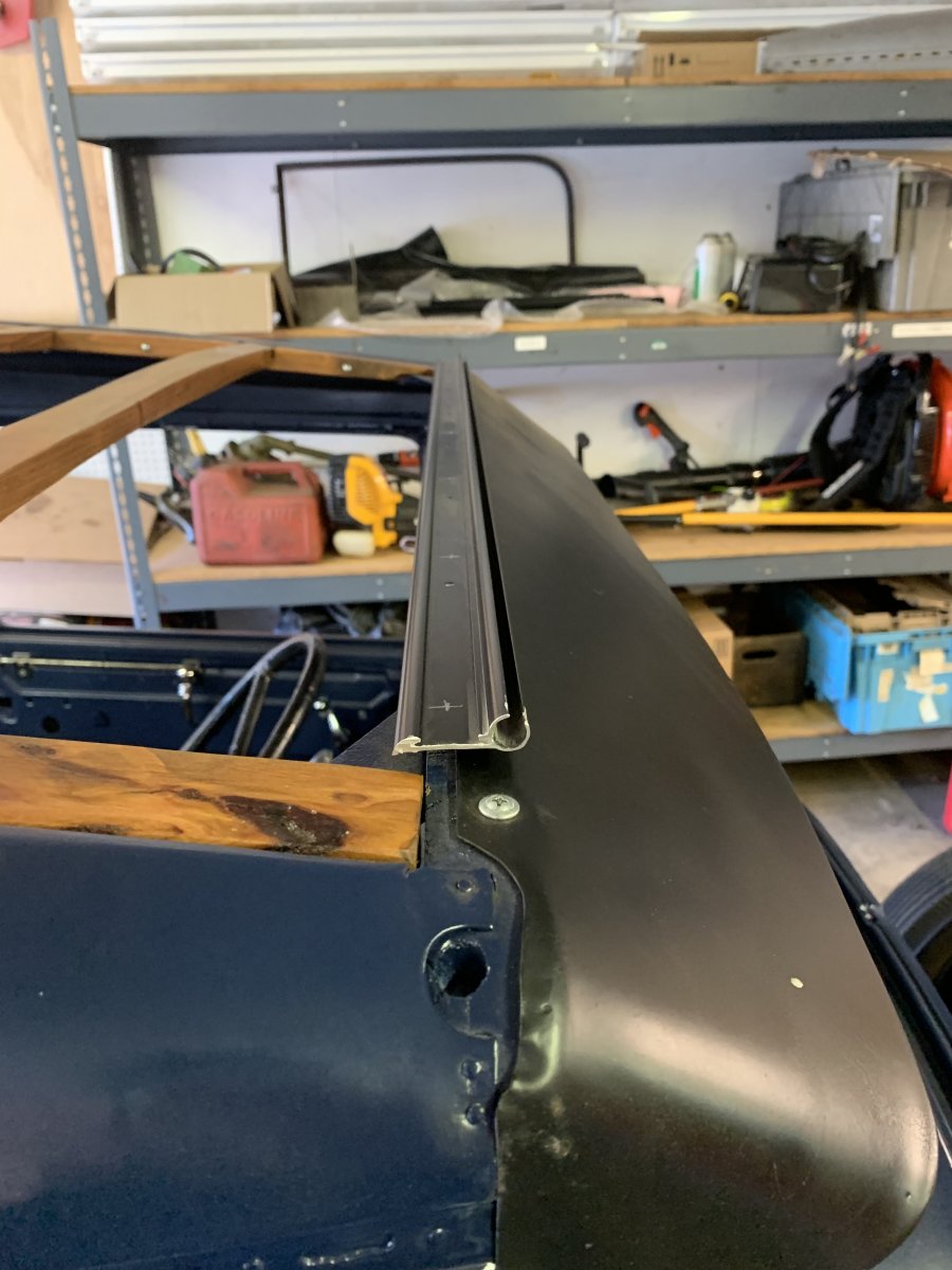

    I cut the channel the the length I wanted and attached it across the header of the car on top of the visor. I used a piece of foam (not shown) under the metal strip. The previous setup had snaps across the front that would lift going down the road. This should make things more weather “resistant”

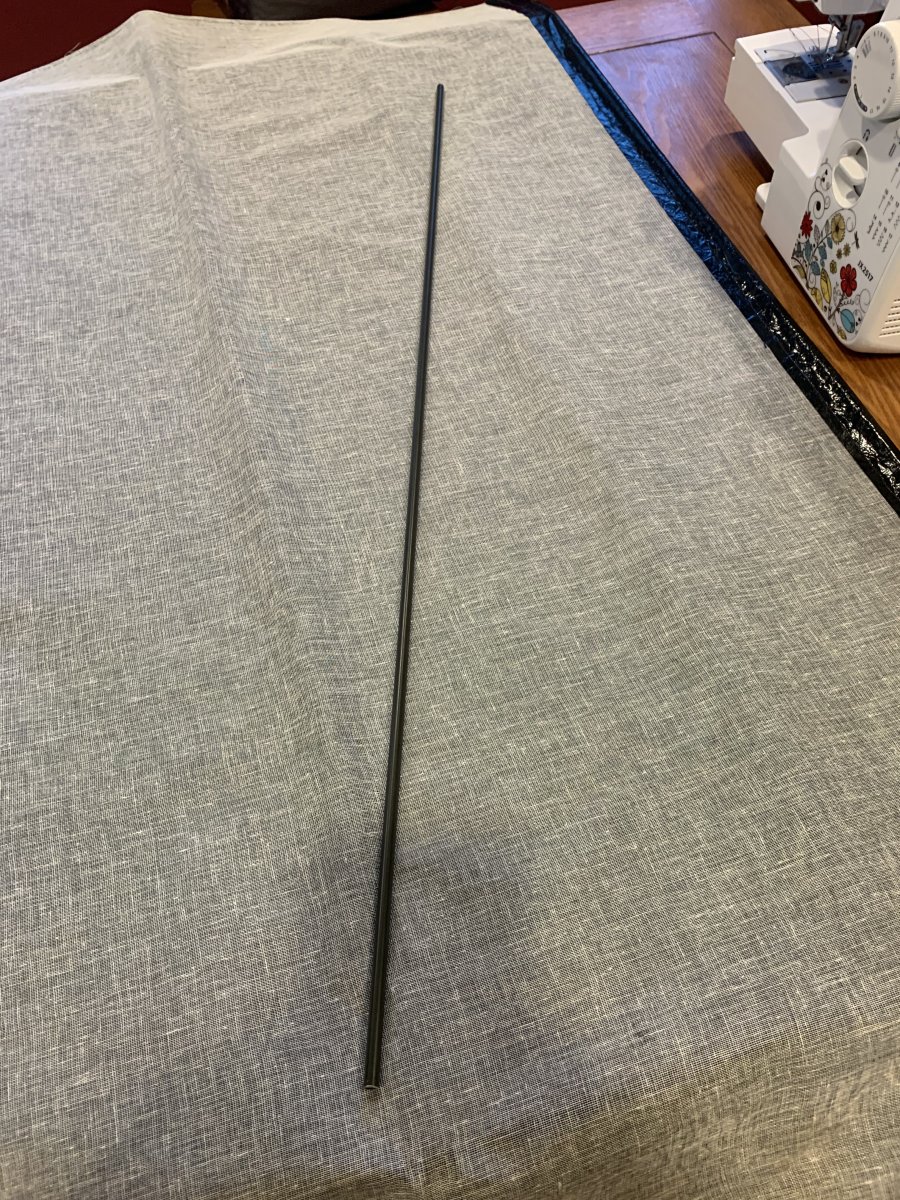

    I cut the material and made my measurements and started with the front piece. I made a s***ch and left room inside for a piece of 1/4” brake tube that I slipped into the material and now I’ll be able to slide it into mounted channel.
    522FBFF8-484B-46B8-9240-E95E47E87CE2.jpeg 3190C544-095E-4730-832C-4F722F990597.jpeg 4B701D1C-BB88-4C09-96AC-3F85782E2497.jpeg

    Next I measured the sides and folded them over and applied some sewing glue to hold things in place till I could run it through my sewing machine.
    24BAEBBC-0602-4E4E-A572-A9CE94797AC9.jpeg 8C788CCC-379E-47B0-94C8-E0D657B1B533.jpeg

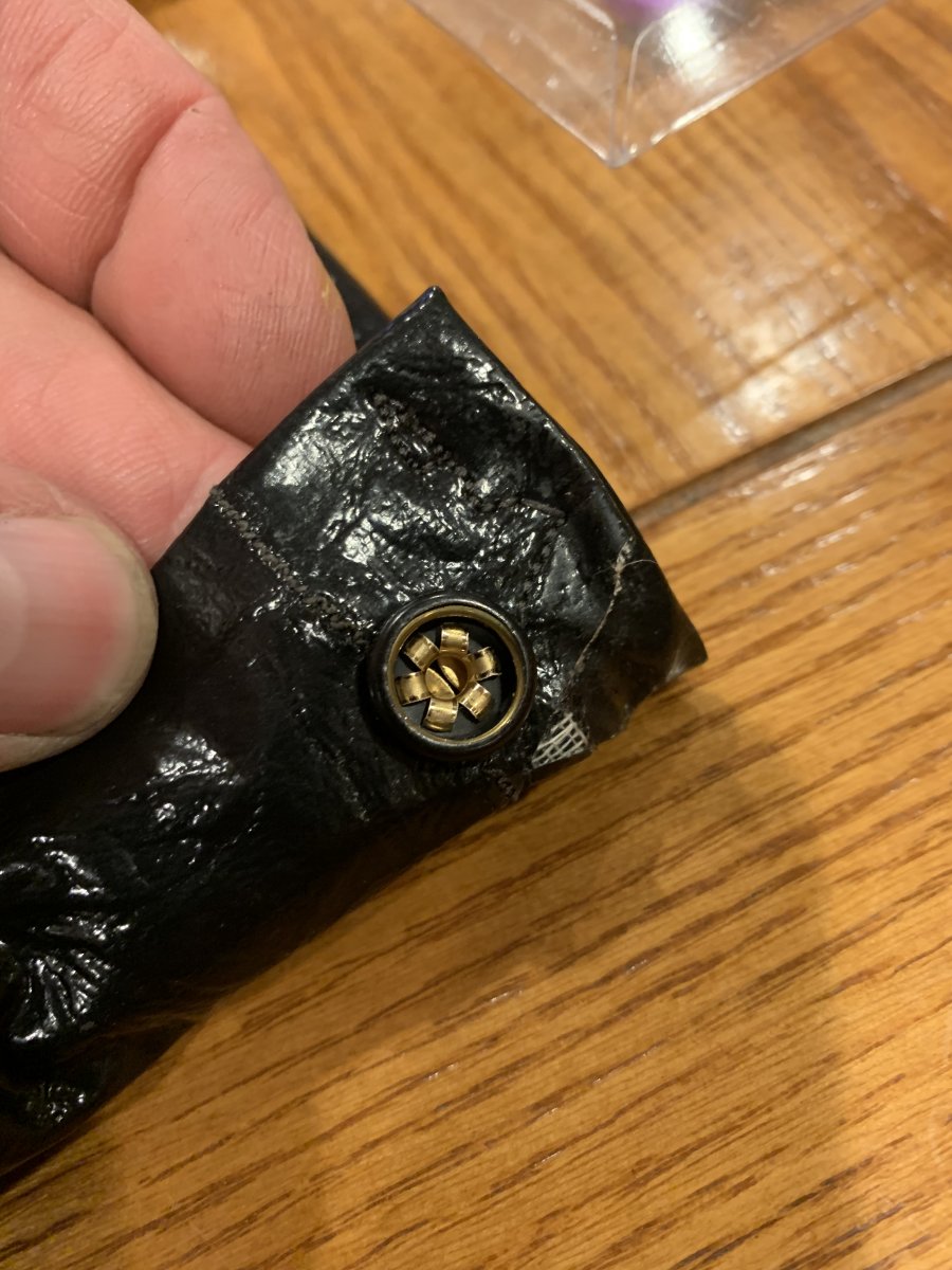

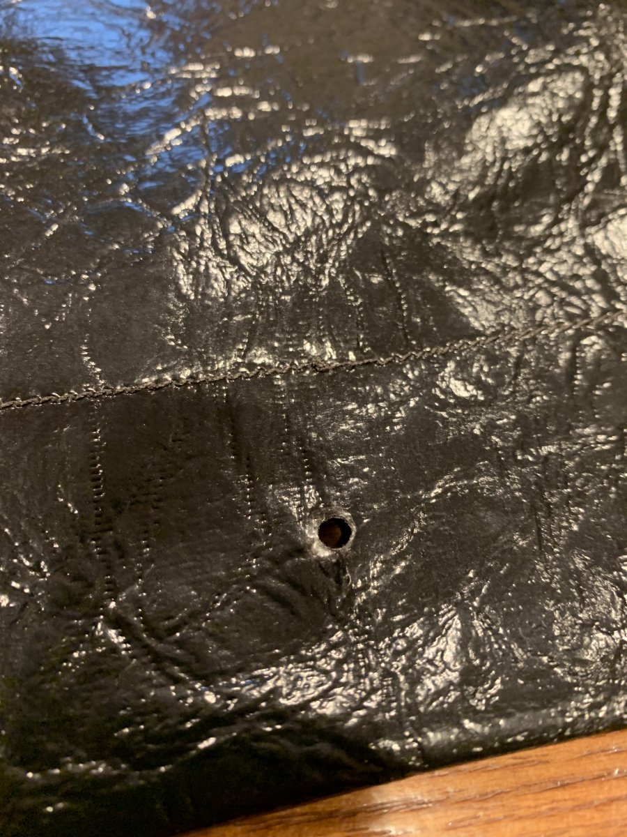

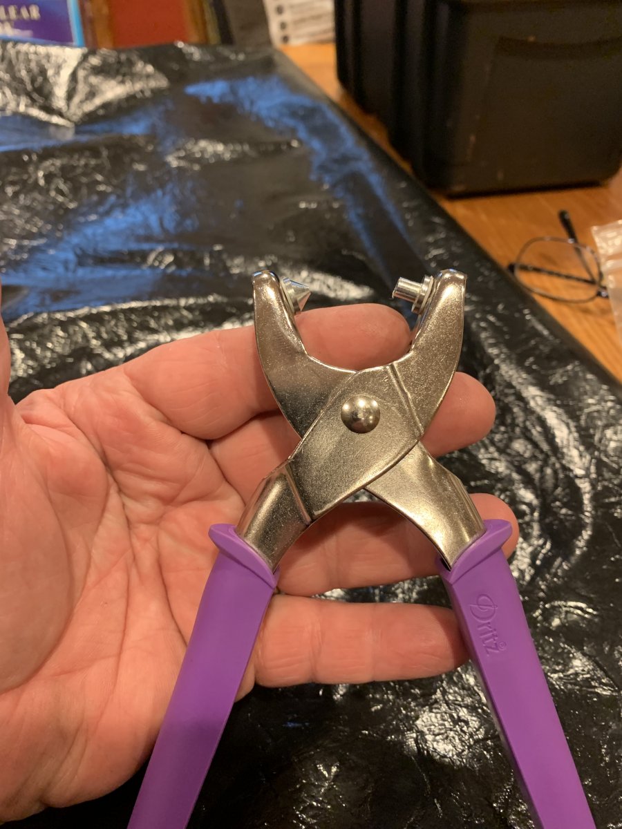

    I tossed it up on the car for fit and marked the back of the top. Folded and s***ched it up next. With all the sewing done I started installing the snaps. I premeasured and pinched all the holes and installed the top snaps.
    AB199D8A-2DF0-4CAB-B73D-B537FF4F3AC4.jpeg B5496F60-2B89-4DD6-A807-B0F1397285E7.jpeg 9D20D272-DA8B-4961-B39B-965EE291E533.jpeg 570C9AE2-6906-4CAE-97DC-411B135D4A17.jpeg 15D2F1B8-9290-48C1-8648-B58D7139D1C2.jpeg

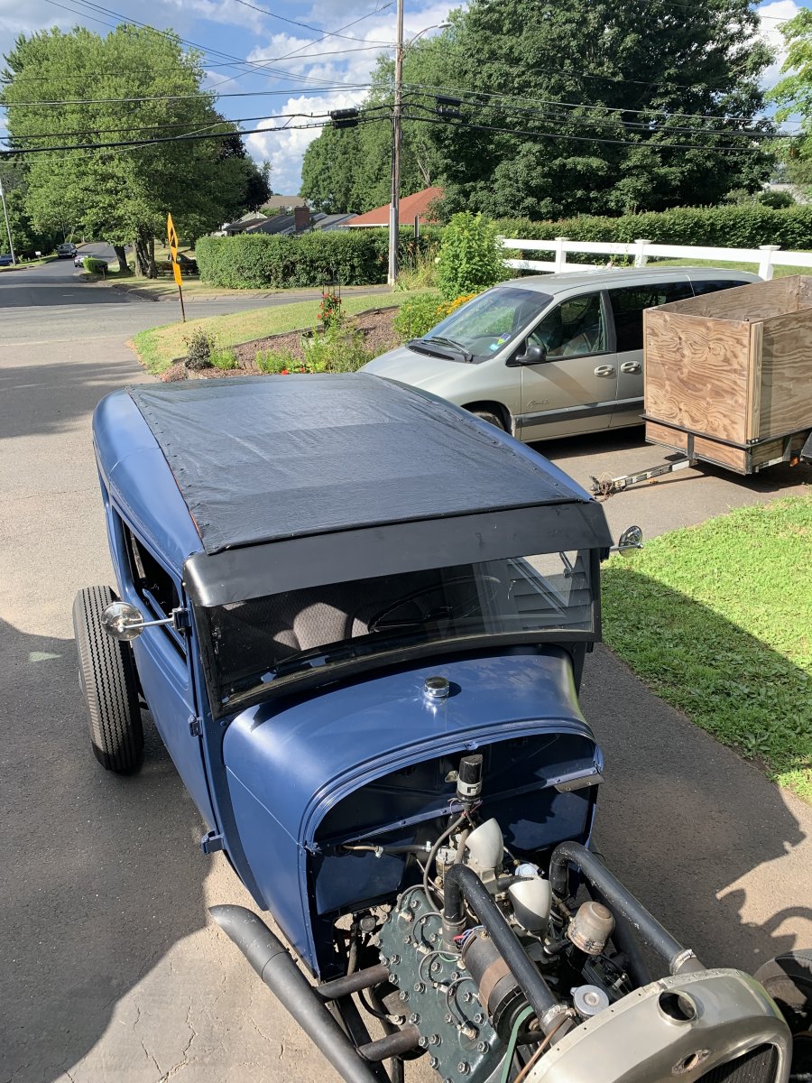

    I installed all the snaps into wood frame and then went out and installed the top. I needed a day in the sun to stretch out nice and tight and it worked great.
    7B064742-01BF-48ED-A2CA-177ACB3114DE.jpeg E9C82D7B-D60D-4CAA-8A71-BC716FAE38F4.jpeg 2E7CC691-863F-4737-9B9B-B953473A5080.jpeg 92CCFA7A-4BA9-4DAA-839A-18B8709DA3BB.jpeg DB21F81D-4F9A-4A89-83A6-5472001A7A80.jpeg 2F3F5084-A12F-4C8B-9B3F-D172A9D3EF23.jpeg C4D3AF37-028D-4CEC-87EE-1A055C529CA7.jpeg

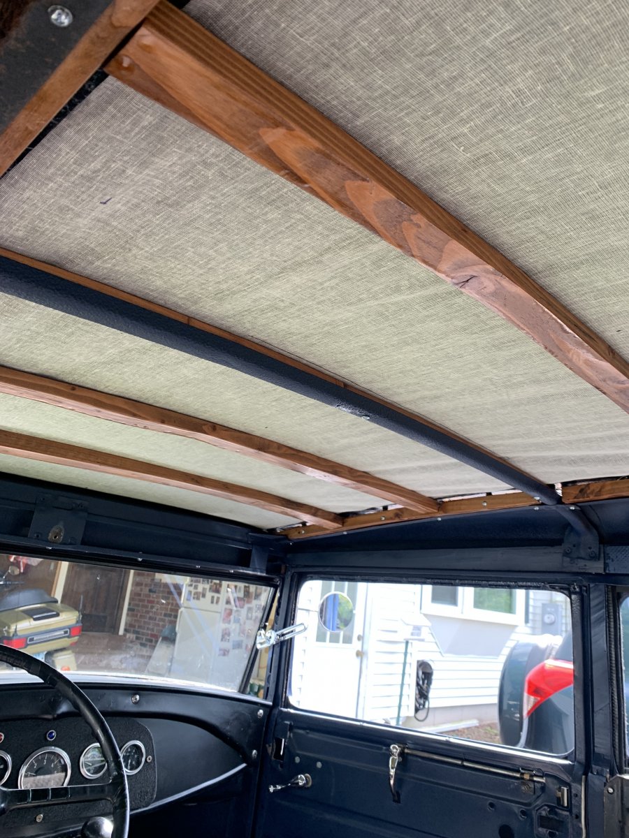

    The car has been no top for years and a dark top made it very small feeling inside the first time I climbed in.
    The gl*** and top have been great, wind noise and weather are being held at bay. I need to do weather strips and seals for door tops and doors this winter to finish up this part of the project but it’s been all over Connecticut to various places from my past and enjoying it with my wife.
    Cliff Ramsdell
