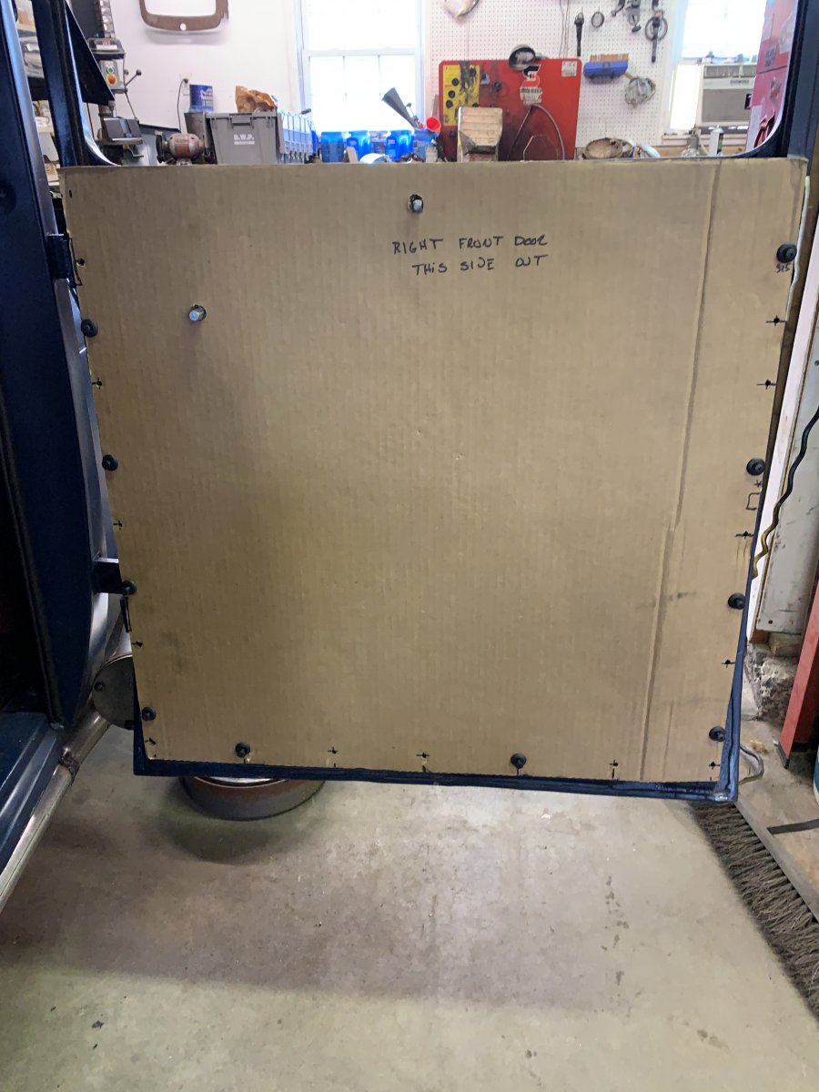

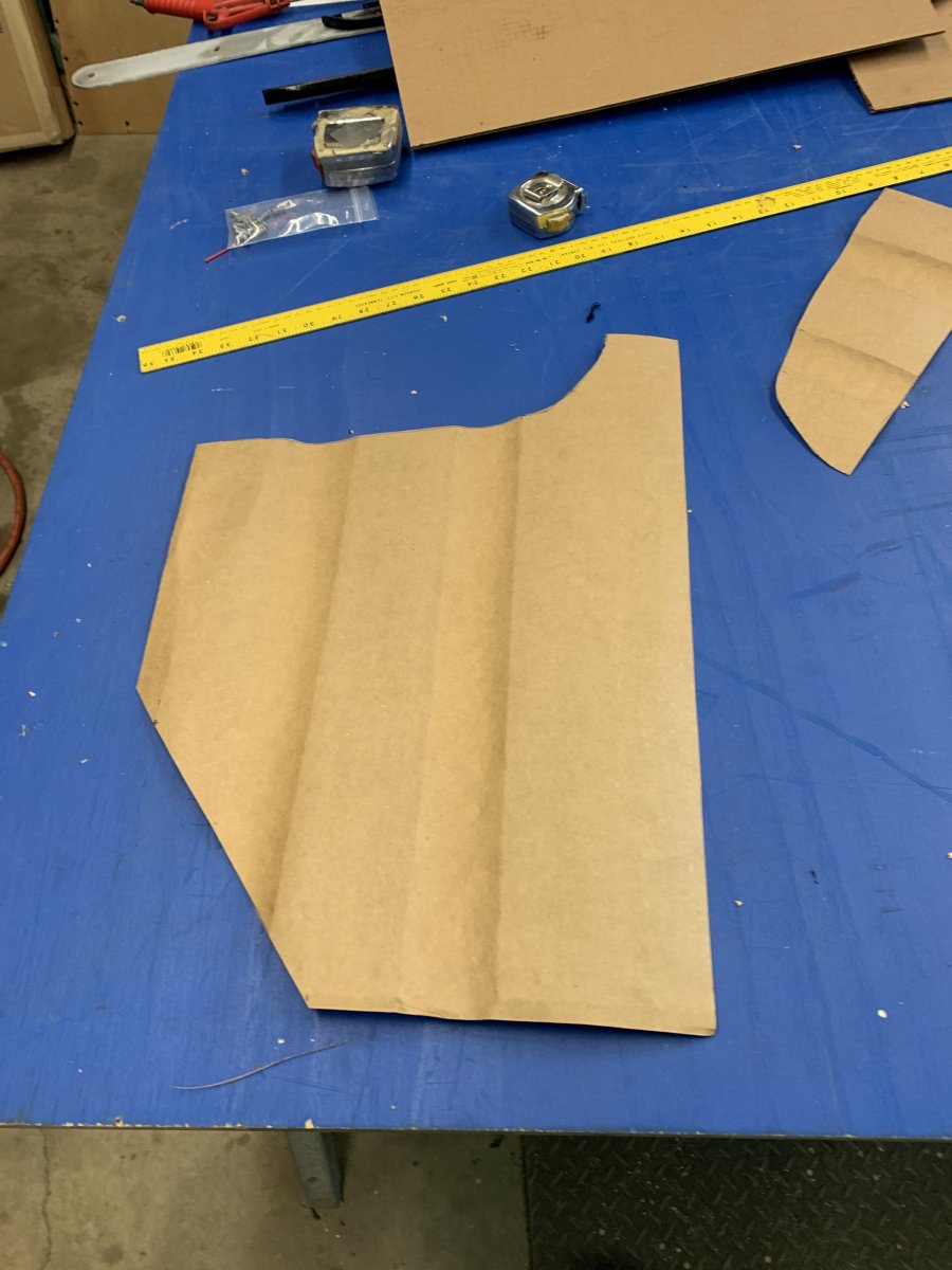

    So, interior ideas were provided by @Mr T body with his ABS thread here, https://www.jalopyjournal.com/forum/threads/abs-interior-panel-construction.1101000/

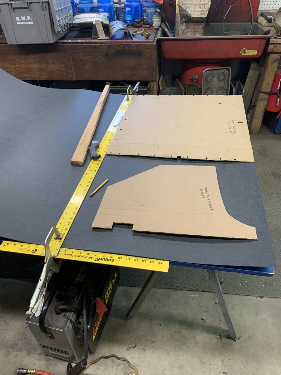

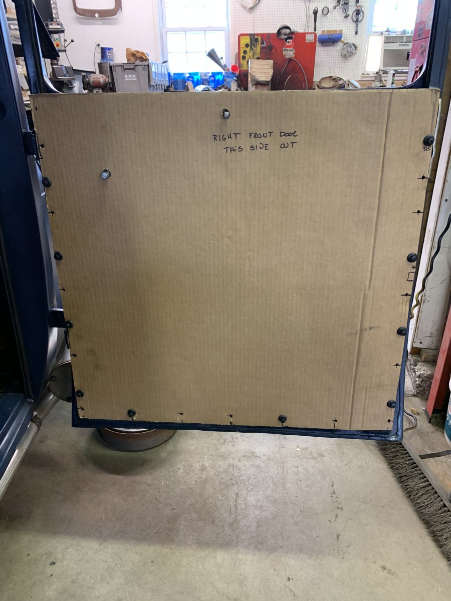

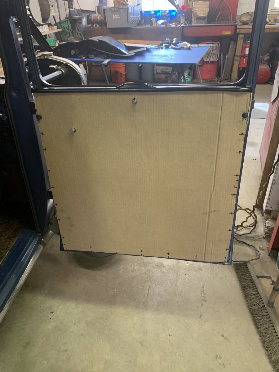

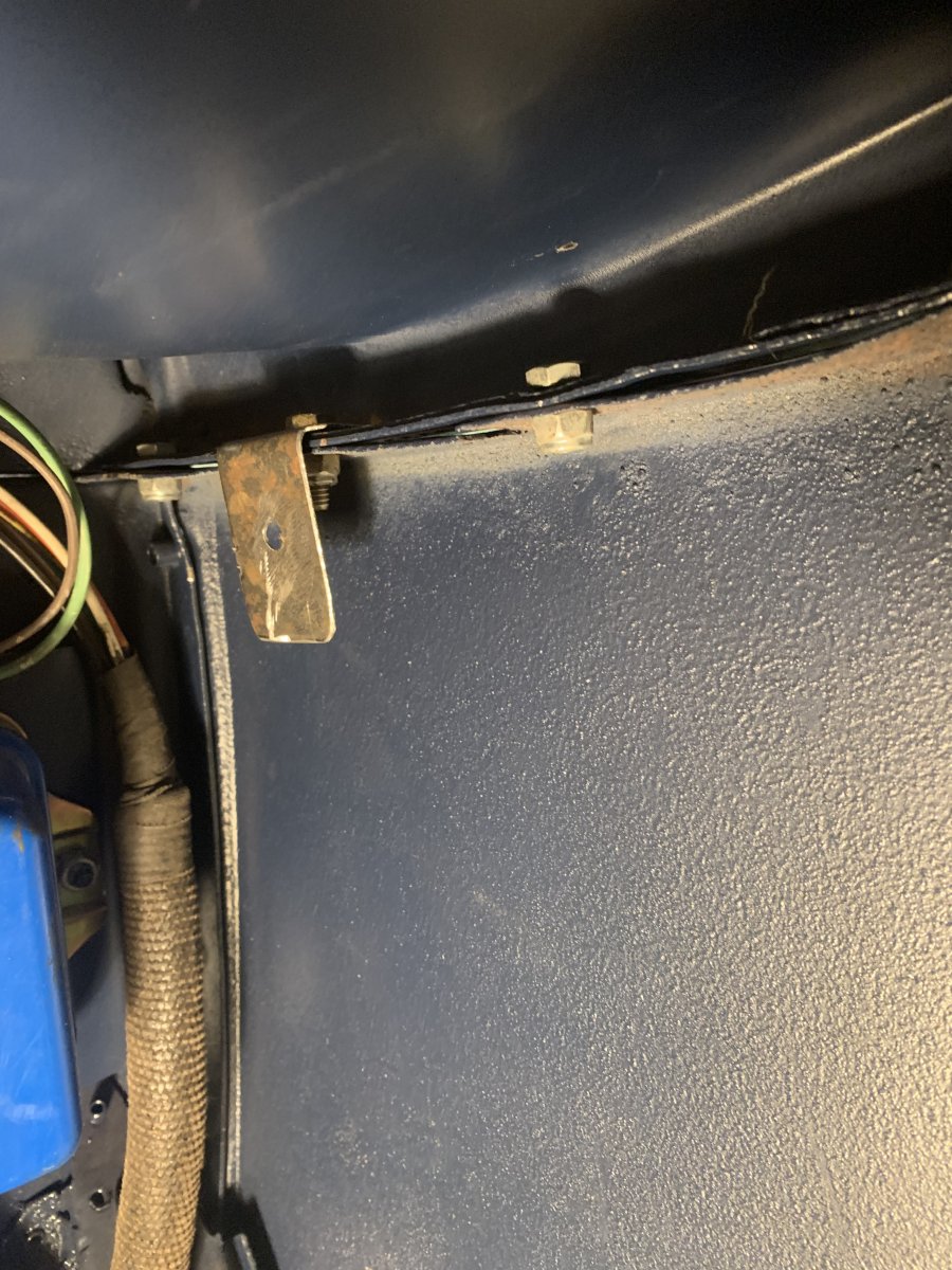

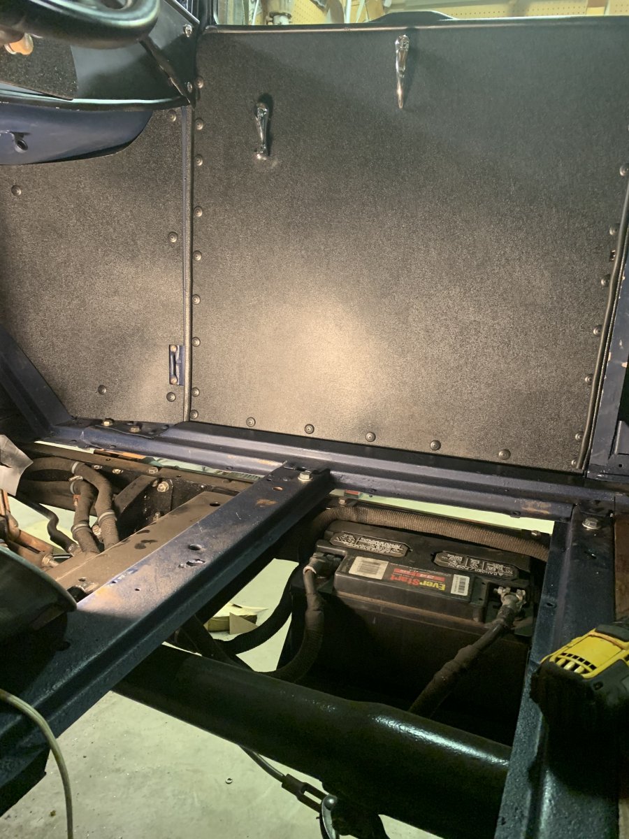

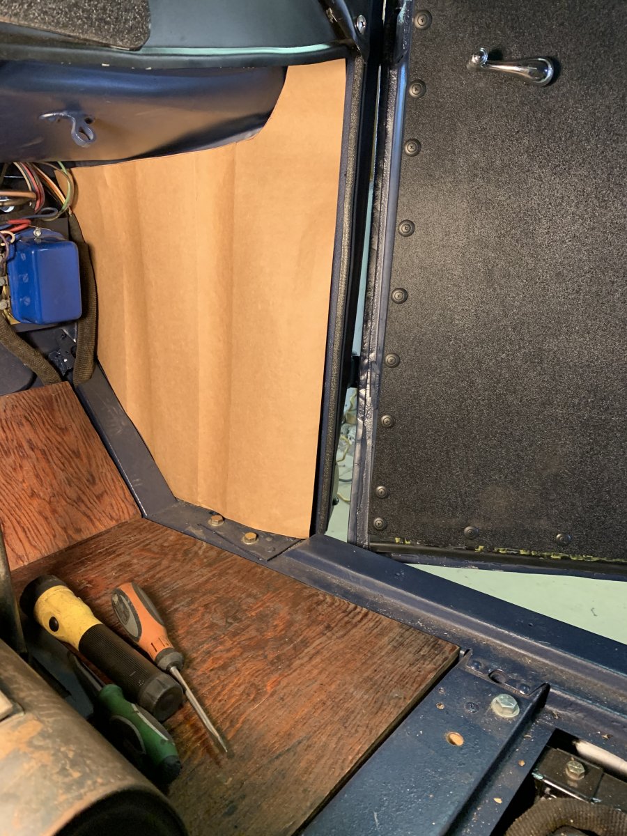

    I picked up three sheets of 4' x 8' .061" material and set about making templates and panels. Front doors and kick panels, easy, rear panels, yeah not so easy. OK, lets give this a wing here.
    Cliff Ramsdell
    IMG_3545.JPG IMG_3546.JPG IMG_3547.JPG IMG_3548.JPG IMG_3558.JPG IMG_3561.JPG IMG_3562.JPG

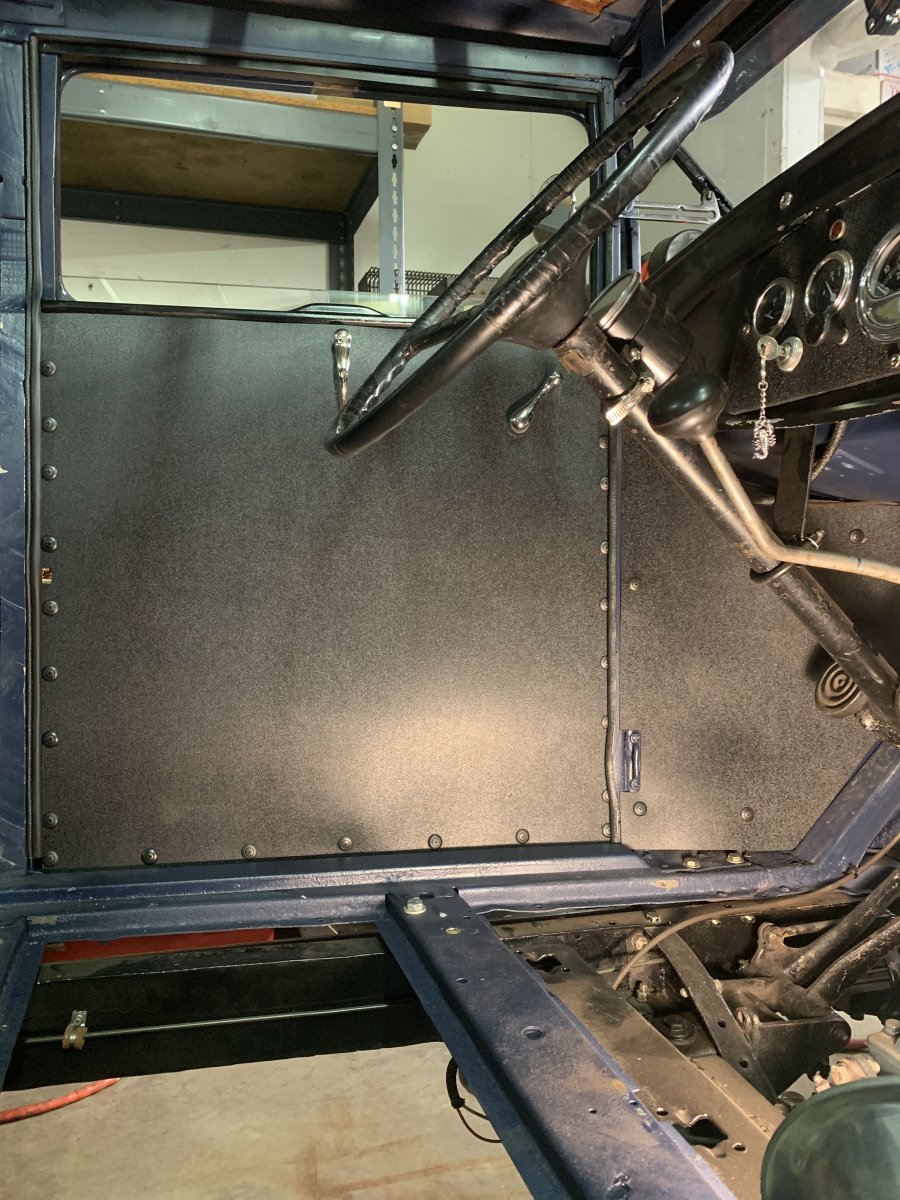

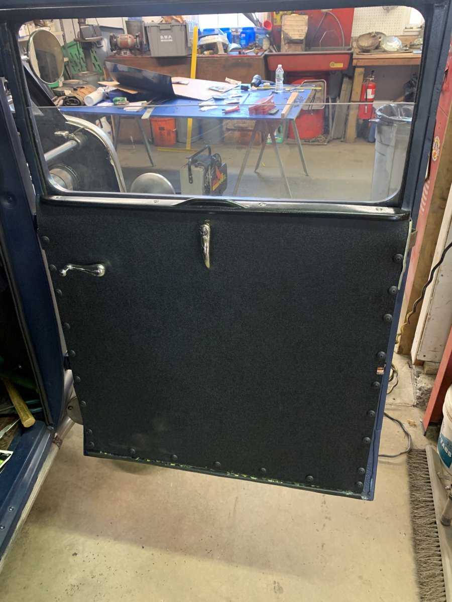

    I was able to use one template on both sides and with minor t******* that worked great. Transfer to the plastic and I used a safety knife the cut the panel to rough and my tin snips to trim the curves, worked great.
    IMG_3549.JPG IMG_3550.JPG IMG_3551.JPG IMG_3552.JPG IMG_3553.JPG IMG_3570.JPG IMG_3571.JPG IMG_3574.JPG IMG_3575.JPG

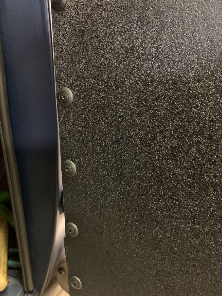

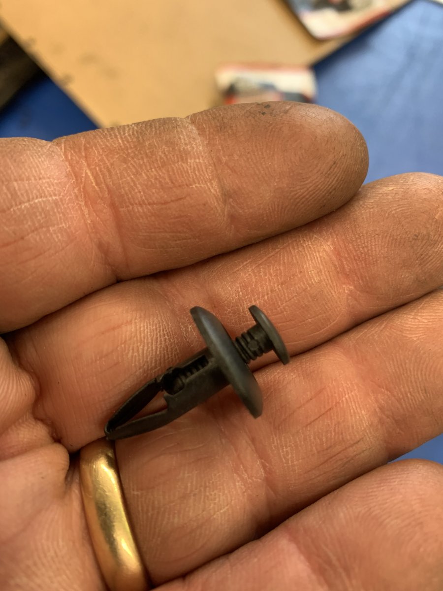

    I made a couple brackets for the kick panels and used a bunch of 1/4" plastic trim fasteners.
    hfh, 31Apickup, patmanta and 2 others like this.

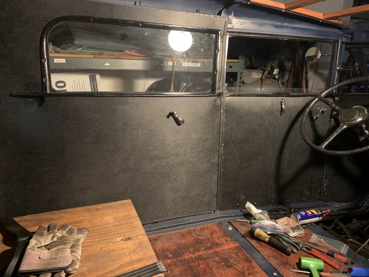

    The rear panels were a bit more of a challenge because of the curves and the difference in the angle of the curve between the top and the bottom. The top wrinkled and I will make a corner cap to fill it later.
    I used the propane torch to apply some heat to the plastic to bend it. Note to others, its easy to make a pile of s**** trim. I had enough material to over come mistakes.
    Cliff Ramsdell
    IMG_3649.JPG IMG_3651.JPG IMG_3653.JPG IMG_3819.JPG IMG_3820.JPG IMG_3822.JPG IMG_3823.JPG
    adam401, Just Gary, patmanta and 3 others like this.

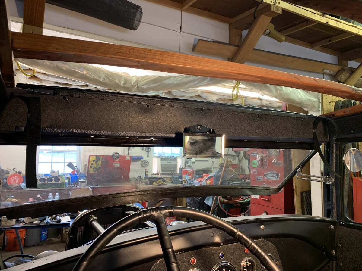

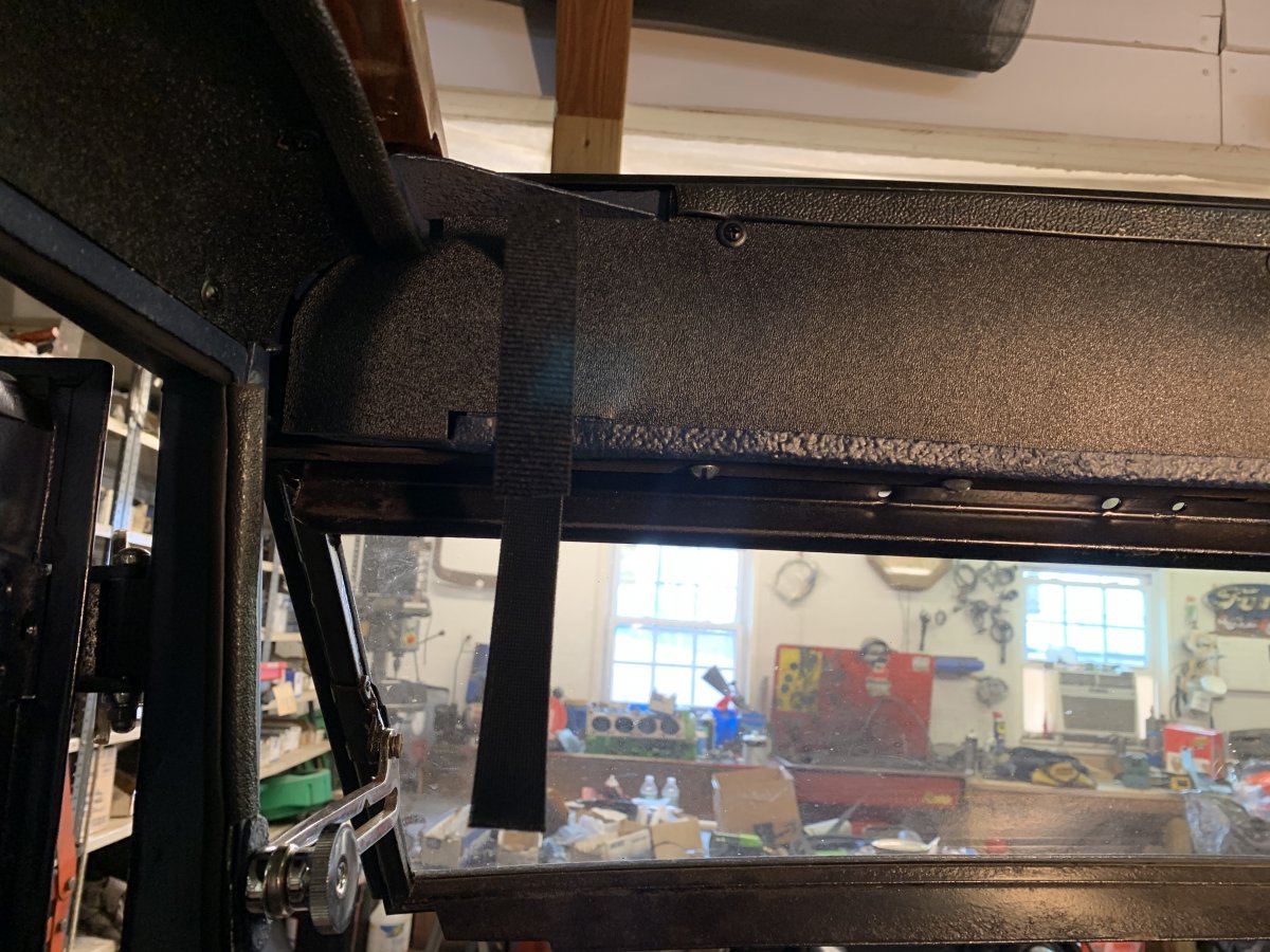

    OK, rear panel was tough because of the size and the cutout for the window trim, as with the side window trim.
    I made pieces for above the doors and above the header. I added a couple Velcro straps above the windshield so I could remove the top and roll it up and stow it away safely.
    The plastic has a mind of its own on curved surfaces but all in all worked great.
    Cliff Ramsdell
    IMG_3829.JPG IMG_3830.JPG IMG_3831.JPG IMG_3836.JPG IMG_3838.JPG IMG_3839.JPG IMG_3840.JPG IMG_3841.JPG IMG_3842.JPG IMG_3843.JPG

  9. An electric heat gun will work better than that torch....
    Jason Mitchell, loudbang and Tim like this.
  10. Deadbird
    Joined: Jul 28, 2005
    Posts: 1,189
    Deadbird
    That's what I was about to suggest.
  11. brEad
    Joined: Dec 23, 2016
    Posts: 2,039
    brEad
    Great idea for storing your top!
    loudbang and Cliff Ramsdell like this.

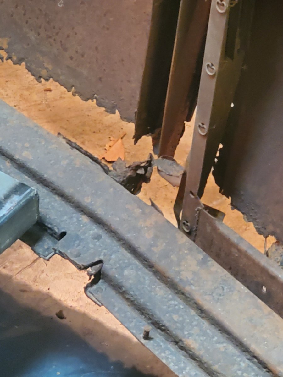

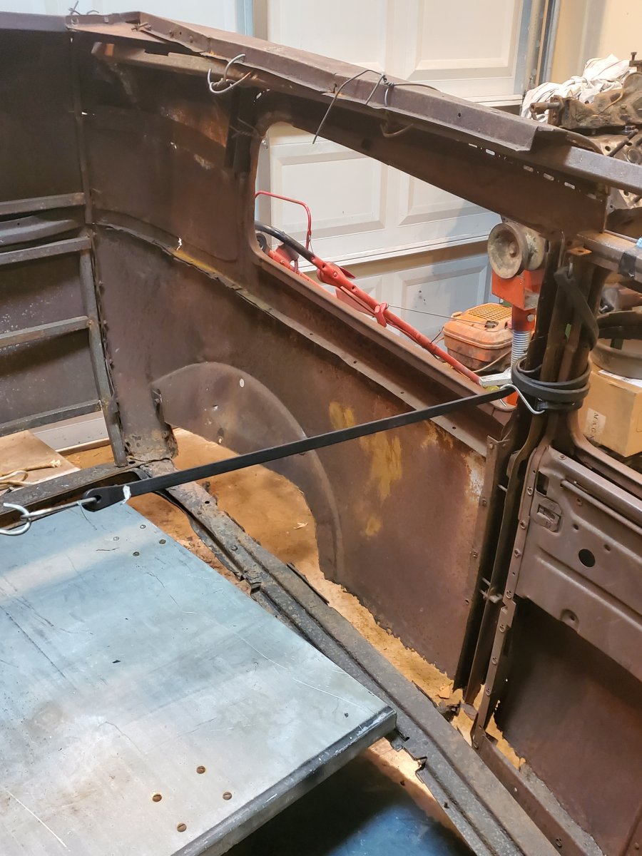

    Do you have any pictures of the B and C pillars where they connect to the lower rail of the body? Mine are so badly deteriorated that it's difficult to tell what they looked like. I will be fabricating new ones, or at least the bottom 4-6" pretty soon.

    @Jason Mitchell let me look through my body picture folder and see what I have. My body was pretty decent and only had minimal rot repair.

    That would be great. This is what I am working with. Also, the drivers side C pillar is missing as well as both of the t****zoidal pieces that contain the rear window regulators.So I have a scavenger hunt ahead. The wife of the guy I got it from wanted to stick it in the front yard and plant flowers in it. Im not so sure that wasn't a bad idea. 20200726_135508.jpg 20200726_135515.jpg

    @Jason Mitchell I looked through what I had for pics. Didn't take any, guessing it was because it wasn't that bad, sorry I didn't have more to offer. '
