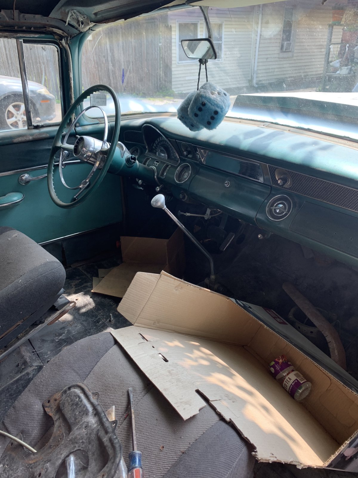

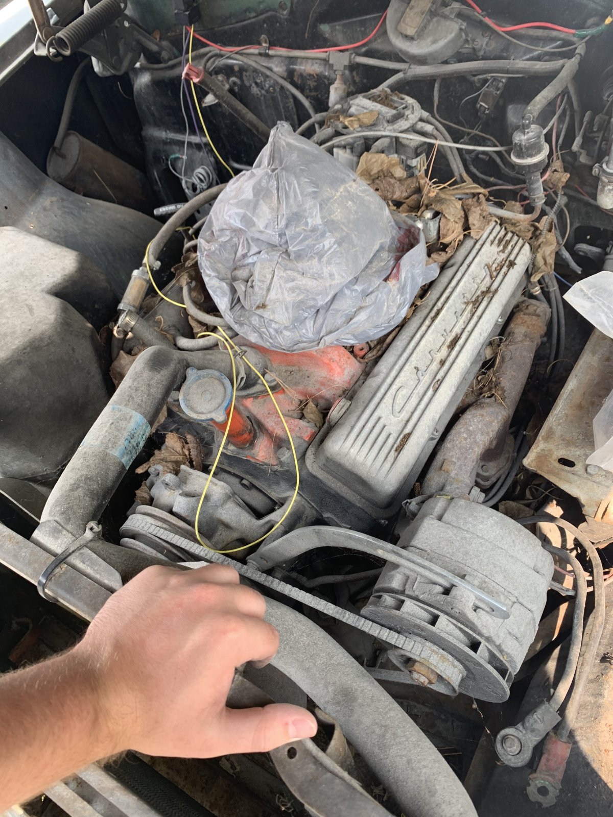

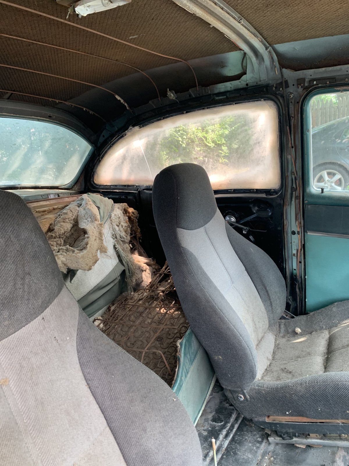

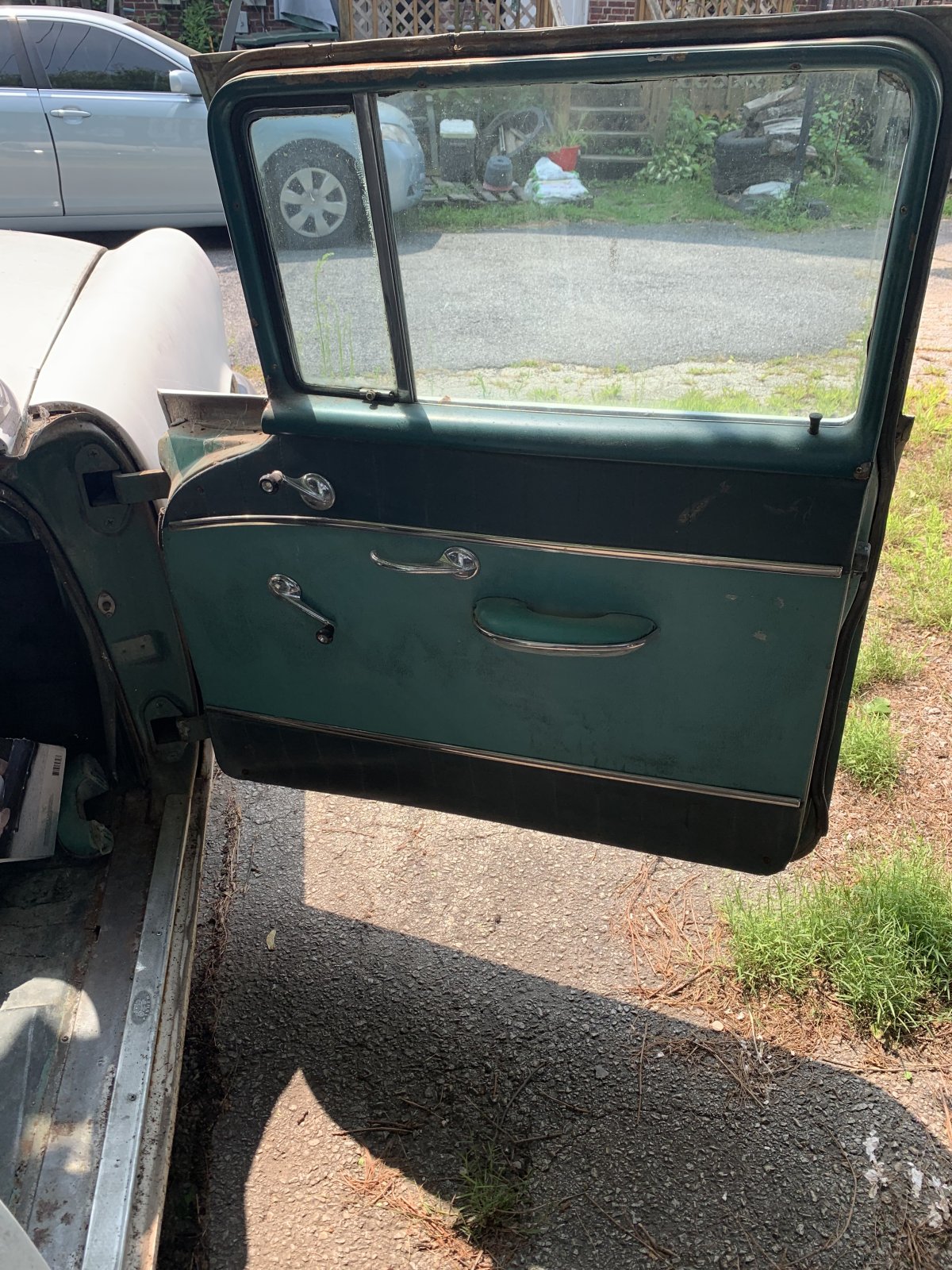

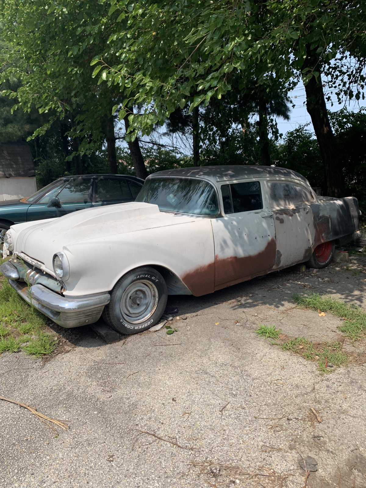

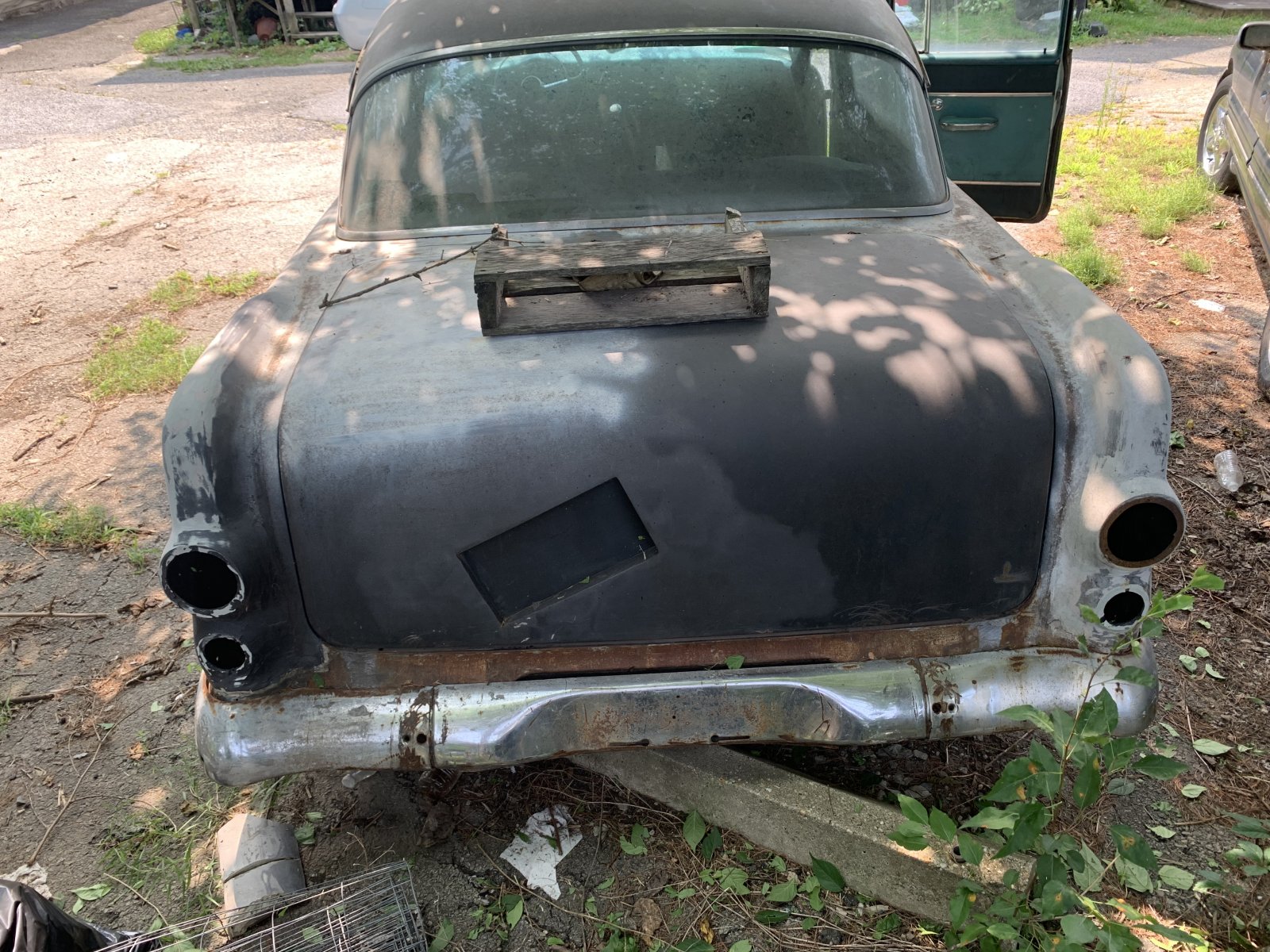

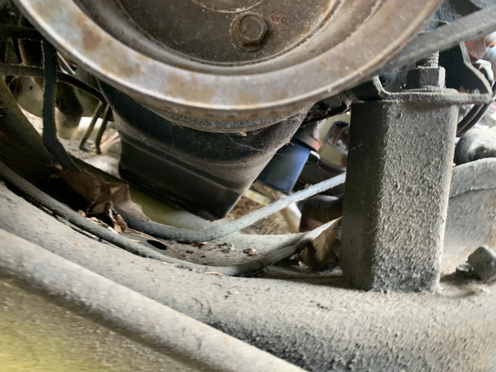

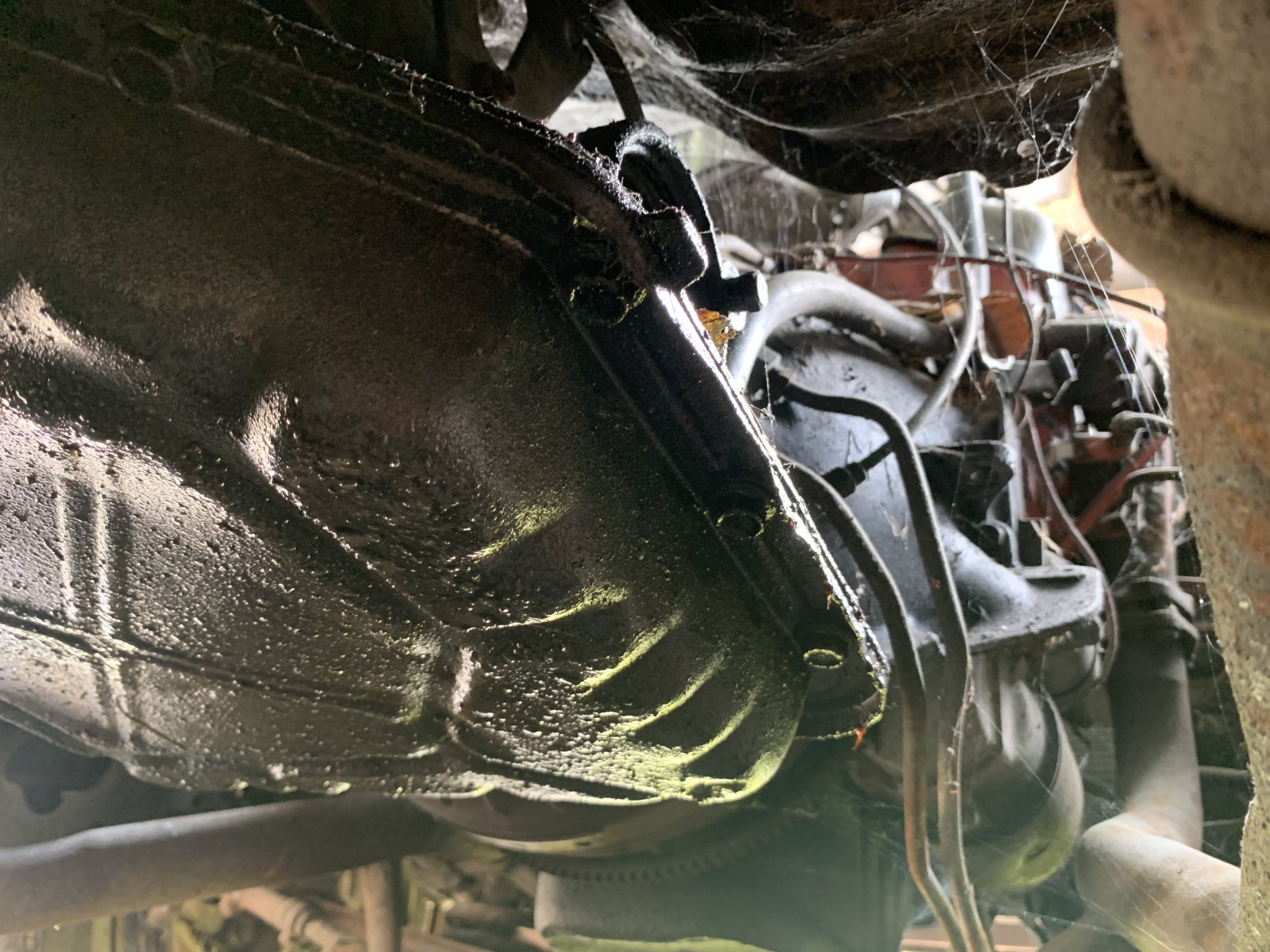

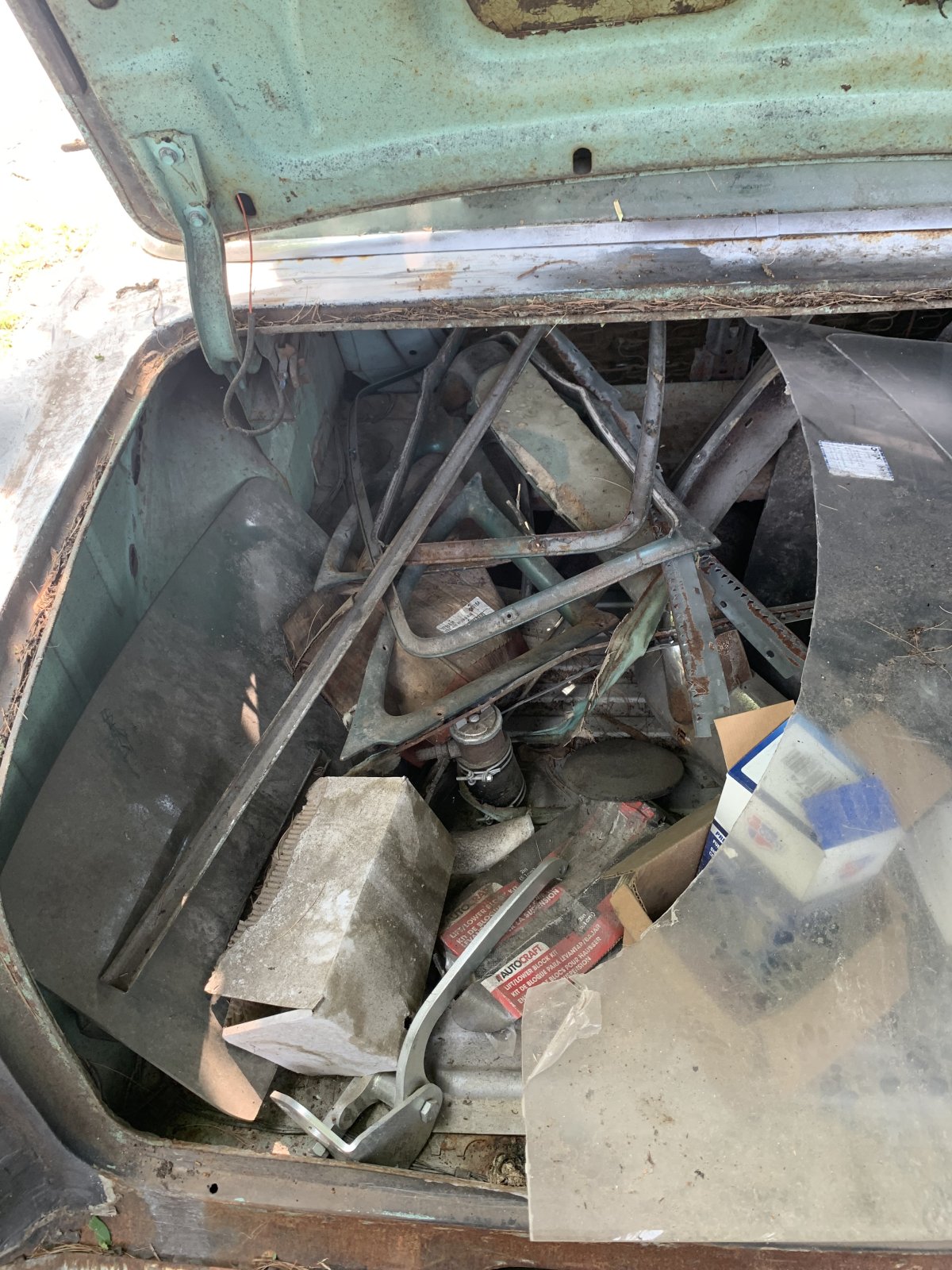

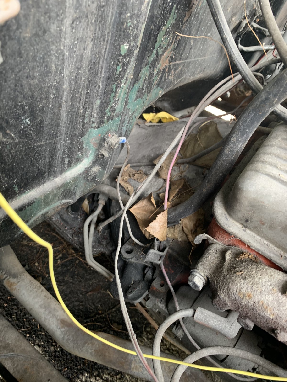

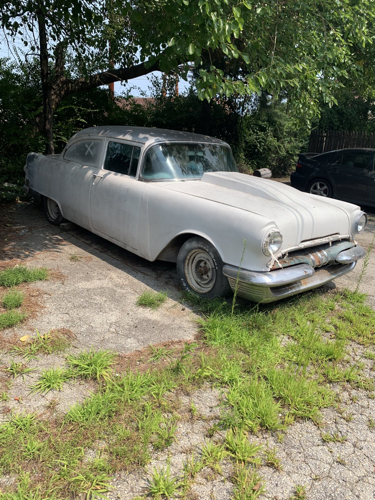

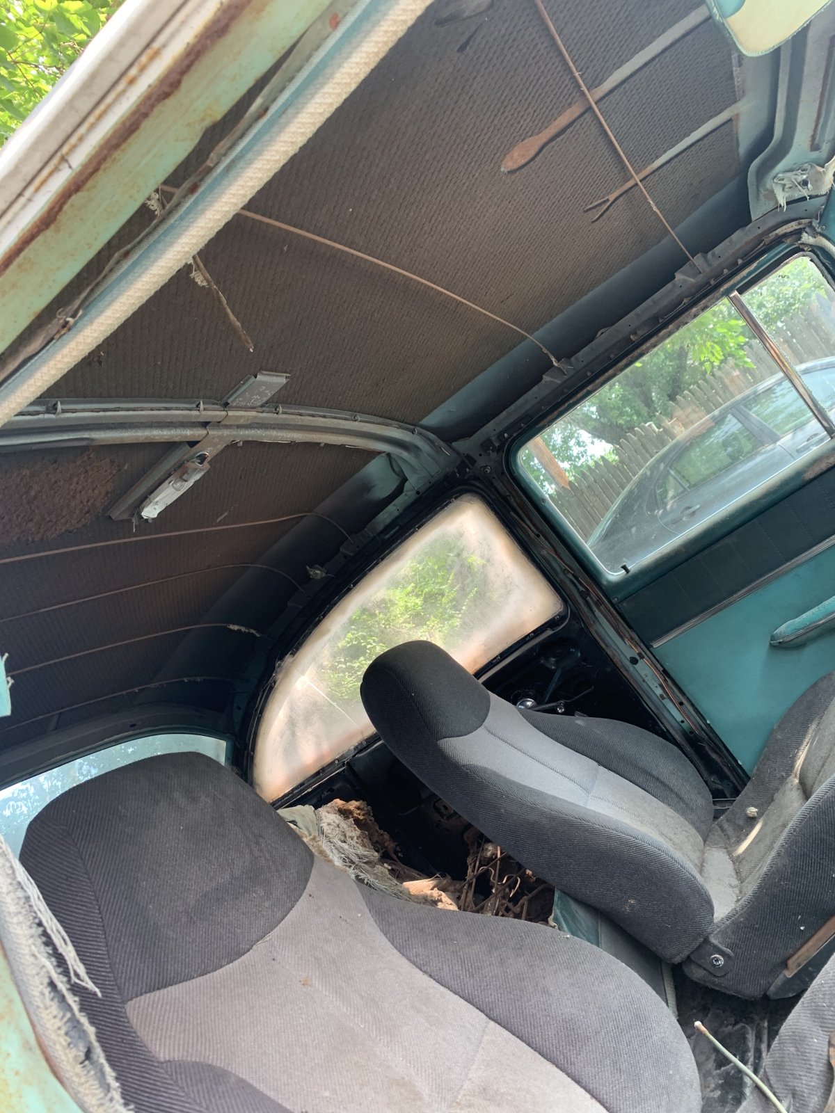

    I’m new on the HAMB been looking at threads for a couple years names jeremy. I got a 55 poncho 2 years ago for $2,500 has a small block Chevy in it. Was covered in bondo, has a 56 Chevy rear bumper welded to it. Has most of the interior gone and Miss match pieces of body trim. Was born a 4 door and now it’s a welded up two door. I had to put in plexigl*** windows. The owners before the one I got it from were trying to make it into a 2 door 56 chevy or something for whatever reason. The guy I got it from was “Trying to make it a rat rod”and took the original paint off layered bondo on it and painted it matte black. I just wanted to make an account and let you know you can definitely grab a small block and a trans and get it hooked up in your car. They welded in engine mounts for the small block that’s in mine and I’m not sure what the trans is but I have some pictures for you so You can see. I haven’t done much to it besides try to get The body work lookin better and get as much filler off where I can to see what I’m workin with. I’m sure mine isn’t as nice as yours but I just plan to make mine go fast in the future it’s never gonna be a stock ride.
