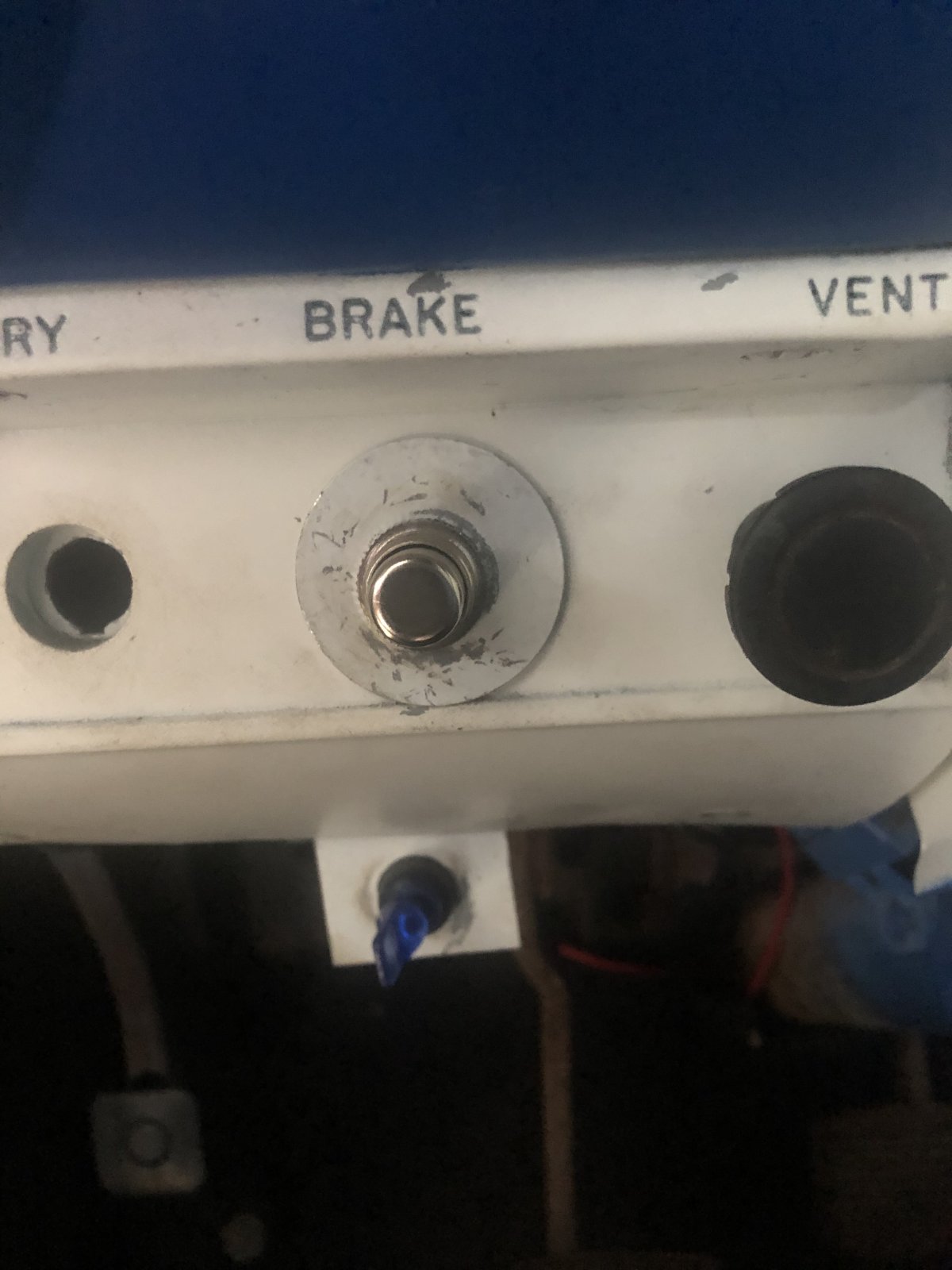

  18. 57Buick
    Joined: Dec 2, 2013
    Posts: 198
    57Buick
    from Alabama
    710C373C-84C1-4B7D-8E6A-3451236D7664.jpeg 101A7D19-83F2-46FC-9946-82F8241269B8.png 8D6C3290-E592-4273-86EA-0E0248DB03C3.jpeg

    By your pictures, the way you have the resister wired in, its not doing anything for you. That resister has to be between the power source and the coil, it appears you have it looped from the coil, through the resister, then back to the coil. Other than removing the resister and the added wire, I would hesitate making suggestions until I knew how the push ****on and the switch are wired. I would not want to advise you incorrectly.
    I suspect if one of those guys close to you can meet up and give you some guidance, you will be a happy camper. I wouldn't be too concerned about a rebuilt motor until you have some running time on the one you have, and then have a chance to drive the car a bit.
    In the mean time, I think I would work towards getting the gas tank cleaned, and new fuel lines in place, and a couple gallons of fresh gas, so once you get it running, it can run a while. Might also check to be sure the motor, the radiator and the radiator hoses can hold water, and the fan belts actually turn the water pump too. Those things would be important for running the motor more then just a few minutes.

    It's hard to tell what all is going on. I'm ***uming that that was just temporary to run the car.
    Do you still have the factory ignition switch?
    Does the dash harness still exist?
    Are you running out of the factory gas tank?
    In your opinion, is it possible to go back to the factory keyed switch? Some wires may need to be replaced but is any of that left?
